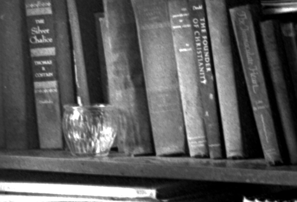

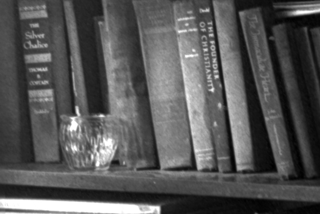

I think my latest scans are too smooth, but not sharp enough, which is probably saying the same thing two different ways. Either way, IMHO, there's not a nickel's worth of difference between these two developers. I'm not so concerned about the what as the why. It is generally accepted, I think, that the grain comes about differently in sulfite developers than in ascorbate ones. I think the difference here is not borax vs sulfite, but ascorbate vs sulfite.
In the samples, the large book 2nd to the right of the center, you can see text on the spine from the Microdol developer but not the experiment. You can almost read the text. This can be either contrast, sharpness or both! These are some of the elements that should be resolved in a test case like this.
A scan of the negative should be better than a scan of the print.
PE
I think I chose the wrong part of the bookcase. That book's spine is hardly readable from a foot away with my best reading glasses hanging on my nose. If we were testing color film, we might have a chance. None of the text on that spine is any smaller than that on "The Silver Chalice", but the color contrast is not suitable for BW film. A color-blind person could not read most of the titles on that part of the shelf.
I can tell no difference on my screen between the images of that book.
I can see text in the Microdol sample, but not quite read it. I can see just vague markings on the other sample. Of course Costain's book is quite readable. BTW, I have a copy as well.
PE
I find the Microdol has a bit more information too. Murry's scan manipulations match contrast pretty well, and the Microdol is definitely better there for me.
First you tell me a direct scan of the negative might show better what you want to see. I do the direct scan and present it, whereupon you refer to the scan of the enlarged analog print, doctored by Murray, to show what you want to see. I suggest you mix up a liter of the Phenidone-ascorbic acid-borax formula and compare it for yourself with whatever you want. My scanner is not what I would trust to resolve the grain directly and too much tinkering with contrast is required for the indirect comparison involving an analog print.
Now let us ply this game a bit differently. I will present two different images, each from direct scan of negative, and you tell me which is better.
It's hard to scan negs well. I think I would try from the prints.
I was a bit apprehensive that Patrick might be upset I adjusted the contrast and re-present his results. I was mindful of PE's comment somewhere, that contrast affected apparent sharpness and kept that in mind as I did it.
I would have put my money on the PCBorax initially but with the levels equaled to the best I could with that program, it seemed the other way around - Microdol-X substitute had a teensy bit more apparent sharpness.
But, as Pat says, we're looking at detail in 3x5 feet enlargements of HP5+ from 35mm film!.
I'm amazed at both developers. I have mentioned the PCBorax to several people since I tried it some months ago (probably nearer a year) and now I know it's as good as I remembered it.
Nice going, Patrick.
Murray
