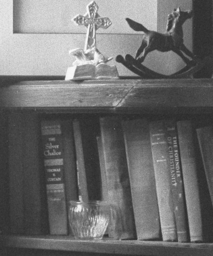

I will say that the grain from Arista 400 Supreme in a super B digital print made from a scan of a darkroom 8x10 print is not visible at 12" viewing distance. Resolution is as good as the 50 mm Canon 1.8 lens provides. I used 0.5 f-stop exposure bracketting with my test rolls and could see very little difference in exposure scale from one shot to the next when each frame was of normal contrast.
I'm going to try to illustrate some of this by a photograph in my next post.
gainer
Sep 20, 2002
3,703
Sharpness, grain, gradation of SPF-3 PCB
These have had no digital modification except cropping.
