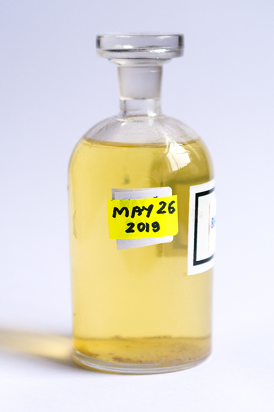

After 3 years there is no significant change in the appearance of the fully closed bottle (pic).

After 4 years there is no visible change. Maybe next year I will test the activity of the contents of this bottle vs a freshly made up solution given in post 1 and pictured in post 20.
If there has been no change I will suggest that the reaction supporting the decomposition of metol is supported by trace metal ions, of which there were none.

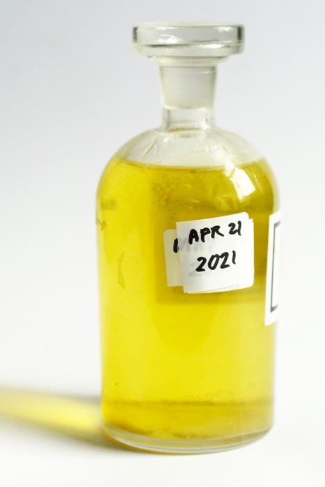

This test was concluded after very nearly 5 years.
The color of the developer in the sealed bottle remained virtually the same (pic)

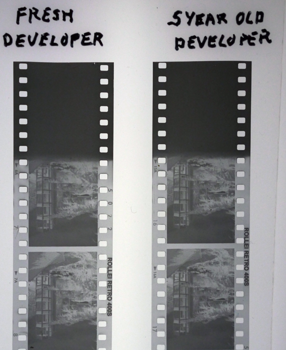

A test film was developed for the same time (20min 20C) in a sample from the sealed bottle and in fresh developer prepared to the same formula (post 1).
There was no visibly detectable difference in density between results from developer aged 5 years and fresh developer (pic).
Conclusion- metol was not significantly hydrolysed after 5 years at this solution pH.The test does not detect very small changes.
