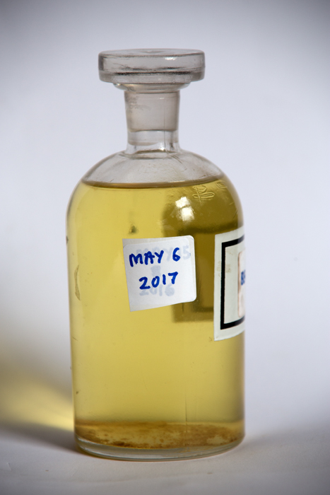

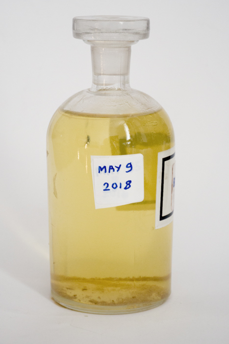

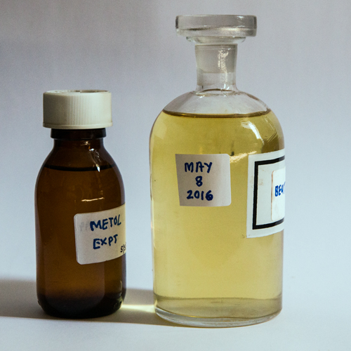

Observations after I year of storage at 60-80F:
Small bottle- the contents smell of amine. Diluted 1:50 it blackens a film leader in 10 min 20C.
It is now topped up with Protectan and re-sealed.
Large bottle - not opened. Virtually the same color as last year (pic)
Conclusions:
I cannot detect small differences that might exist.
There is some indication that metol might not hydrolyze from Gerald Koch's Kalogen developer, now several years old, and from my testing of old ampoules of Neofin Blue, which still worked.
Neither of these is conclusive as other developing agents that might regenerate the metol are also in these developers.
The improbable formulae I posted above seem doubtful now. In case there is some hydrolysis I would now suggest the metol reduces sodium sulfite to sodium bisulfite and forms a metol oxide.
I will let the experiment run.

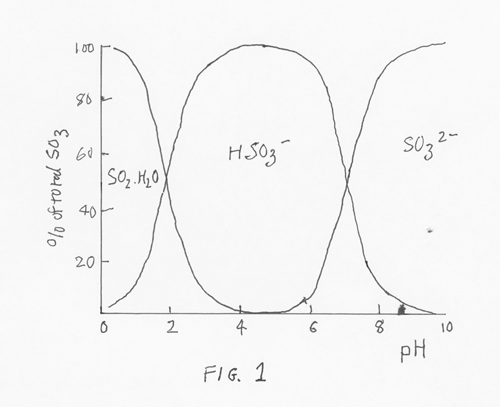

Some theory, after 2 1/2 years.
Could metol be reduced by sodium bisulfite present in small amount in sulfite solution at this pH ~14?
From Fig 1 (Ref 1) there is very little bisulfite present at this pH
From Fig 2 (Ref 2,3) the redox potential of sulfite is much less than that of metol, so in theory bisulfite could reduce metol.
Measured potentials for metol developers in sulfite solution (Ref 4, table 4) when converted from Esce to Eh are very close to those given for metol in fig 2.
So in theory, if the reaction occurs at all it must be slow otherwise the potentials in sulfite solution would be shifted downwards from the metol line.
So this theory only shows the reaction is possible but too slow to detect.
Will have to await practical results.Comments welcome.

No idea how Sulfite should reduce Metol. The EH curve you plotted is for the Metol <===> MetolOX reaction. MetolOX will react with Sulfite to form a Sulfonate.
The Eh - pH diagram is the best I could find for bisulfite . It is proposed that bisulfite could theoretically reduce metol. .The bisulfite would be oxidized to sulfite.
The sulfites Eh is clearly lower than that of metol so a reduction is theoretically possible.
The actual chemistry of it is outside the scope of Eh - pH diagrams.
