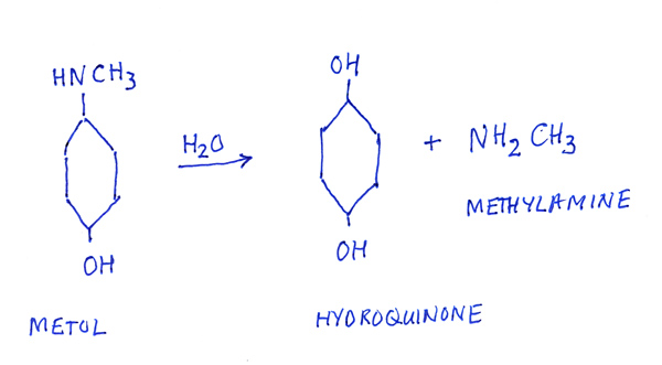

It's not really known why old metol based developers don't last indefinitely.
It might be because the metol reacts with OH ions from the water (hydrolysis) giving hydroquinone and methylamine as in the attachment.(I left out the sulfite for simplicity, they are likely further sulfonated from the intermediate step shown.)
In my experiment I hope to detect the intermediate step from the smell of methylamine.

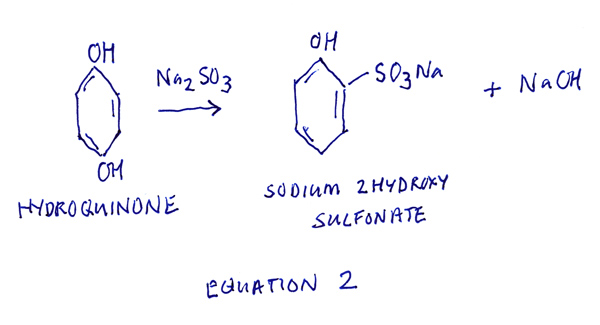

The usual path leaves an OH in the 4 position making HQ Mono Sulfonate, which is a poor developer under some conditions.

As PE points out the equation given is incorrect. What would be formed is hydroquinone monosulfonate. You do not lose a OH- group but add a HSO4- group at one of the available positions on the ring. This only happens when hydroquinone is oxidized. Hydroquinone monosulfonate is a weak developing agent. It is produced in D-76 replenished systems. Kodak used it in starter solutions for various B&W developers. It is also used in one or more developers for microfilm in order to produce normal contrast.
All 4 open positions on the ring are equivalent due to the symmetry of the hydroquinone molecule. However the naming convention requires that the lowest position number be used which would be 2. Therefore the name 2-sulfonyl hydroquinone.

You should get 2 Sulfonyl, HQ though, with 2 OH groups at 1 and 4 and the SO3- Na+ at the 2 position as shown by Haist and Mees.

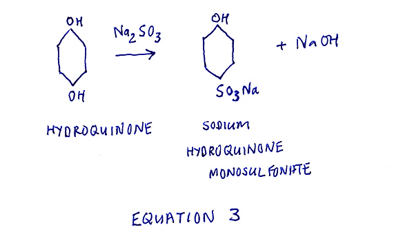

I think Gerald and PE are referring to the sulfonation in presence of oxygen, Mees &James 3rd ed p 289.
I am referring to anaerobic conditions , I don't think this case is published but I don't have Haist.
The point of my equation 3 is merely to show that an equation can be balanced so the anerobic reaction of HQ is not theoretically impossible.
The problem is that in a closed system such as is described there is nothing to drive the reaction. You would need a way of removing the OH- ions. Just because an equation can be balanced does not mean that it occurs. It is better to work with the two half reactions using electrons e-, H+ and OH- ions to balance each half reaction.

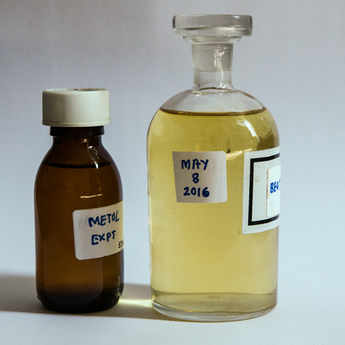

Here are two bottles of the solution from post 1 at the start of the experiment. They will be kept in a dark cupboard at room temperature.
The small 100ml bottle will be used for any intermediate tests.
The large 270ml reagent bottle has its ground glass stopper sealed with Vaseline to prevent any ingress of air.

From an organic chemistry point of view the nucleophilic substitution of the methylamino substituent by OH- seems quite unlikely.
para-aminophenols are known to be very unstable in the presence of oxygen. What you seen is in my opinion just the oxidation to the aza-analog quinone.

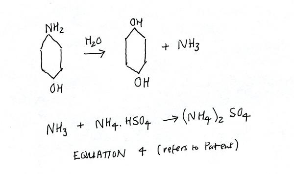

I quote from the paper. "hydroquinone is made by the ammonium bisulfate hydrolysis of paminophenol. The p-aminophenol is contacted with 1.2-12 moles of ammonium bisulfate per mole of paminophenol in an aqueous solution at a temperature of about 200-300 C. for a time sufficient to hydrolyze the p-aminophenol to the corresponding hydroquinone." It also goes on to state the composition of the hydrolysation medium must contain ammonium bisulfate. None of these conditions are present in the proposed experiment, pH, ammonium bisulfate, temperature, unsubstituted paraminophenol, ... For substituted aromatic compounds the groups present on the ring effect the reaction. Substitution on the nitrogen can either push electron charge into the ring or put it out.
Alan Johnson
Nov 16, 2004
3,277
I daresay the patent relies on the bisulfite -> sulfite reaction to remove the product of the first reaction, which reaction (attachment) may be similar to that in my post 1.
I don't yet have an explanation for how the methylamine would get removed in the case of the hydrolysis (or not) under investigation.
So I agree the patent bisulfate process is different but it is as close as other literature gets.

If this reaction relies on Bisulfate to Sulfate conversion (BTW: Alan, note, it's Bisulfate/Sulfate, not Bisulfite/Sulfite), and if the composition given in this patent is somewhat representative, then it seems to happen mostly in crazy acidic environment, very unlike our photographic developers.
