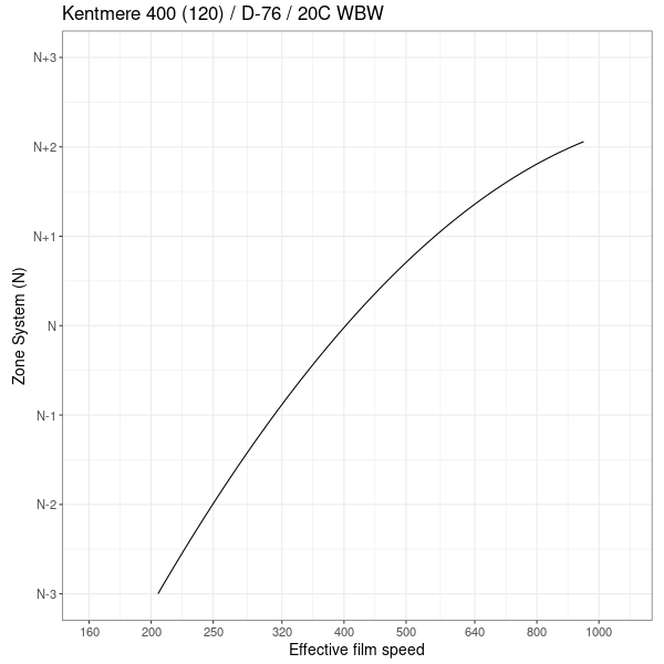

I made a plot that I want to share and ask your opinion. I was trying to come up with an "N versus EI" kind of plot based on the Way Beyond Monochrome method. The film's normal speed is determined in a separate test. Then, individual curve EI values are obtained for the Zone System N-number series (N-2, N-1, N, N+1, N+2). It's a very useful view of the data. Having said that, when I first read the chapter, I was confused as to where the data came from.

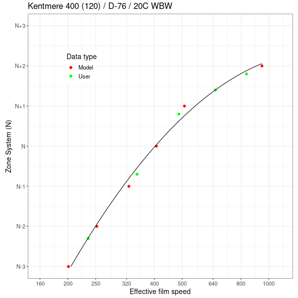

I think that this plot could be augmented by showing the actual N-numbers and EFS values for each curve in the family (green dots). This is possible because, in my test, film speeds are determined directly from the curve family. It's a slightly different approach. Is it useful to see both types of data points or am I complicating the issue?
Or maybe showing the data points is unnecessary? How about just plotting a curve that fits the data?

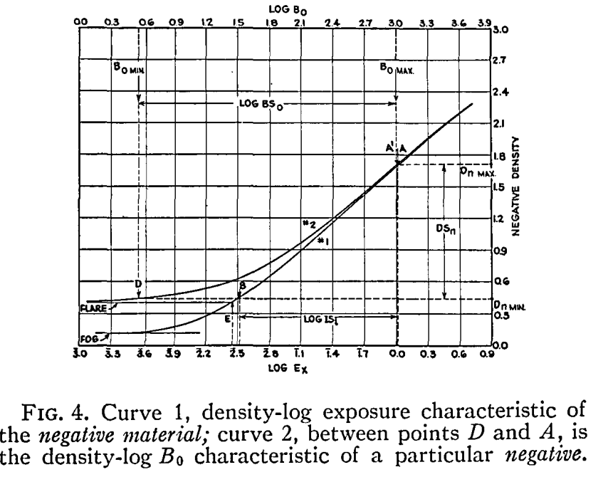

As I was reading Way Beyond Monochrome again, I couldn't help but wonder about their proposed method of film testing involving photographing a step tablet on a light table with a macro lens or suitable bellows extension. It is a departure from a standard way of exposing film for sensitometric analysis by means of a sensitometer. One of the factors that varies across these two methods is the presence of flare. This made me think of the Jones and Condit (1941) paper.
It reminded me of the distinction that Jones and Condit make ( Loyd A. Jones and H. R. Condit, "The Brightness Scale of Exterior Scenes and the Computation of Correct Photographic Exposure*," J. Opt. Soc. Am. 31, 651-678 (1941)) between "negative material" (henceforth curve 1) and a "particular negative" (henceforth curve 2). They made it very clear that "If for any purpose it is desired to determine the magnitude of a negative density difference, delta Dn, corresponding to some object brightness difference, delta log Bo, curve 2 must be used. Thus, in dealing with tone reproduction problems which involve a consideration of gradients, curve 2 gives the desired information."
In that particular paper, the authors referred to the object as "Bo" or "brightness scale of the object" but, the term "object luminance" was also used, particularly, in later work. Curve 2 is derived by incorporating a flare factor, which is defined as the ratio of the brightness scale of the object to the illumination scale of the
image. In the classic tone reproduction theory, the more common representation of flare light is as a plot of log subject luminance to log image luminance, but in the paper above, we have both scene and image luminance plotted against negative density, i.e., a characteristic curve. This can be somewhat confusing, but I am just going to leave it at that, as, otherwise, I'd need to write a few paragraphs, and, besides, most of you already know this stuff really well.
What I do want to focus on is the fact that the proposed method for deriving curve 2 is rather involved. First of all, you need to know the actual brightness scale of the object, including the exact minimum and maximum values, which are related to the minimum and maximum negative densities related to that scene. You also need to, separately, expose a step tablet in a sensitometer, i.e., without flare, and plot it using the actual, rather than relative, exposure values. To derive curve 2, you also need to construct a separate log Bo scale (along the top of the plot in Fig. 4), and then measure displacement calculated from the brightness and flare information. It can be done, but it's rather tedious.
An alternative approach is to use the notion of flare light as "flare density," as suggested by Dorst ( Paul W. Dorst, "A Novel Graphical System for Representing Tone Reproduction Data," J. Opt. Soc. Am. 34, 597-600 (1944)) and others. The advantage of this approach is that you do not need to know the object brightness scale before the value of image density corresponding to any intermediate value of object density can be computed. In other words, it is possible to construct curve 2, without the complicated method proposed by Jones and Condit. You can even do it without knowing actual exposure values, by just using a relative LogE scale. That way, we can simulate a characteristic curve of the "particular negative" and compare it to the curve of the "negative material" rather simply. In my attempt to implement these two methods computationally, I obtained very similar results. They are not identical, and you can, of course, criticize the "flare density" model as not being "correct" but this might be a compromise that is worth making, particularly for the sake of simplicity. The chief distinction is that the "curve density" method is more of a simulation, whereas the "curve factor" method obtains actual measurements of parameters related to the negative in question. Since Jones and Condit tried to produce a large body of empirical data of actual scenes and actual negatives and prints, they, obviously, had to use the flare factor approach.

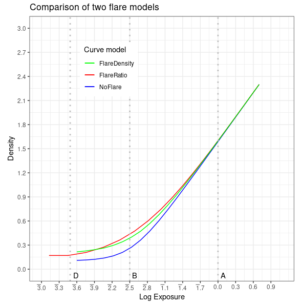

I synthesized a curve 1 (blue) to be similar to that in Fig. 4 above to make the comparison easier. I then used a flare ratio algorithm to derive curve 2 (red) and a flare density model to derive another curve 2 (green). Because the flare ratio method uses separation, the resulting curve 2 (red) becomes asymptotic past the point representing an object of zero brightness. The flare density curve 2, on the other hand, extends only as far as curve 1.
My point is not to argue that one model is better than the other. I am simply trying to find the simplest, but still reasonably accurate, method of deriving curve 2 for the purpose of analyzing gradients and simulating the mapping of negative density onto object brightness. I am curious to see what you guys think of these methods and how they compare. I am also curious to hear whether this type of analysis (i.e., curve 1 vs curve 2) is useful for ordinary film testing?
