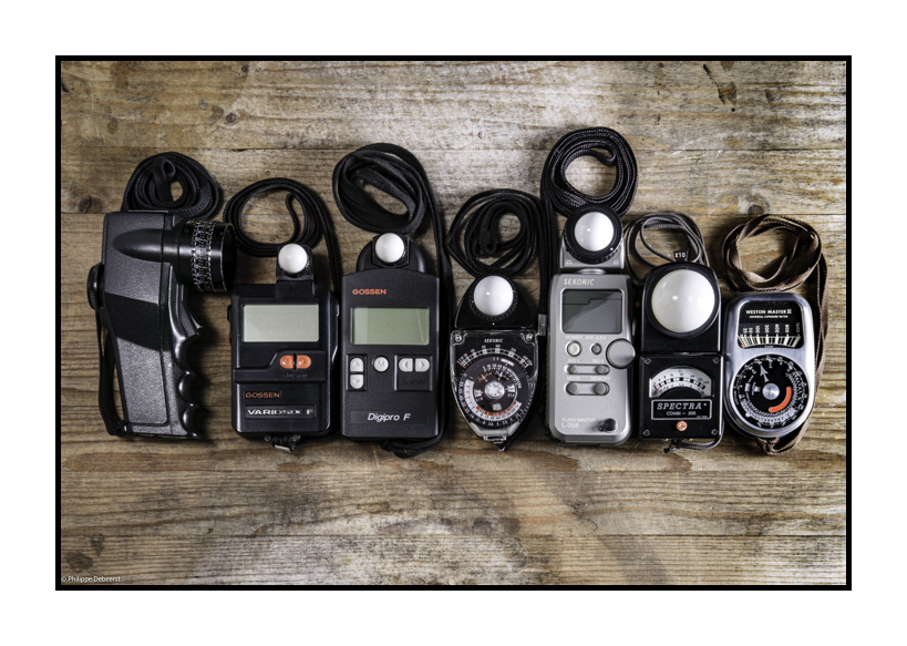

It depends on how I feel, the camera I am shooting with and the subject...
The Sekonic L-358 is gone now, there are some issues with the Gossen Variosix F (bad contact with the +5 diffusor dome) and the Spectra is the most complex to use (but the sexiest)...
The Pentax Digital Spot meter and the Gossen Digipro F are the favourites now.

Studio Deluxe users might disagree, although I confess that Spectra is pretty hot. Complex, how?
The need of the different slides, more than the Sekonic (only one), whether or not to use the batteries for low light and above all the reeding wheel with the different pointers on the back, makes it rather complex shooting handheld on the go (sous bois where I dropped one of the slides and couldn't find it anymore).
But sometimes that complexity is worth it, particular for (large-) architectural interiors where you can walk around and measuring the different incidents of light, while the camera is standing on a tripod.
Anyway, I keep it in the leather case, attached ton my bag, when I go out shooting ruins, churches or castles.
I hope never to drop that meter, it is so vulnerable...
Very nice collection!
