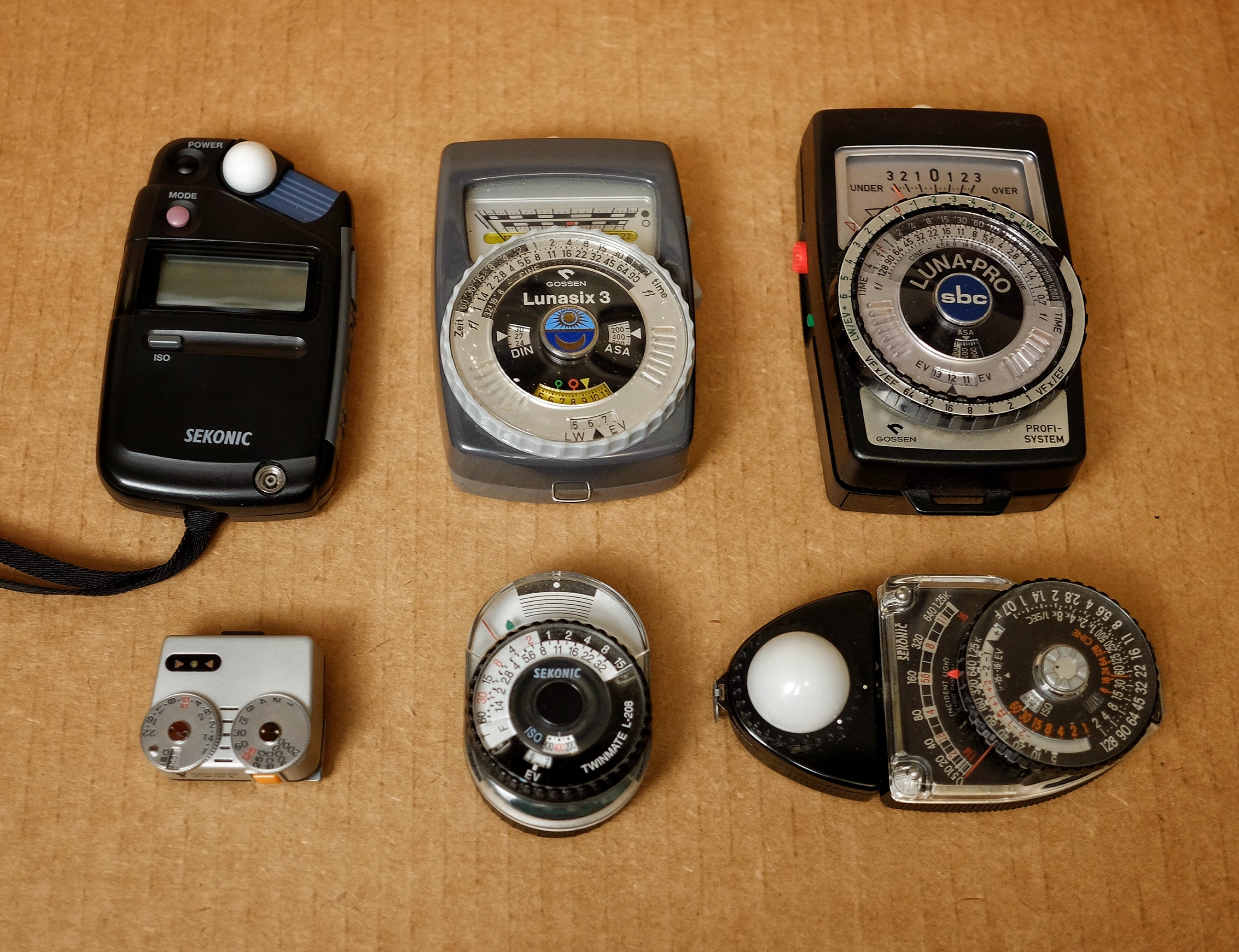

As I've said, I have a thing for meters. The 308 is the only one that can measure flash. The SBC with its big analogue dial is best in low light and the easiest to read. The little CV Meter ll can fit nicely on a camera's accessory shoe. I guess those 3 are my favourites for those reasons.

This picture is really helpful in comparing the sizes of the meters. I've only handled the 308. I am assuming the Luna Pro SBC is a lot thicker than anything else.
The LunaSix 3 is a bit thinner than the SBC, but not a lot thinner.
Yes. It's the thickest of the meters.
Keep in mind that the angle of the shot makes the meters in the front row appear larger relative to the back row meters than they actually are.

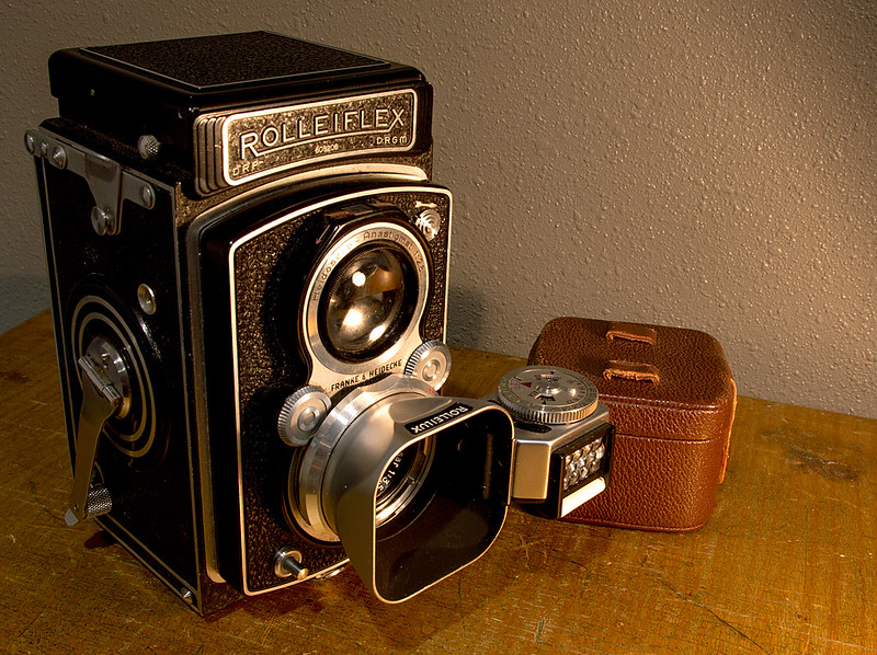

My meter of choice for Bay 1 cameras. It kills two birds with one stone.
