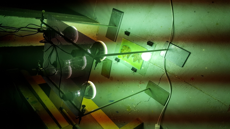

Base: "Perforated Plate" (Lochblech) made out of steel or aluminium
https://www.amazon.de/Lochblech-Aluminium-Zuschnitt-individuell-günstig/dp/B077LZS83J/ref=sr_1_6?__mk_de_DE=ÅMÅŽÕÑ&keywords=lochblech&qid=1562216680&s=gateway&sr=8-6
As lamp holder I used 5 x sera reptil ceramic holder https://www.sera.de/de/produkt/terrarium/sera-reptil-ceramic-holder/ but it was not easy to cut the big holes, because the base was steel.
Better way would be to use sockets like these: Trixie 76105 Porzellanfassung Pro Socket https://www.amazon.de/Trixie-76105-Porzellanfassung-Pro-Socket/dp/B003OAGDHC they can be installed at the back, so the holes can be smaller.
Picture of that device:
Two steel rods and four lab stands are used for holding
Edit: The shadows at the picture where artifacts, from the 50 Hz frequency in the digital camera....they where moving at different pictures.
