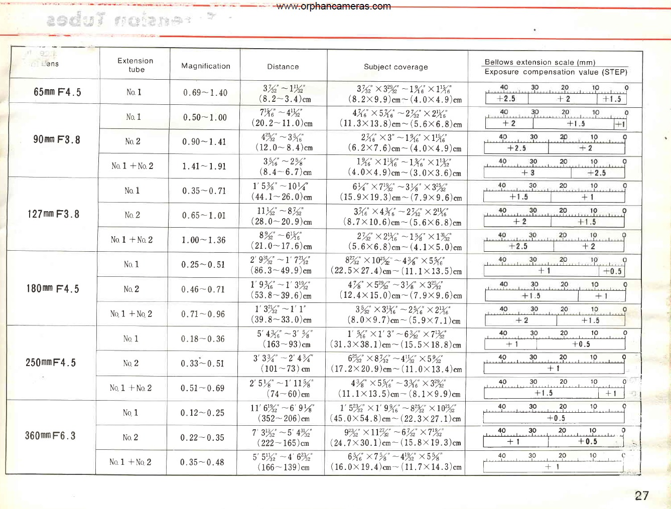

1. Here's details on macro shots with just the various lenses.
Here are the crop values for each lens with the two extension tubes.

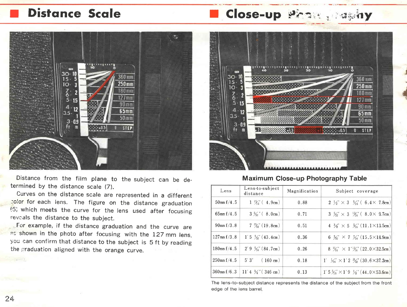

2. Here is a picture flow diagram of all the various accessories lenses etc. It's for the RB67, not the RZ.
