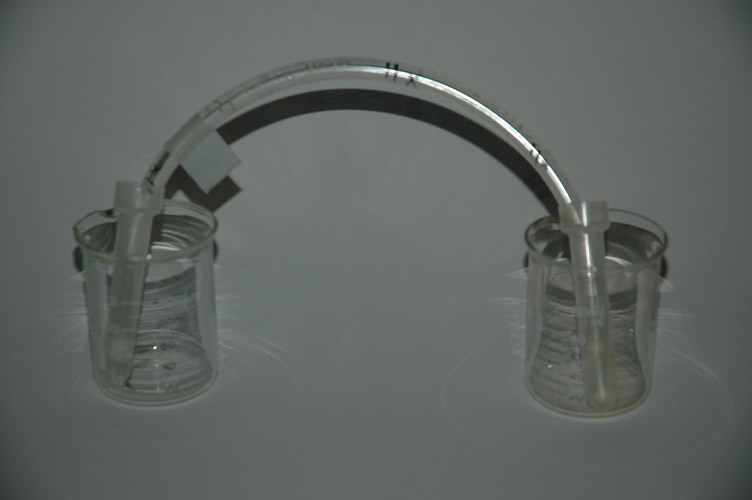

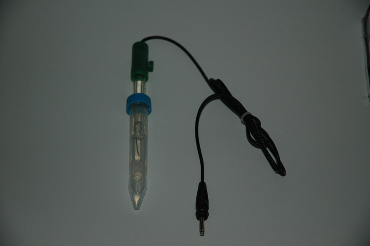

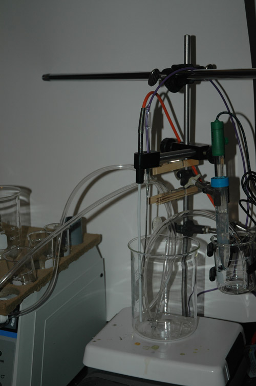

I am now at the point of being able to replicate results to within about +/- 5 mv, but with a slope adjustment as the solution becomes more dilute. I am working on that. It may be due to having immersed too little of the billet in the electrolyte.
Here are photos of the reference electrode, the billet, the bridge and a trial setup of a beaker ready for precipitation of a real emulsion. The reference electrode is immersed in its conditioning/storage solution, and the bridge is also immersed in its own gel/salt storage solution. The bridge is marked as to polarity and the salt that it is to be used with. These are two critical items in this measurement.
The making beaker in the 4th picture contains 2 inlet lines for salt and Silver, a temperature probe, the plated Silver billet, and the bridge. The bridge is a mockup in this but not in the other picture. The bridge is connected to the salt solution beaker on the far right which contains the reference electrode.
The pump is partially seen to the far left.
Both electrodes are connected to the VOM. It is then connected to a PC with a cable and data logging can be carried out as a function of time.
In the first photo - the one of the reference electrode - it looks like you have the ref electrode in it's storage tube, right?
I like how you can see the coating/plating on the silver electrode, that's good to know as it should help determine how much plating has occured.
The last photo is getting pretty crowded with tubes... Make sure you leave room for the stir bar! ;^)
Also, you're not seeing any interference from using a magnetic stirrer, right?
Yes, I keep my reference electrode in the storage solution at all times. I actually store the Silver electrode in distilled water, and the bridge is stored in electrolyte gel.
I could not get the stir bar in. :wink: Actually, I may need a prop mixer.
There has been no apparent effect from magnetic stirring at all. That does not mean that I will never see it, but so far nothing. If there were to be an effect, i guess I would go to shielded cables.

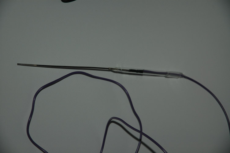

I was thinking about your silver electrode and how you sealed it... are you using glass at both ends?
How do you seal the plastic coated cable end?
Ray
The glass tube is sealed with epoxy with the cable to Silver junction inside of the tubing. That is the reason for the sealed glass, to protect the junction from corrosion and metal contamination. No moisture should enter the tube nor should it touch the Silver to wire junction. The other end is self sealed in the banana plug shround, and is 3' away from any contamination.
PE
Ray - one the silver electrode I made for I took a couple inches of the 12 ga., 99.99% silver wire mentioned above and soldered it to the lead wire of a shielded video cable with a BNC connector on the other end. (The cable is from Radio Shack - I simple cut one end of the cable and set aside the unused half). I mounted it inside a 6mm diameter, 6 inch long pyrex glass tube by stripping back some of the shielding and the outer part of the video cable and slid the end with the silver wire soldered on to it into the pyrex tube.
I had hoped to have the shielding on the cable all they way to just a bit above the solder joint, but a 6 mm tube was too small in the inside diameter for it to fit. By removing some of the shielding, I was able to slide the silver wire and the teflon insulation around the lead wire into the glass tube.
I plan on getting some larger glass tubing - either 8 or 9 mm diameter so I can get the BNC video cable inside without having to remove the shielding, or perhaps 12 mm diameter so it's the same diameter as a pH meter so it fits into a standard pH electrode stand. Also, instead of cutting the 6 foot BNC cable in half, I'll simply snip on BNC connector off so I can use the full 6 ft of lead on the cable so the pH meter is not so close to the emulsion setup.
Note that I use a pH meter in millivolt mode rather than a standard VOM volt meter like PE so I prefer the BNC connector over a bannana connector, but adaptors can be used to mate up one with the other if needed.
With the silver wire sticking out one end of the glass tube, and the lead wire out the other end of the glass tube, I took some 5 minute epoxy that I prepared and used a pipette to squirt some of the epoxy into both ends of the glass tube. This sealed both ends. I wiped off any epoxy that was on the exposed end of the silver wire. There was about 1.5 inches of silver outside the glass tube, and about 0.5 inches inside.
By removing some of the shielding, I was able to slide the silver wire and the teflon insulation around the lead wire into the glass tube. [snip]
Note that I use a pH meter in millivolt mode... so I prefer the BNC connector over a bannana connector, but adaptors can be used to mate up one with the other if needed. [snip]
I took some 5 minute epoxy that I prepared....

It's "5 minute epoxy" which two part epoxy that sets in 5 minutes.
Yeah, I thought about heat-sealing the silver into the glass, and that's just too complicated. And a lot of pH electrodes have epoxy bodies and I figured why not try the 5 minute type for sealing the tube. It seems to work and it doesn't appear to corrode the silver wire - at least the stuff I tried.
Maybe the inner dielectric insulator is polyethylene instead of teflon. I'd have to look at it again and maybe burn some to see if it gives off really acidic fumes - it's a really easy way to tell polyethylene from teflon.
I used little 3 ml polyethylene disposable pipettes to transfer the epoxy. I didn't want to use glass as I didn't want to break the tip of the glass pipette into the epoxy.
