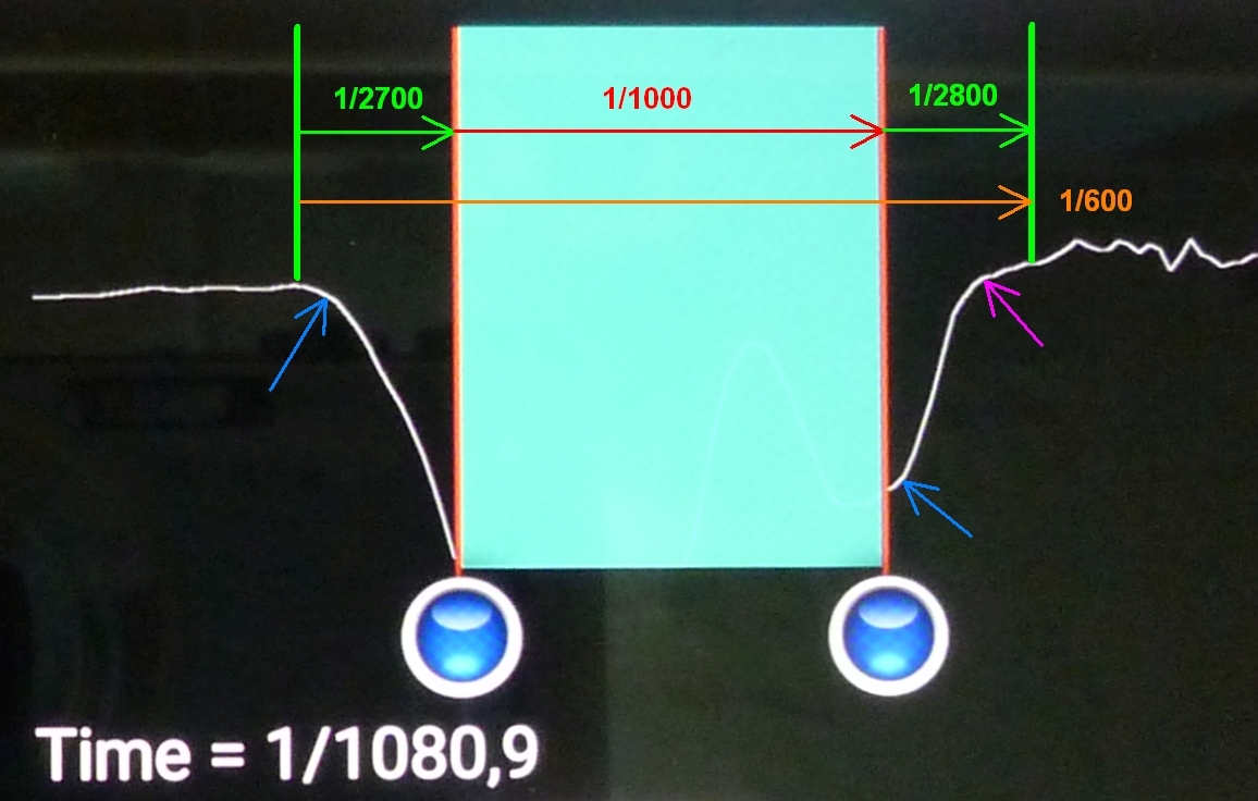

Because the Photoplug app displays the progression of brightness, you can manually adjust the time period to be measured. This is done using the two blue sliders. This allows the effect in the diagram from IC Racer to be taken into account.
This example shows a Minox shutter in action:
The blades open within 1/2700 and close in 1/2800 s. In between there is 1/1000 s when the lens is fully opened. The acceleration phases of the two blades are clearly visible (blue arrows). The entire process takes 1/600 s. For the effective exposure time, the average of the opening and closing times must be added to the time in which the shutter is fully open. This results in an exposure time of approx. 1/(1/2750 +1/1000) = 1/730 s.
The deceleration of the closing blade can be seen in the purple arrow in the picture above. With the opening blade, the deceleration cannot be seen, as this happens when the shutter is fully opened. Therefore, the amount of light does not change when the opening blade is delayed.
I took this measurement with the Photoplug and the corresponding app.

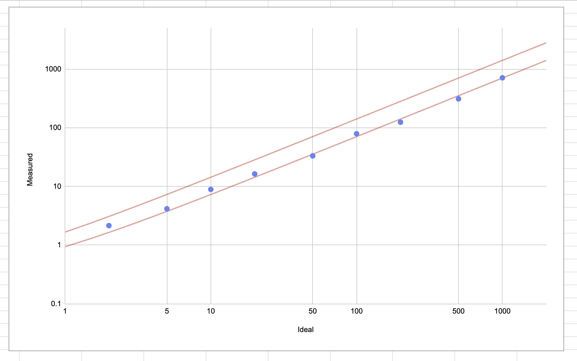

The method I describe appears to work at all shutter speeds. Full results for the camera I tested are in the attached image. The red lines are +/- 1/2 stop from ideal.
I use the same setup to measure speeds on cameras such as copies of early Leicas (don't own the real thing) where a beam cannot be transmitted through the film plane to a detector. In those cases I put a piece of reflective film on the pressure plate and bounce off that.
