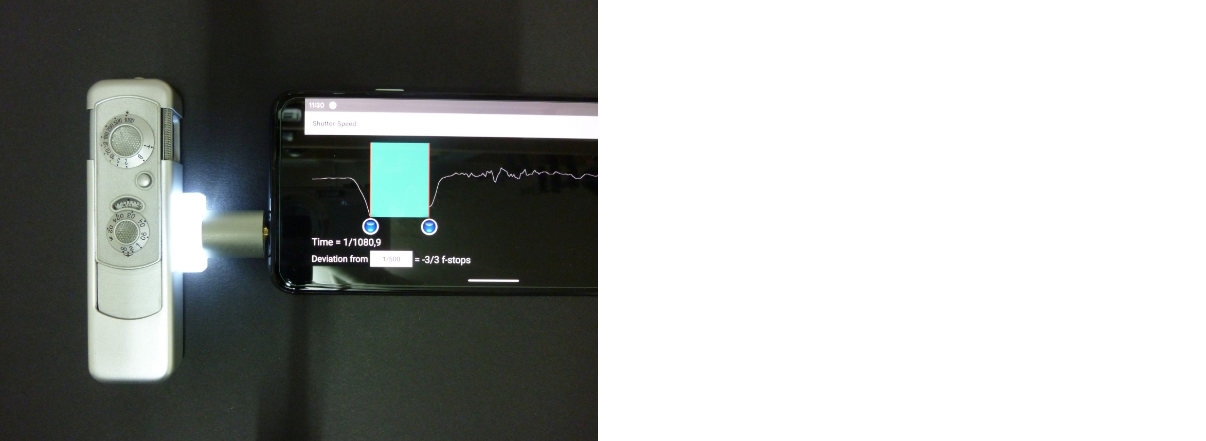

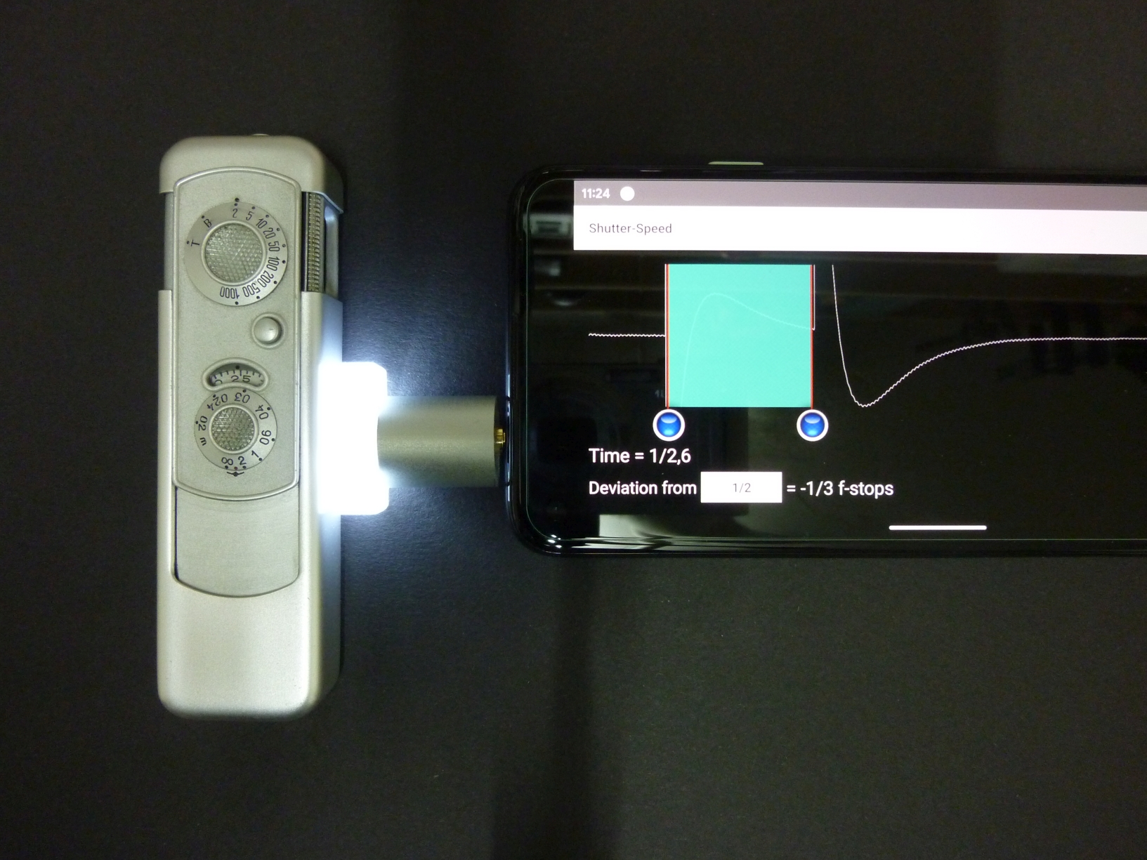

DIY device for Minox Shutter Speed measurements
When offering used Minox cameras, the seller often states that the camera works because “plausible” noises can be heard at different times when the shutter is released. Aside from the fact that these noises can occur without the shutter even opening, the times can be significantly incorrect. The only way to tell by ear is whether longer shutter speeds produce longer sounds.
If you actually want to use the camera to take photos, you need to know how precisely the shutter really works. There are various methods, devices and apps for measuring shutter speeds, such as Shutter-Speed. Most methods are based on positioning a light source in front of the camera and using a light sensor to measure the opening time of the shutter. From the opened back panel one measures the opening time of the shutter using a light sensor. In addition Shutter-Speed also offers the possibility of estimating the opening time based on the shutter sound. No additional hardware is then required.
All of these procedures cannot be used with Minox cameras because the back of the camera is not accessible and the shutter noise on the Minox does not allow any estimation.

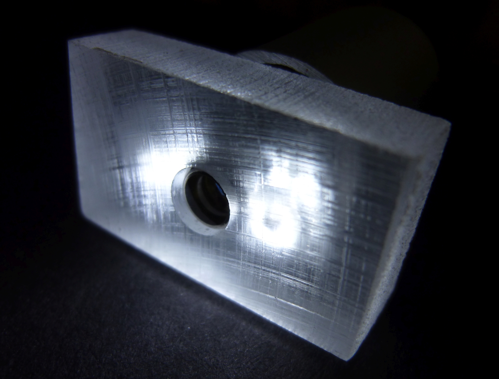

However, with a modification of the “Photoplug” light sensor, which can be purchased for the free Shutter-Speed app, measuring Minox shutter speeds is very convenient. The sensor is plugged into the headphone port of the smartphone.
The idea is to use the reflections from the highly reflective surface of the Minox shutter and to place the light sensor and light source next to each other in front of the lens. As soon as the shutter opens, there are hardly any reflections. The Shutter Speed app can use this difference in brightness for measurement. In addition to the light sensor, I modified the sensor to contain two LEDs as a light source in a plexiglass housing. The front is matted to create a diffused light:
To measure, simply place the Minox with the lens in front of the sensor and release the shutter. The app then shows the measured brightness progression:
The opening time of the shutter is obtained by marking the dark phase (here: set 1/2 s, measured 1/2.6 s):
Measurements with two Minox A IIIs cameras will follow.

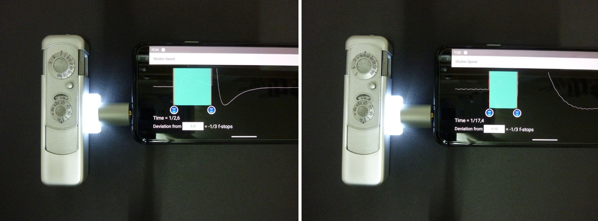

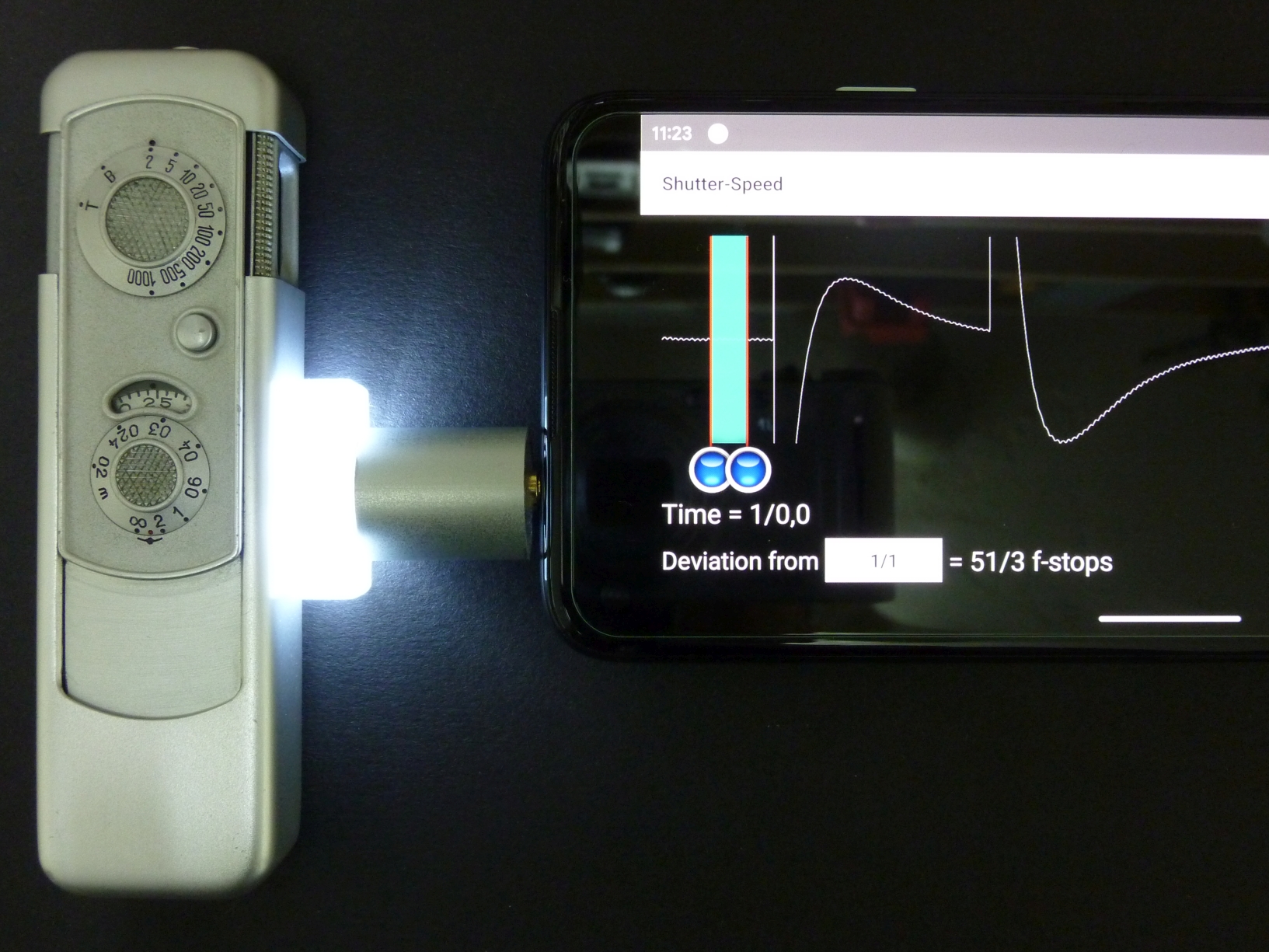

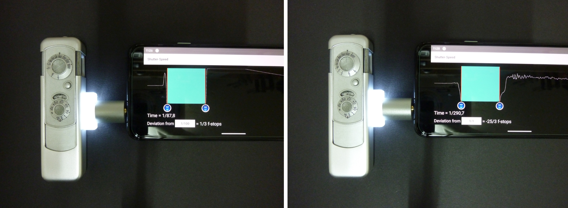

The following measurements were taken using a professionally refurbished (CLA) Minox A IIIs:
1/2 s / 1/20 s
1/100 s / 1/500 s
1/1000 s
Please note that the f-stop deviations are not necessarily displayed correctly. To do this, you would have to select the times set on the camera in the app. However, not all values are selectable. However, this has no influence on the measurements.
A simpler method is to use a roll of film and shoot at1 sec, 1/2, 1/4, etc using a ND filter as needed. Develop roll of film and inspect the negative.
You're right, easier in the sense that you don't need any hardware. However, the electronic measurement is faster and, above all, more objective. The assessment of the negatives depends on many parameters, such as the type of film, developer and development method. If you always have the same workflow and rarely have to do it, it might be an option.
With my setup it takes me about 1 minute for 4 measurements. With the Minox's 9 shutter speeds, that's 3 minutes including setup to completely and objectively test the camera's shutter speeds.

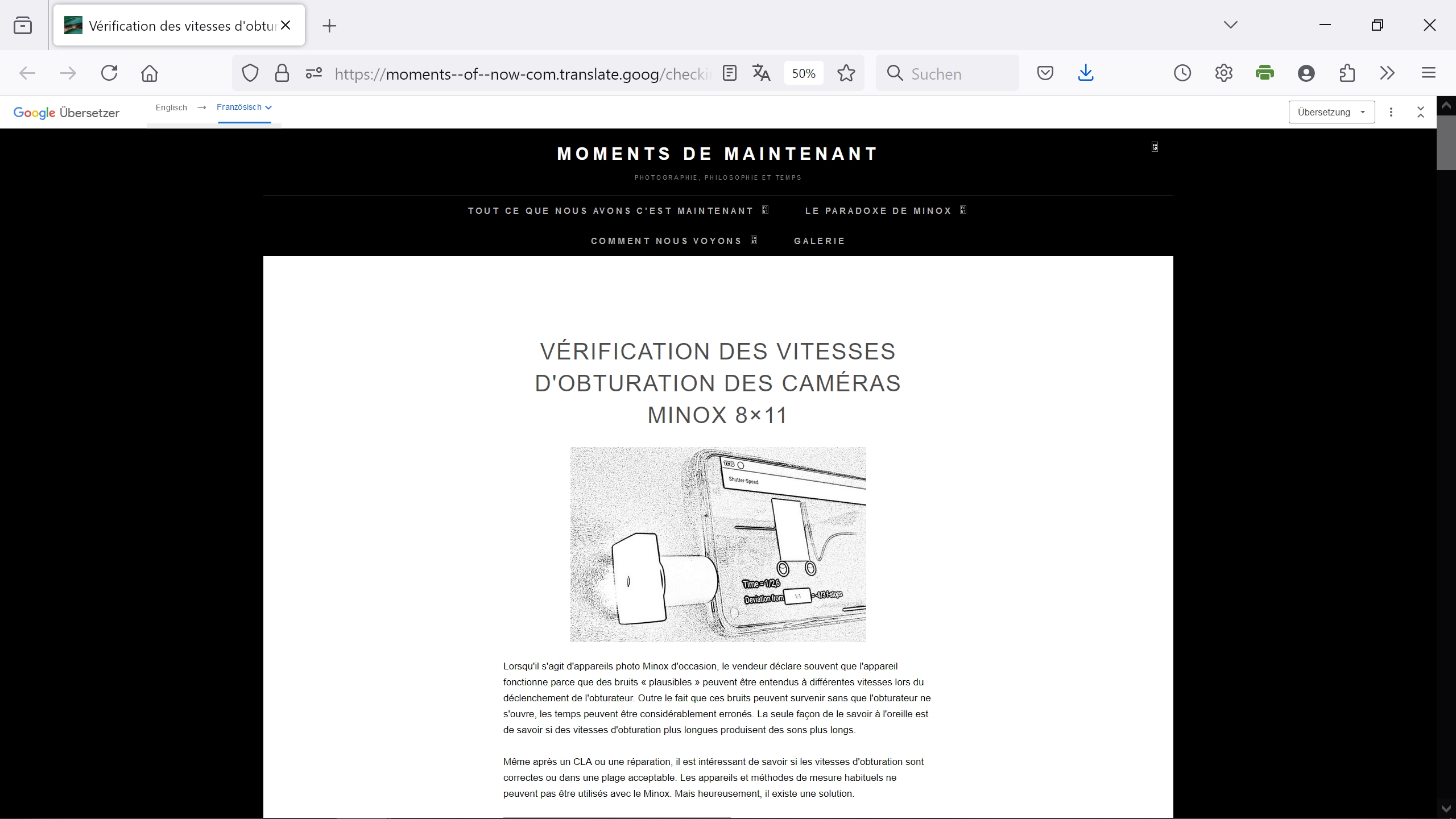

By the way, I have now hopefully presented my method a little more clearly on my website here:

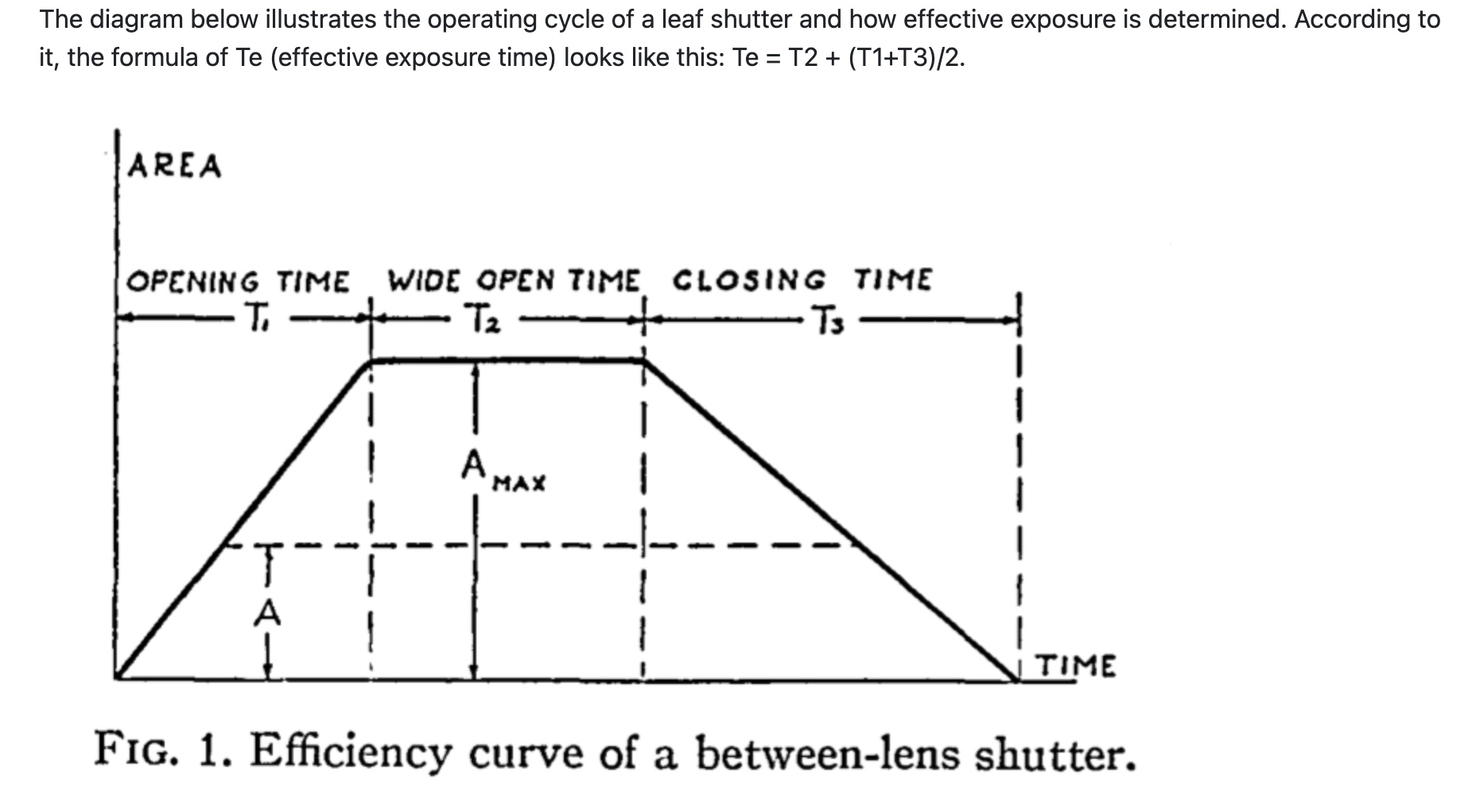

No, not that simple I'm afraid. It seems so simple, use a sensor to measure how long it sees light. Alas, that just does not work.
I have updated my The Shutter Tester to include leaf shutter testing, using the formula below. However, not having a leaf-shutter, I have not been able to test it against an actual shutter, just a mock-up, which seems to work perfectly.
One does not just measure the open time in the centre of the shutter, but one also measures the time for the leaves to fully open and the time for them to fully close. The only way to do this is with two sensors, but again one has to calculate the raw readings to allow for sensor width, which then gives the correct result.
(Thanks to IC Racer, for the diagram below).
The formula is time open = centre open time + (time to open + time to close)/2

Agreed, that why I said "aperture-dependent"! But for the slower speeds (slower than 1/100?) this effect is second-order, I think, after all a measurement of the total light reaching the image plane needs only to be good to around 20%, even if exposing colour transparency film. I've used my measurements for exposing Provia 100f for several years, and the results are "perfectly" exposed (well, nothing's perfect!).
I would be really interested if you compared the single- and double-sensor methods on a leaf shutter at a couple of apertures.
