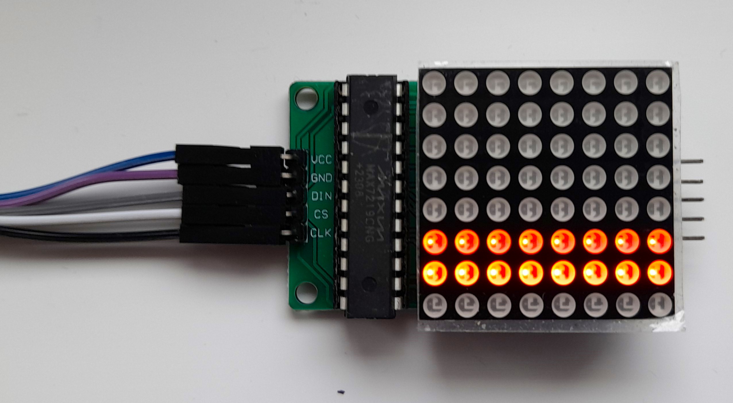

The only simple way that I can think of is a row of LEDs. Each one lights for 1/30s before extinguishing and the next in series turns on.
At a shutter speed of 1/30s, one should see 1 or 2 LEDs lit. Any more and the shutter would be slower than 1/30s.
Next run the LEDs at 1/60s. Again at a shutter speed of 1/60s one should see 1 or 2 LEDs lit.
This can be continued through all the shutter speeds.
Very easy to make, probably £5 in parts or just bits from the scrap-box.
If anyone has any better ideas, I'm happy to have a go at building it.

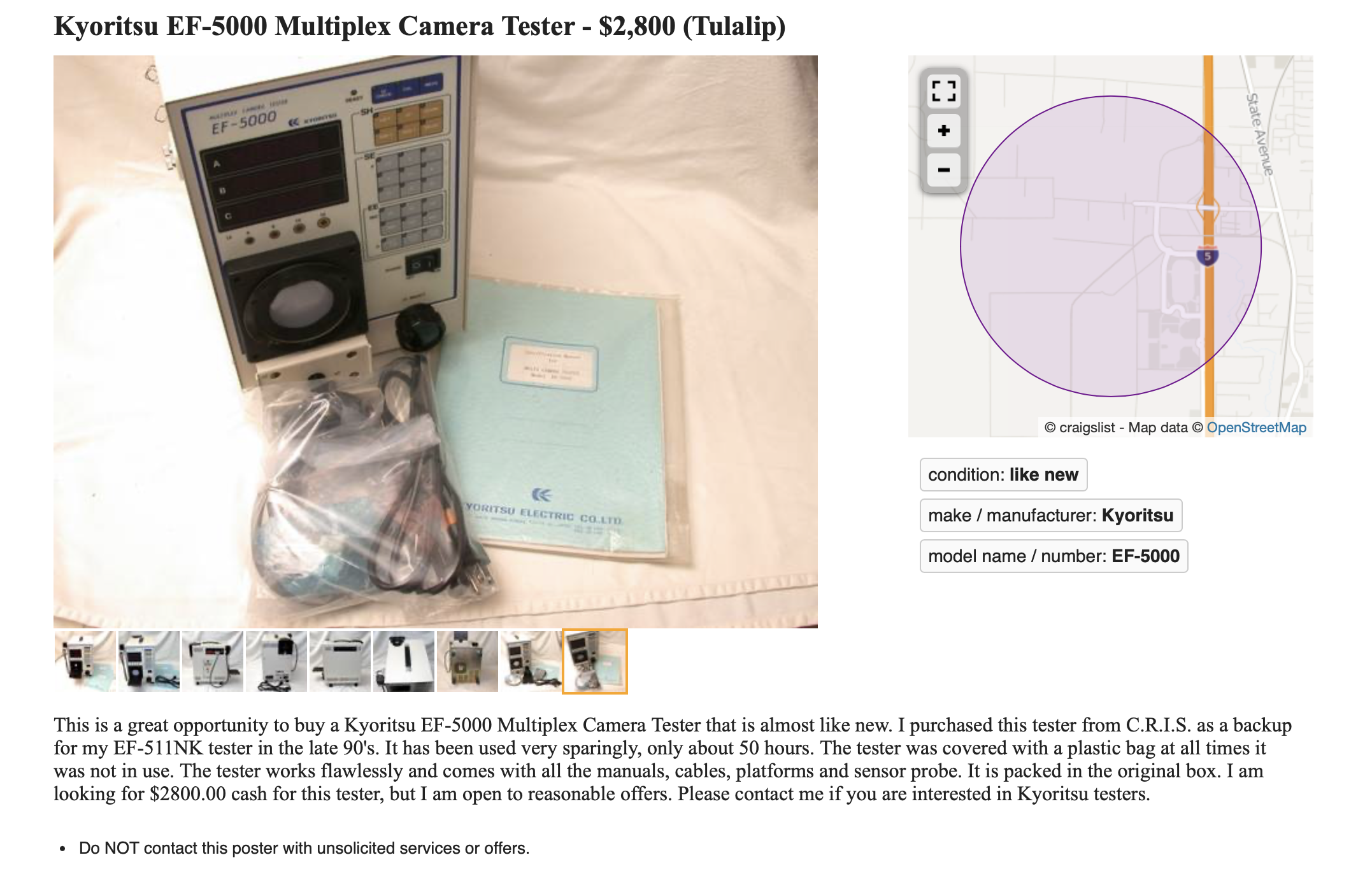

But then the shutter is going away in digital camera so it may not be relevant much longer. I wonder now if we can get our hands on those Kyoritsu shutter testers as repair shops for film cameras close down.
You will be lucky. In the noughties maybe, but now anything film related has sky-high prices.
Did any one here get this one? I checked and this listing is gone now. I think you can still order a new one from C.R.I.S. but it might be around $5,000.

I have build a little strobing array of LEDs which when photographed (by a digital camera) or looked at though the film gate of a film camera, will show a number of LED rows. The strobe speed can be set to standard camera shutter speeds, so when viewed, two rows of LEDs should be seen.
If three or more rows are seen, then the shutter is slow.
Only uses a few cheap parts & is easy to build. I have started a new thread for this.
