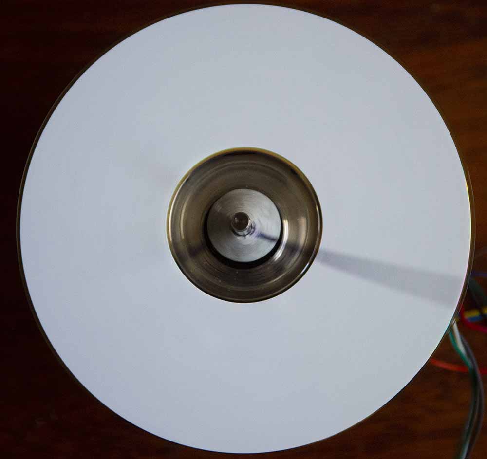

Out of curiousity I put a CD on a stepper motor and I run the motor at 1800RPM. I shot this image at 1/1000 sec. If the shutter speed is correct the angle of the blurr should be about 10.5 degree. I can't really measure it precisely though.
That’s where you can take the image into Photoshop and use the measure tool to find the angle
Thanks I didn't know that tool in Photoshop. I used Autocad but with either tool it's kind of difficult to measure accurately. I do think it's close enough and the error is 10% or less which I think is good for the 1/1000 shutter speed. I can try to spin the disk faster and see what happens.
