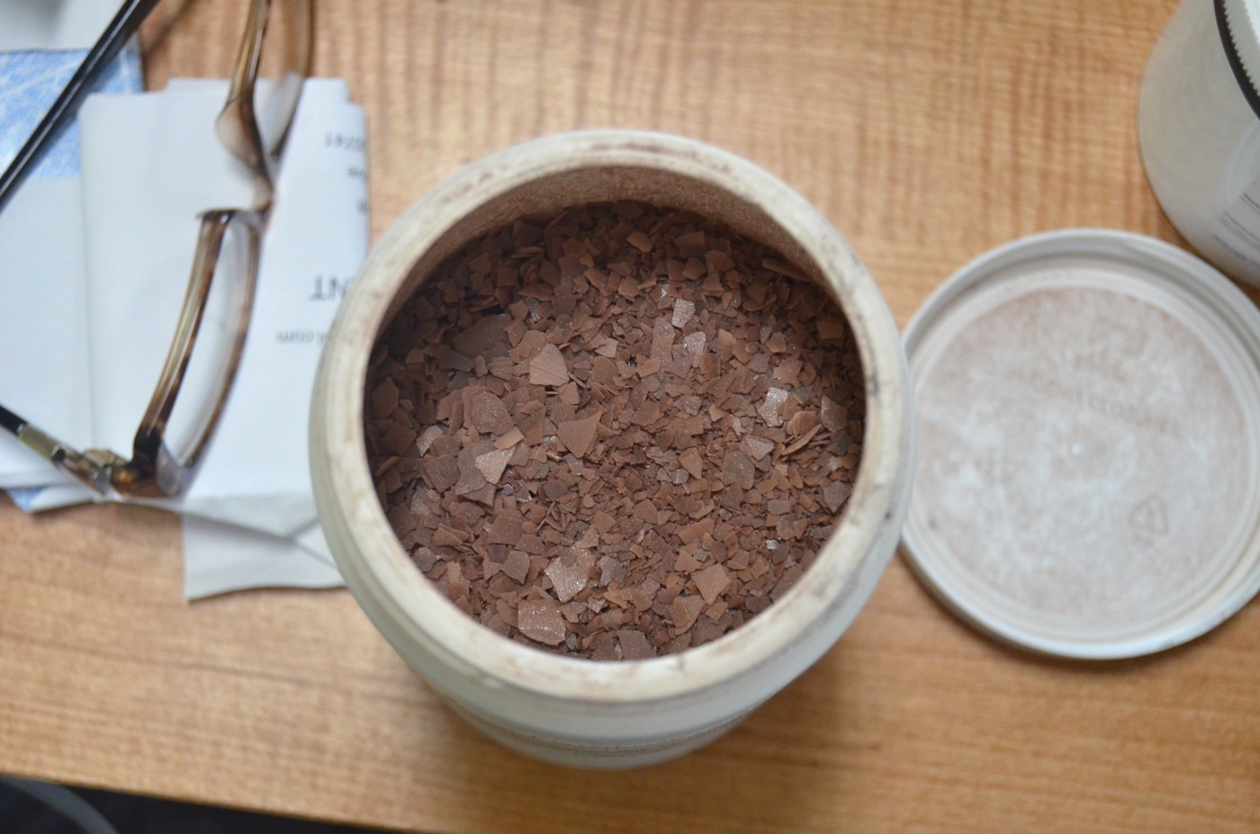

The PPD I received was a medium reddish brown. I wonder if it was too oxidized to be reliable? I have not used ppd before so I don't know how much discoloration is acceptable. Or maybe the film doesn't like this kind of developer.

I posted this separately, but should I increase PPD? does this look oxidized to the point of reduced activity?

It will be difficult to determine the real purity of your PPD flakes with amateur means. The not cheap but cheapest way to see whether PPD quality is an issue is to get some fresh PPD from a known good source and compare results.
Well I got this from Photographer's Formulary, I assume they know what they are doing, but it looks a bit oxidized. I will do another test of this GAF film tomorrow, increasing the trisodium phosphate from 6.9g/L to 10g/L. If development time is still too long, I may increase the PPD by say 25% in case oxidation is a factor.
PPD oxidizes to all kinds of brown colored goo/polymers if conditions are right/wrong. One thing you could look is whether brown discoloration is only on the surface or throughout the flakes. If only the surface is brown but the interior is white, then the bulk of the PPD may still be unharmed. NOTE: PPD is crazy toxic and can trigger nasty allergies, please be extremely careful when handling this stuff!!

I took a flake in some tweezers and cut it with scissors. It was light brown throughout. I may have to experiment with the quantity in the developer, although I have used CD4 in similar condition that seems to work OK in color development.
