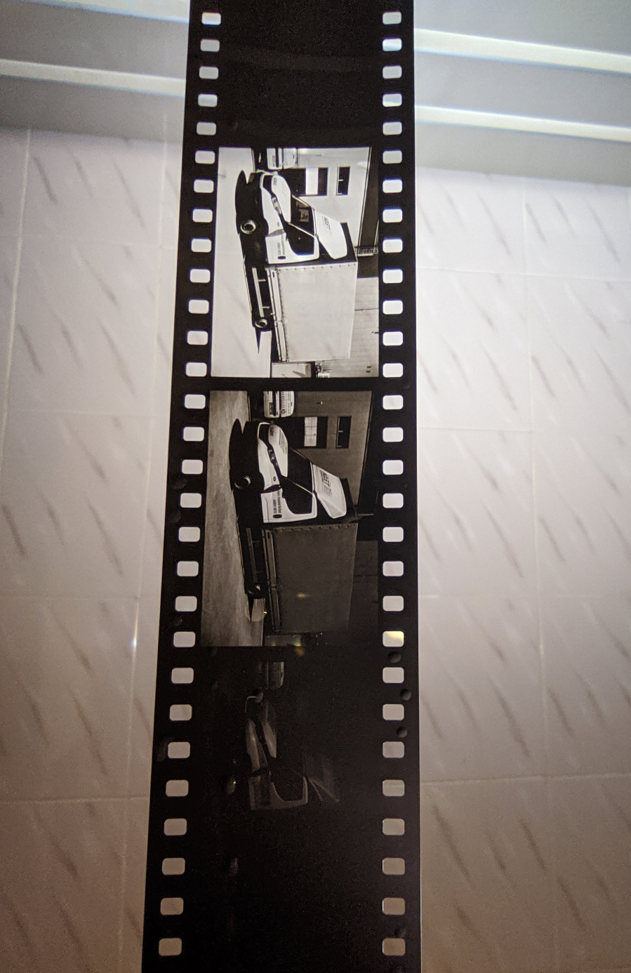

The only similar film I’ve tested is LPD4 - an extremely bizarre thing. Practically speaking, the film has almost no latitude, and the contrast is awful - midtones are basically nonexistent. On the other hand, it does have a very clean black. These are three frames, each one with a one-stop difference from the previous one…

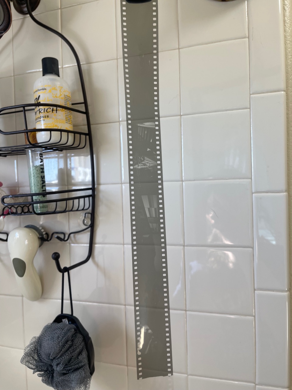

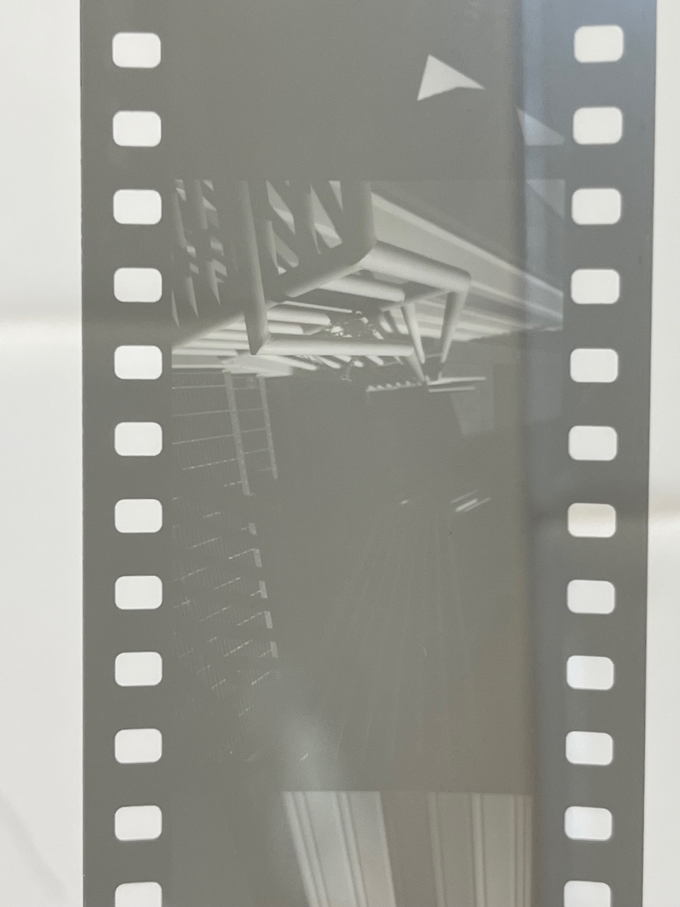

Finally developed this film, it’s still good! I underexposed these though, oops…

Congratulations! So this is what direct film looks like... Unlike typical underexposure, the developer here might have been too "soft," and the unexposed areas weren't too dark.
Last time I used 20g Anhydrous Sodium Sulfite, 1g Vitamin C, 1g Dimezone-S, in 1L water. This is a very large amount of Dimezone-S compared to regular PCTEA, to make unexposed areas dark, but more exposure is needed to keep exposure areas bright.
