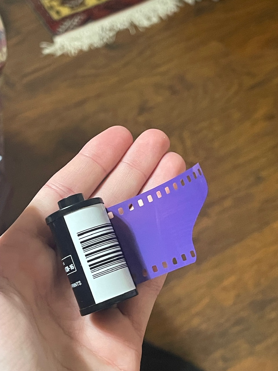

Today I got in the mail some Imagelink HQ film, with perfs! Rolled up a spool and am planning on playing around with it tomorrow.
I also have a roll of 2465 in the wings ready development. I also have to cut a whole bunch of it to 4x5 and 120, so tomorrow is probably gonna be kinda busy…

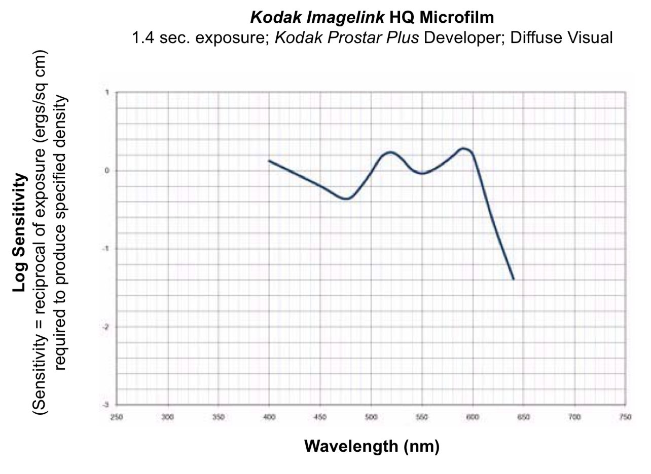

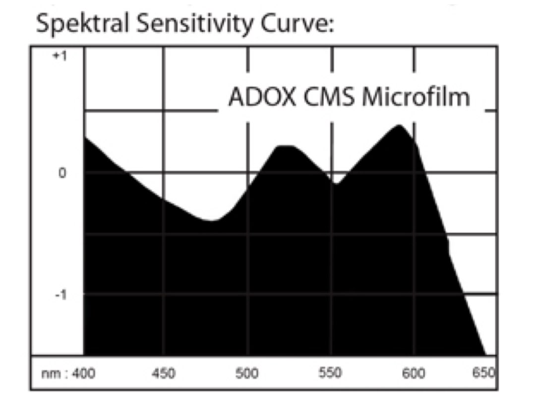

Hmmmmm, so I was doing some poking around, and what do you know, this stuff has the exact same spectral sensitivity as CMS 20 II, or at least it’s super close. That should actually give me a nice comparison, which is really nice to have considering some films I’ve bought have zero images posted online lol.

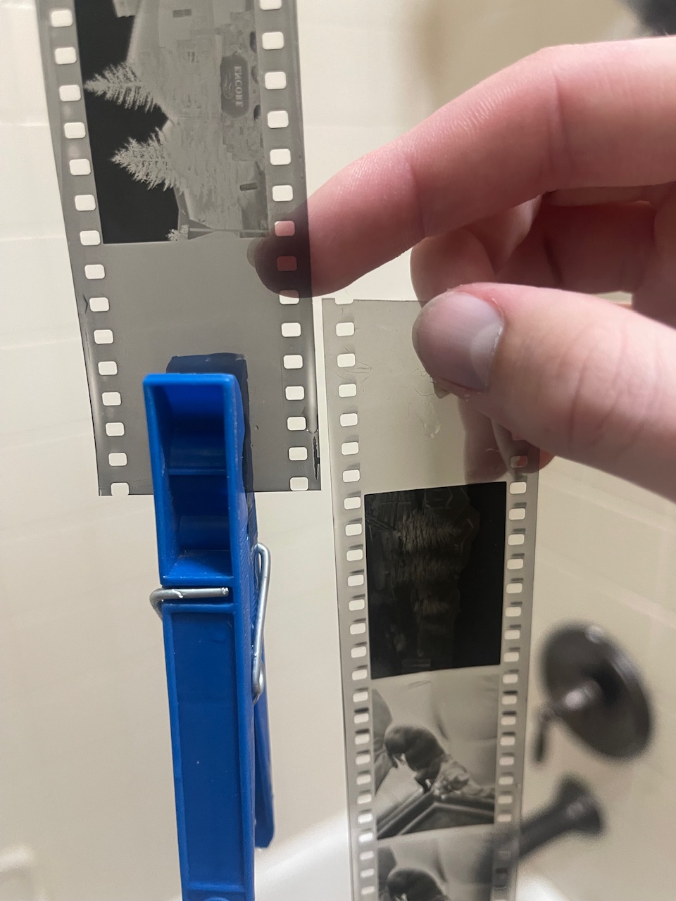

so, I’ve done a couple of more test rolls with HQ in H&W control, and I have learned a couple of things.
EI 12 seems to work best, 15 minutes at 20° gives you very nice negatives with both shadow and highlight detail.
EI 25 also seems to work alright. 11 minutes at 25° will give you decent negatives, still has detail in both highlights and shadows, but the base gets slightly fogged.
I have a feeling that if I added a pinch of KBr, I could probably get rid of the base fog, but I don’t have any on hand, and I don’t know if it’s worth chasing. Perfect is the enemy of done type situation.
Overall, I definitely think that this is a nice combination. I think I’m going to shoot a roll at EI 12 and scan it, and I might scan the EI 25 shots as well.
I attached a picture showing the base fog increase, curious to hear your thoughts. Is it worth pursuing? Or should I just not worry about it?

I bought some KBr, I’ll try it and see if it improves things.
MCB18
Jan 16, 2023
1,390
Colorado
OK, well, I have my answer. Adding a small amount of potassium bromide (approx. 0.13g/l if working solution) did in fact restrain the developer. There is a little to no base fog, but the film still developed as expected. I just used a very short 8 exposures roll for that test, but I’ll make a couple more test rolls and see about developing them and getting them scanned.

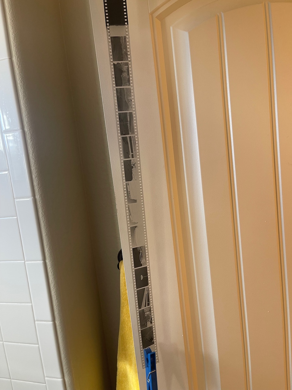

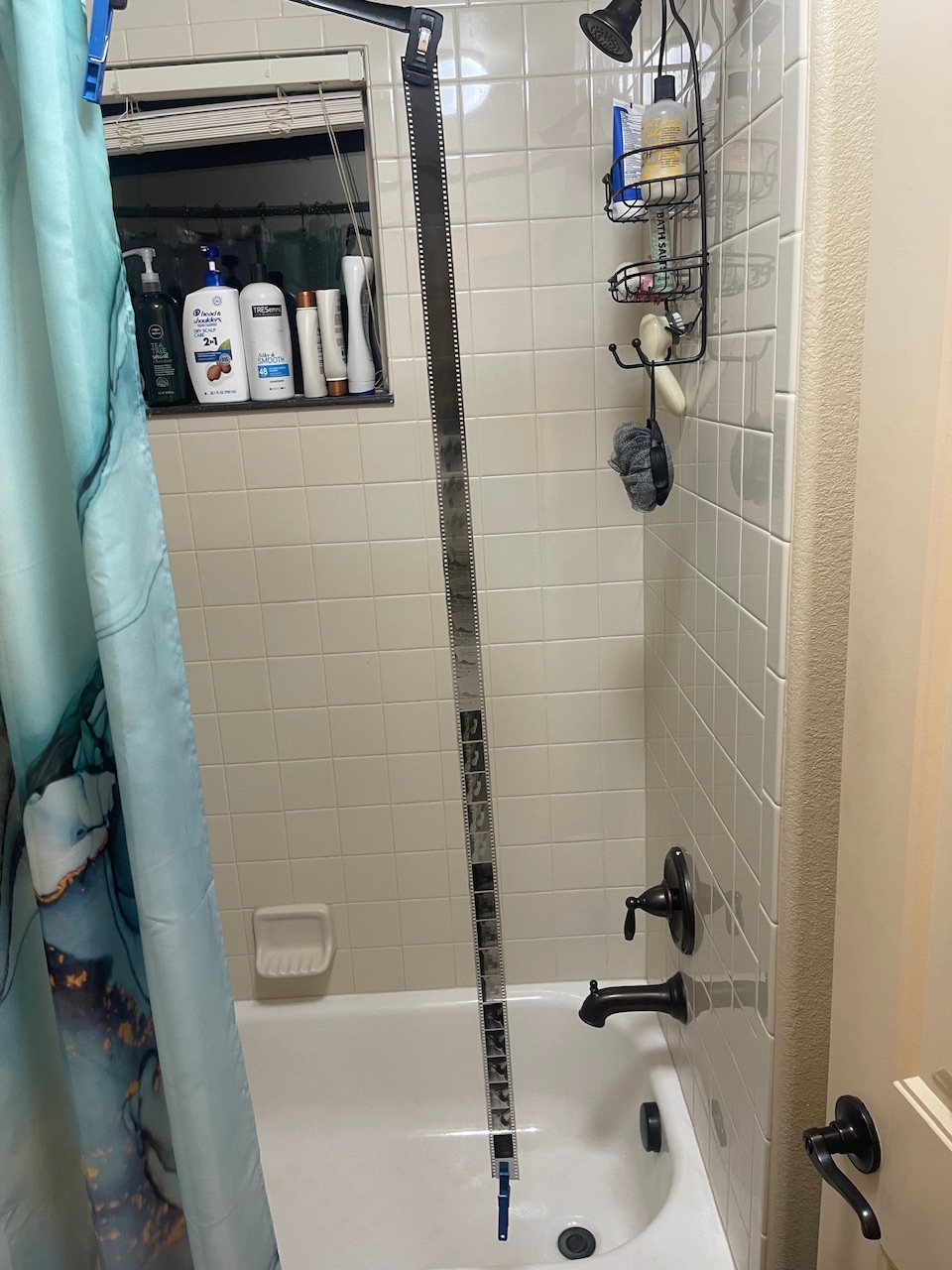

Well, the test roll that I previously shot at EI 12 looks absolutely stunning, aside from the few that are very obviously underexposed lol. I developed it at 23° for 10 minutes. I’m basically using the Adox CMS20 ii developing table, and it’s working very well, so that’s actually rather convenient.
I’ll see if I can scan these at some point.
