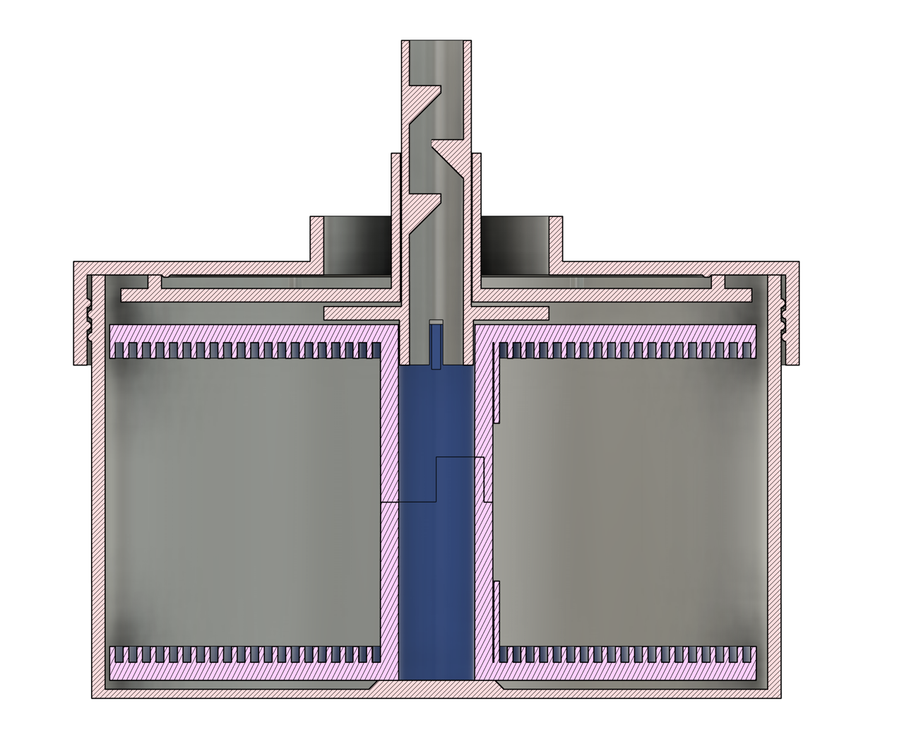

I would also like to know this as well, I have a 70mm processing tank I would like to make. Designing these things is not an easy task…
