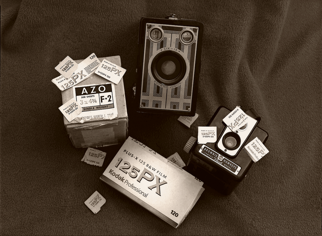

Even when I have an entire roll with similar subjects illuminated in consistent light, I prefer to tailor the development to create negatives whose exposure and contrast leads to the mid-tone rendition I prefer, and use split grade and other printing controls to deal with the extremes of SLR.
Here are two images from the same roll of film - actually adjacent frames on the same roll of film:
While the digitization and resizing processes necessary for showing them here makes a scientific analysis of the difference between the negatives problematic, I think it is clear that it is truly impossible to optimize the development for that single roll of film in a way that ensures that both negatives be printable with the same grade of contrast and no additional printing controls. My development (and in the second case, lighting control) targets are instead directed toward negatives where both can be well printed, using the controls available to me at that stage.
That may average out so that an "average" scene can be printed well at grade 2 without additional controls, but as I rarely can count on average scenes, I don't proceed that way.
