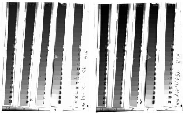

Thanks Analogsnob,
In your experience do these numbers that I am getting seem correct or in the ballpark?
Enlarger contrast range with my paper is 2.04
My low contrast test of the 21 step scale at 4 minutes with fp4 is 1.34 44%
My high contrast test of the 21 step scale at 7 minutes with fp4 is 1.84 60%
My stouffer 21 step scale is 3.1
I am no where near the 15% you referred to above, have I done the math wrong? I'm trying to make the chart of gamma, development and exposure with these figures
to make accurate exposures and development of masks and I'm not confident that the numbers I have reached are correct.
I really appreciate your help!
Erik

Erik I think you have done it right. The problem is that FP4 is a whole lot contrastier than Pan mask ever thought of being. You need to be able to get down to the 10-15% range. You could try diluting whatever developer you used to get here 1:1 and see where you fall. Pan mask wouldn't do 60% no matter how long you processed it.
You might have better luck with tmax 100. I've never tried it but kodak says it works. In my experience when decreasing development it kinda drops way off so from that I think it reasonable that it might work.
You also stop at 4 minuits, you might try dropping as low as 1minuit. Remember that 10% of a 3.0 density range is only .30 which means your mask dmax at that level is only.65 to .70.
Are you using the CPS1K or the CF1K?
Developing in a tray with constant agitation I don't think you need worry about unevenness with short process times (at least until you get below the induction time) also it is my experience that as long as agitation is constant all developer dilution does is reduce activity to make the developing time longer.
Keep swing'in slugger!

Well it's good to know I did the math right:smile: I tried to develop for shorter times but I couldn't get the .35 in the # 21 step to show up until I did a longer development time. I'm using a jobo machine for repeatability of results and the paper I tested was the lower contrast clm.1m.
Do you think I can use the exposure/development graph chart with these numbers and be successful with the times and exposures it will give me? I would love to be able to read the density range of a tranny and just plot some numbers on a graph and get a perfect mask on the first try if possible:smile:
Below is a scan of my 2 different development test times, do they look alright? I know you can't read densities, but is the test valid looking or is it screwed up in some obvious way? I'm hoping and trying to build my confidence level to a point where I can stop second guessing myself and know that what I am doing is the right thing:smile:

Erik the chart will work but I fear you will need less development especially with a dynamic range over 2. The proof is in the printing if your contrast winds up low and your prints muddy you will need flatter masks. For what I was doing 25% was fairly common but I also routinely used 10-15%. Your 4 minuit test looks like what I took as a top end.
You might consider a tray process as that may be the only way to get low enough. Try reading some representative transparencies and figuring the required mask strength. If you get 40% +/- you're good to go but I think you will find you'll need somewhere close to 20%.
A mask should look thin and flat like you would hate to try and pull a print from it if you were printing B&W.
Once you get a working chart it will be good until the materials change.
