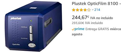

You may consider a Plustek for 35mm, the 8100 one is under 300€
This little marvel delivers 3800dpi effective , the same than the Coolscans, but it's cheap, it has warranty, no problem with future operative systems. (https://www.filmscanner.info/en/PlustekOpticFilm8100.html)

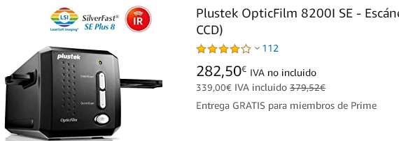

Also this cheap version has multi-exposure for dense slides and, the 8200 version has iSRD dust remover (like ICE) and BUY it because it has NEGA-FIX, the best color inversion you can dream with for color negative film.
https://plustek.com/us/products/film-photo-scanners/opticfilm-8100/
A total bargain and totally competent Pro scans.
Also this cheap version has multi-exposure for dense slides and, it has iSRD dust remover (like ICE) and BUY it because it has NEGA-FIX, the best color inversion you can dream with for color negative film.
As I understand it, iSRD is dust snd scratch removal only in post work and therefore software only.
Also, to achieve 3800dpi scans, you have to scan at 7200dpi mode increasing scan times to 8minutes as well as filesize. Then you have to post process for dust and scratches adding another 5 or so minutes?
By contrast, the slower Coolscan V takes 3 minutes with ICE enabled and 1 minute without ICE. The 5000 takes 50 seconds and 30 seconds correspondingly.
Also, you have to use filmholders and manually advance the frames to scan with the Plustek.
No doubt, maybe cheaper then a Coolscan V and with warranty.
BTW, how much have you used your Plustek and have tested the effectivy of iSRD?

Les, let me rectify the oinformation I posted. The infrared iSRD dust removal is featured in the 8200 model, but not in the 8100, and it works perfectly. I use an V850 and I tested the 8200 of a friend to learn if it would be worth to me for 35mm. It was a 8200 what I tested, not the 8100, I tested, the 8200 is a bit more expensive 280€ plust VAT
The 8200 iSRD is stellar for color film which is designed to be transparent in the IR, for BW iSRX is used and this is a sftware tool.
I was considering the 8200 to complement the V850 to make a good team, both scanning at the same time, the 8200 for 35mm and the V850 for the rest.
In my experience with color negative film the V850 is able to take absolutely all image quality the film has, but for BW, if wanting a more defined grain the plustek has some advantage, and I can produce more having two scanners working in parallel, so I'm seriously considering to get a 8200.
Interesting, the 8200i review on the same site states it's resolution is 3250dpi as opposed to 3800dpi on the 8100? But you still have to scan at 7200dpi in order to get that.
Scan times per frame is 4 minutes without iSRD and almost 10 minutes with iSRD enabled.
True... I guess that something is flawed in that 8200i rating, taking a flawed rating from the former 7600i, when the 7400i rating also used for the (successor) 8100i reaches 3800dpi effective, resolving element 6.2 for sure.
You are right, but in practice for most of the situations you won't notice any enhacement from scanning beyond 3600dpi (taking 1:25min), usually images in the negative have other limitations. First the situations where the film itself can record more than 50lp/mm at extintion are totally exceptional, then we shot 35mm handheld, we are in the DOF rather in perfect focus...
Of course a shot can be exceptionally sharp, and bebefiting from scanning with the plustek at 4800, but any enhacement beyond that point will really small.
Yes, the Plustek is slow at 7200 dpi, but the situations where you do that are exceptional, not everyday everyone makes a 1m high quality print in a lightjet. But the day you want that the Plustek throws 3800dpi effective, which is amazing for such a cheap and trouble-free machine.

Yes... The Plustek 120 is very expensive, but the 35mm is a total steal, of course it's not pro gear, but delivering Pro results when required.
