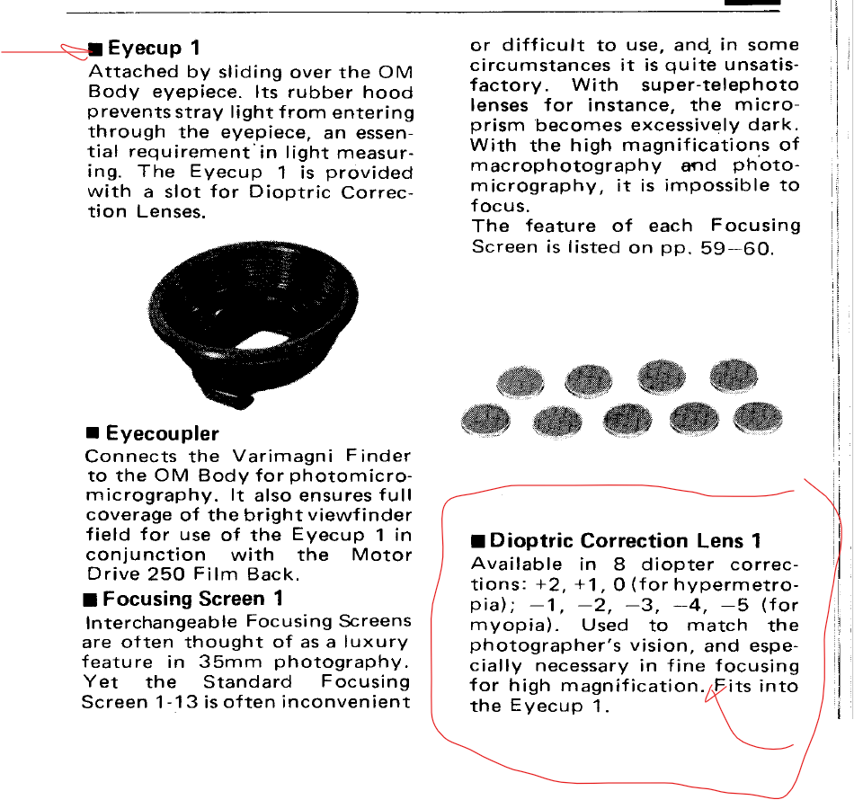

A simple solution to correct your vision threw the viewfinder.
I have thought about this solution too, but I don't see how to place a diopter on the OM1 or OM2. I know it sounds stupid but... do you just slide it inside the "viewfinder plastic hole" ??
From the OM-2 manual:
The Diopter correcting lenses are used with the accessory Eyecup.
