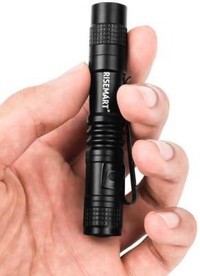

need to find a better way to advance the film, get a new red window, mark the advance lever, or something...mine doesn't have a counter.
Get one of those pocket sized LED flashlights - they make the world of difference.
This sort of thing: https://www.amazon.ca/RISEMART-Flas...d+light&qid=1613339235&sr=8-9&tag=googcana-20

There's only one flaw with that method. I have to remember the flashlight. That's how I read it when I took a couple shots in my house, but part of the reason I got this was for portability and I don't really want more moving, loseable forgettable parts in my 6 kit. And I was worried about fogging the film. Gotta be a way to mark the advance knob and maybe the top too, not so much to count but to know when I've advanced one frame. Though I suppose that might change a little as I advance through the frame and the takeup roll gets bigger. Not sure if its enough to matter though.

The flashlight also helps you see the dials on the camera and find stuff in the camera bag :D.
I keep one in each camera bag - $4 at the Dollar store.

Ah that's right, you carry yours in a bag. I have a ton of small flashlights but I could still lose it in a camera bag. But I plan to carry mine either in its case (once I get one) or in a pocket.
