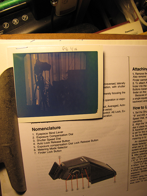

Not sure if I've post this before. Polaroid Pack Leak in Polaroid Back:
A Polaroid Pack leaked in my Polaroid Back for Mamiya RZ67 Pro.
Is there anything I can do to redeem that back? (the corrosion burned the asa dial off, but it was set for that pack... that being 400asa.)
Thanks for advice! cheers....
I watched Nico's Photography Show "Misloading Polaroid film"
on YT
He shows you can open the Polaroid Back without damaging all the film.
I did that. With a hand held meter reading, I got f8 @ 1/15 sec for asa 100. I just barely got an image. The asa dial must have been set very high to give me that underexposed image.
