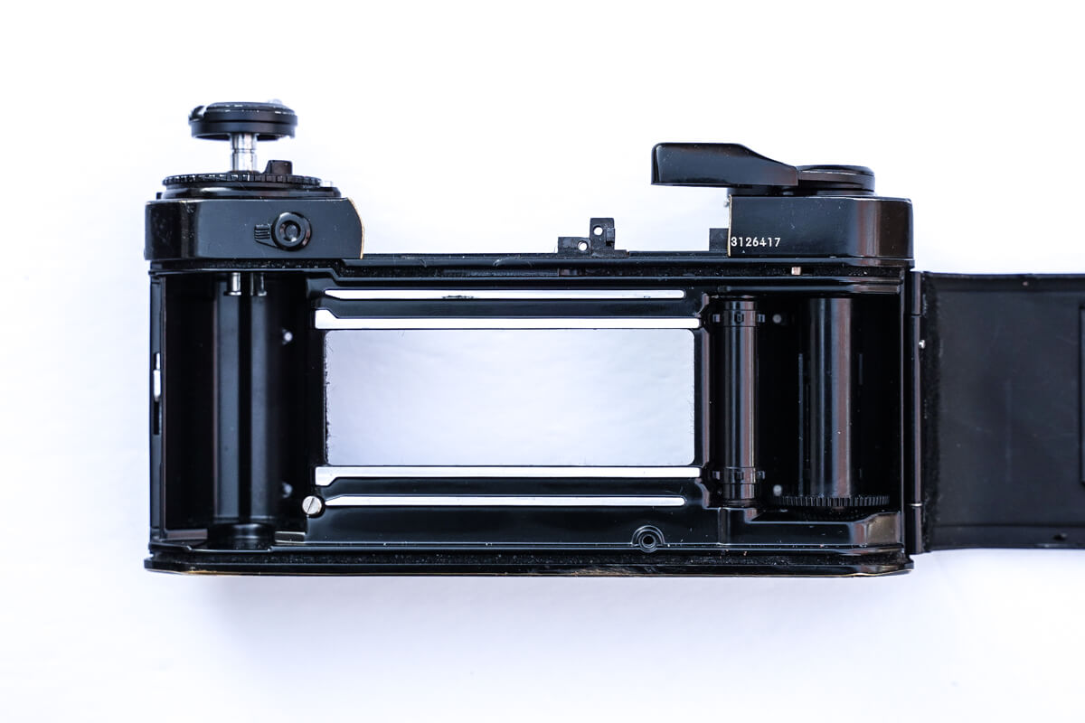

It's all over, unfortunately. The film does lie flat - the gate still retains the raised silver factory edge and with tension and the lens off, it looks pretty darn flat when viewed from the front and back. I need to do some measuring from the lens to the film plane next I think.
Here's an image from Jess's article that shows you what the back of the gate looks like.
Some 3D printed materials aren't fully opaque. I understand there were issues with plastic lensboards for the Intrepid 4x5 camera that passed enough light to fog film. The lens mount for the Presspan looks pretty thick, which would help, but depending on the fill volume and material it might be an issue. It's also possible that the material is not opaque to very red or IR light and the film has just enough sensitivity to be fogged by sunlight passing through. Either of these would be basically impossible to detect with a penlight - you could do a test by leaving the camera out in the sun for a few frames both with and without some material covering the lens mount, although it is hard to isolate this kind of leak.
