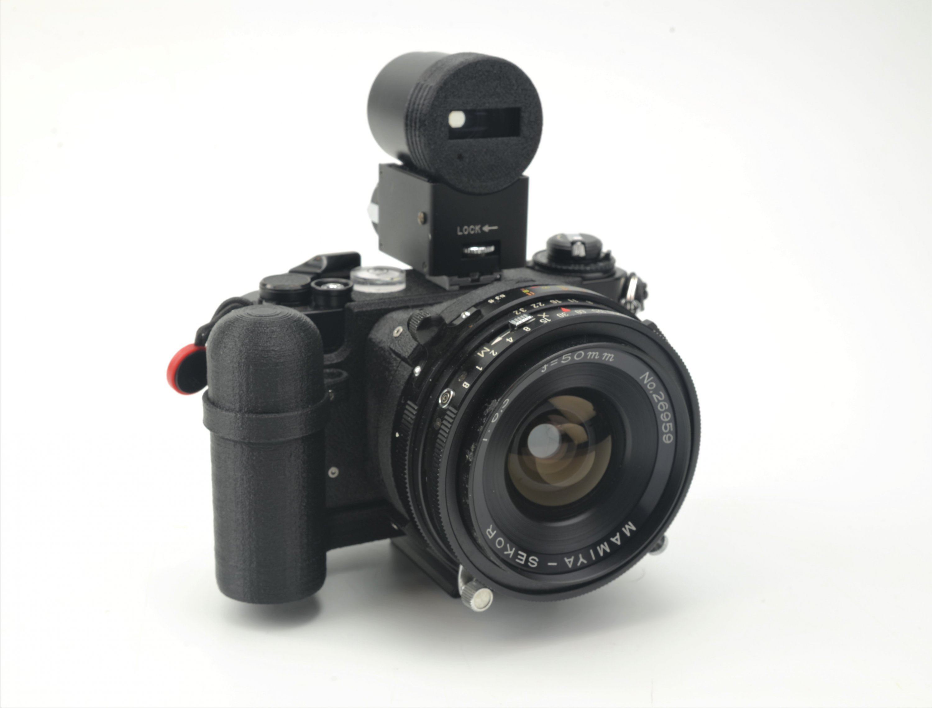

Just as an update - I finally received my PressPan earlier this month after nearly a 6 month wait. Freeman is extremely busy with orders after the interest generated by the Emulsive article and Jess's video. I plan on doing a full write up in a few weeks on my site but some initial thoughts after 7 or 8 rolls:
1. It's a good lightweight alternative to carrying around my GX617 or my RB67 with 35mm adapters to shoot pano's.
2. Build quality is very nice - I got the black version of the donor body so its all nice and uniform.
3. Since I've ordered it, Freeman has put up a pricelist on his website with all of the options possible. At the time I ordered I didn't know that the seals on the donor body weren't replaced as part of the build - it costs extra - so that's one small thing I needed to do after I took possession. I've replaced seals in dozens of cameras so this wasn't a big deal but may catch some non-DIY person off-guard.
4. The 50mm Mamiya Press lens, while sharp, is extremely slow. This is no fault of the PressPan of course. But carrying it on a hike in the woods, even with Fuji Pro 400H, meant that even "wide open" the exposure times were slower than I'd like to chance hand-held.
All of that said, the glaring problem I am dealing with is parallax issues. With the 50mm Press viewfinder, there is a 9cm difference between the center of the viewer and the center of the lens. Even at infinity what you see and what you get are two different things - the film image will have less of the scene envisioned on the top and more on the bottom. I've done a janky work-around when shooting on a tripod - I marked a line 9cm down on the center column. Compose the shot. Move the camera up to the point where the 9cm line is, tighten the clamp, take the shot. Not unlike using the paramender I have for my C220. I'm OK with this when shooting on a tripod but handheld is difficult to judge the movement needed to accommodate.
If anyone has any thought's I'm open, thanks!
Jeremy

Doesn't the Mamiya Press 50mm viewfinder have a parallax correction adjustment? The 65mm viewfinder has a manual adjustment. If you find the view is off at infinity, the finder or shoe may need to be shimmed.
Yes - the 50mm viewfinder also has that adjustment. When at infinity I have it dialed to infinity. It's still way off. I don't think it can be shimmed because its too tall, unless there are negative shims to bring it closer. :smile:
Lacking any other solution, I've thought about setting up an experiment where I take several images of something around 50 feet away, adjusting the parallax adjustment down some for each image, and then seeing what I get. Unfortunately this counts only for that distance and may be different at others. I don't have a piece of ground glass small enough to tape to the film gate but maybe I can make one and try that as well to compare.
Alternatively I can look for another viewfinder that has a much shorter profile. (?)
Jeremy
As the difference is 9cm (about 1/2 a human face) no matter what your camera to subject distance is, I'm surprised that you are having problems with this at any camera to subject distance greater than 1 - 2 meters.
Could you have an alignment issue?
Maybe - that could be something to consider. The 3D printed housing that the PressPan lens goes into could not be in parallel with the top of the body where the hotshoe mount is where the viewfinder goes. If it is angled down by comparison, that could explain it.
Jeremy

What I meant was shimming the front or back of the viewfinder or shoe mount to tilt it forward or back as needed. I don't know if you have ever used a Mamiya Press / Super 23, but you can look at pictures of one. It's a wonderful camera but it isn't small, it's a tall body and the whole package is like handling a steering wheel (if you use the grip and roll back). Meaning that the 50/65mm viewfinders are already intended to sit far above the lens axis. Some parallax is inevitable at close distances, but if the viewfinder is off at infinity, it's likely that either the viewfinder optics are ajar (which (I'd think would be fairly obvious), or the finder is loose in the shoe, or the accessory shoe is not parallel to the lens axis.
You don't need a nice ground glass to put on the film gate just to test the field of view - a piece of clear plastic with some scotch tape will do. You can even use a piece of wax paper in a pinch.

OK, thanks. I'm going to mess around with it more this weekend. Its definitely not loose in the shoe - its actually a very tight fit, but the shoe is mounted on the 3D printed top which could be out of plane I guess. If that's the case due to the tight fit in the shoe I'm not certain how I could shim it. But it would be good to figure out what the issue is. In the end it may mean I just need to adjust to it.
