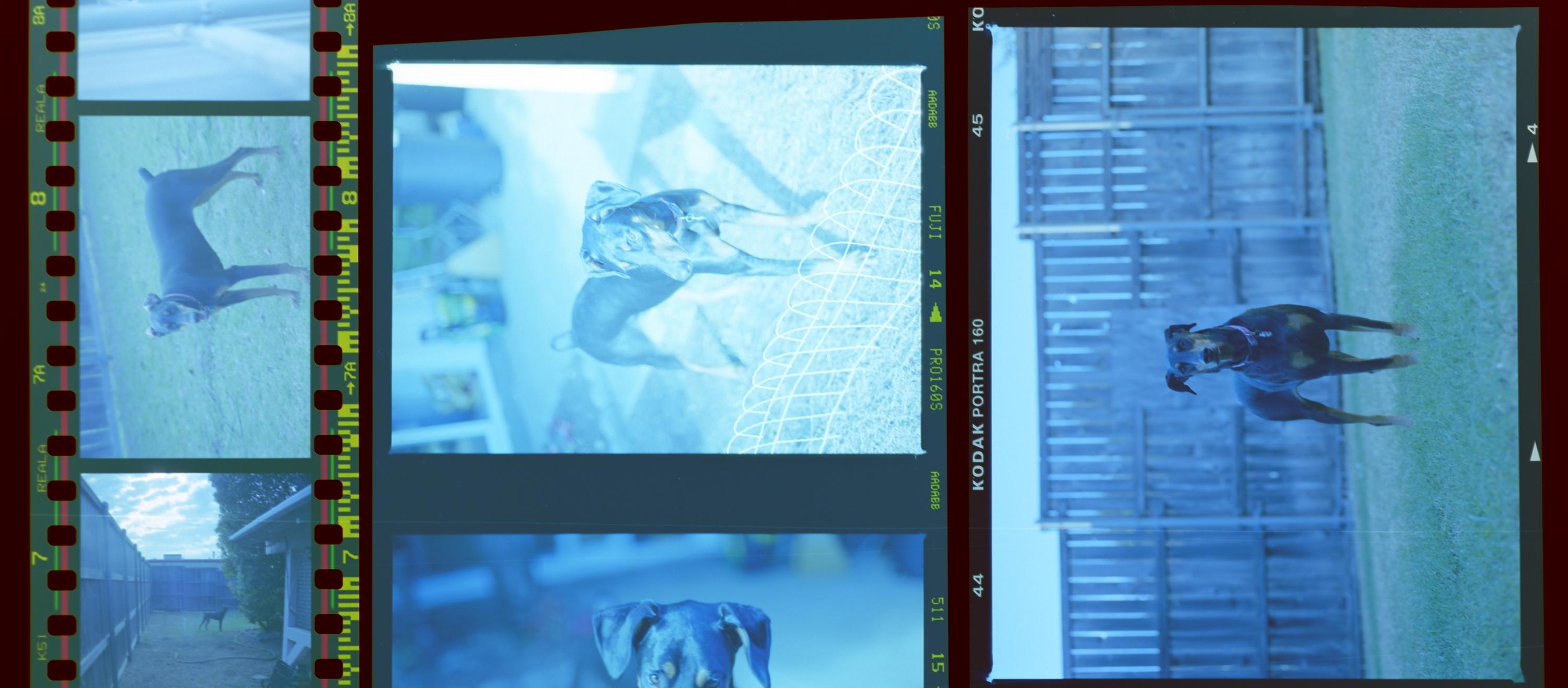

Here is a comparison between 135, 645, and 6x7 shot against a lightbox. The 645 is from the older Mamiya M645 1000S that I've sold. The 6x7 is from the RZ, first roll actually.

Sorry for the lack of clarity. I was after a 6x4.5 versus 6x7 comparison more than a lens comparison. I was just stating what I was interested in purchasing and what I currently have. As for the Fuji rangefinders, I was considering them as well so it's definitely on my radar screen.
