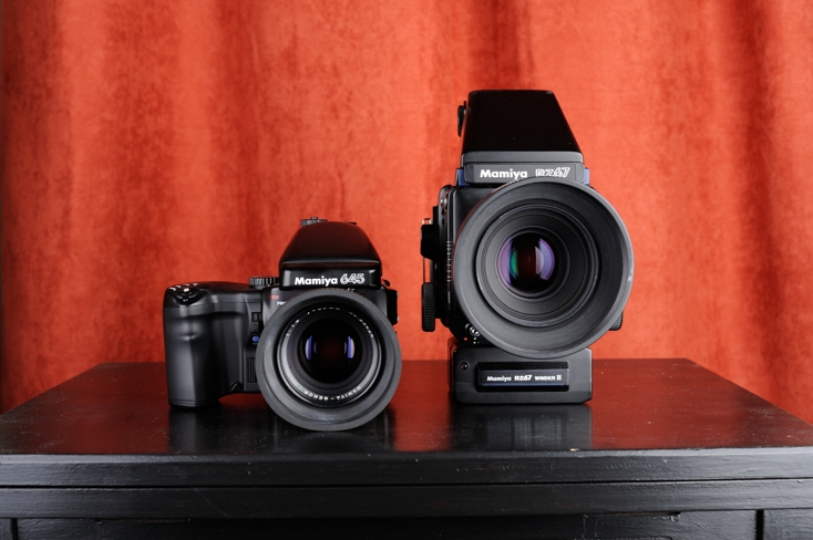

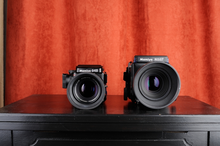

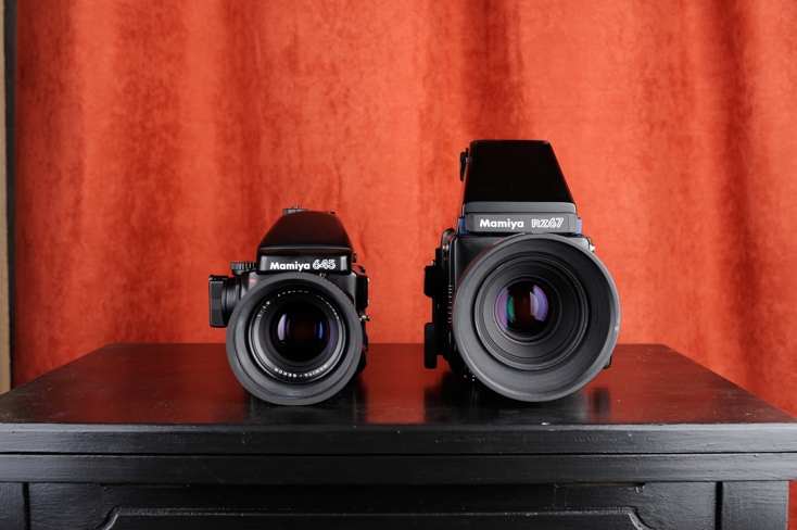

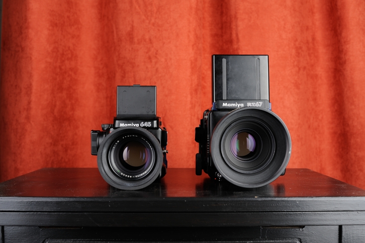

I have both with both WLF and AE Prisms and power winders. I'm not sure if I can take comparison photos and weights tonight, but PM me Thursday and I'll get that done for you.

Alright. Here we go.
I'm starting minimal (without lens) and then adding.
So, we start with:
- Body
- 120 back (RZ has film in it)
- darkslide
- handwinder (RZ has one built in, not removable)
[table="width: 1000, align: left"]
Mamiya 645 Pro
Mamiya RZ67
Notes
1.129 kg / 2.48 lbs
1.847 kg / 4.07 lbs
+Lens
1.579 kg / 3.48 lbs
2.526 / 5.56 lbs
645: 80mm 1.9 (heavier than 2.8), RZ: 110m 2.8
+Prism
1.775 kg / 3.91 lbs
3.304 kg / 7.28 lbs
645: AE prism, RZ: AE Prism
+PowerWinder with batteries
2.164 kg / 4.77 lbs
3.941 kg / 8.68 lbs
645: WG401, RZ: Pro II
[/table]
The winner? Both. The 645 Pro is great when you want to shoot like 35mm. The RZ is great for studio and slower outdoor shooting. (Prism and Power Winders VERY! optional on RZ.)
