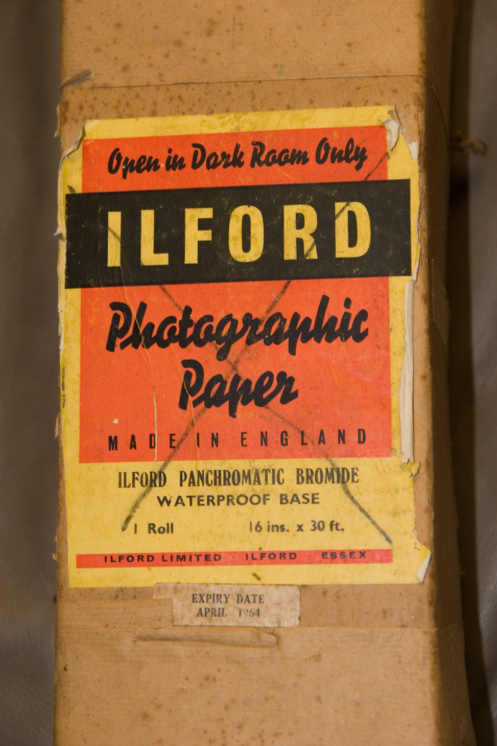

...imagine a panchromatic material that you could expose directly onto from your color film, process and then squeegee with pigment tissues. ..But in either case, you'd have to make sure that a super-coating didn't hinder the carbro reaction.
Here's just the thing for you: A roll of Ilford Panchromatic Bromide on a "waterproof" base - oops, it expired in 1964

Hmm, well heck, how badly fogged can it really be?? :laugh:
Do you know if folks ever did this; panchro b&w paper straight from original color neg, then off to carbro? Or is that exactly what this Ilford paper was for?

Yes, that is exactly what this paper was designed to do. Tri color carbro prints directly from color negs. Ah, those were the (brief) days...
