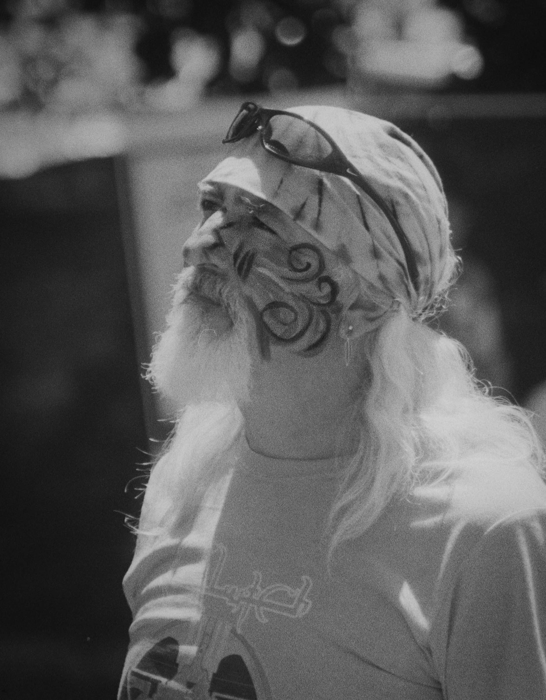

Adding to comment by BMbikerider about anti-halation layer of an emulsion and appearance of glow, the Fomapan films will sometimes produce a glow or aura in bright highlight areas. Some have speculated this is because the Foma anti-halation layer is less effective than those of other manufactures. The attachment is a scan of Fomapan 400, EV 320, 35 mm. The highlight area on man's headscarf is where the aura is more noticeable.

No need to remove anything with Fomapan 400 in 35mm.
Sample taken at EI400, developed in Fomadon LQN.
Shadows are pulled up quite strongly in post. I'll have to print that in the darkroom, one day. Still, while grainy it recoded more shadow detail than I thought on this high contrast scene. But some better antihalation would be nice.
