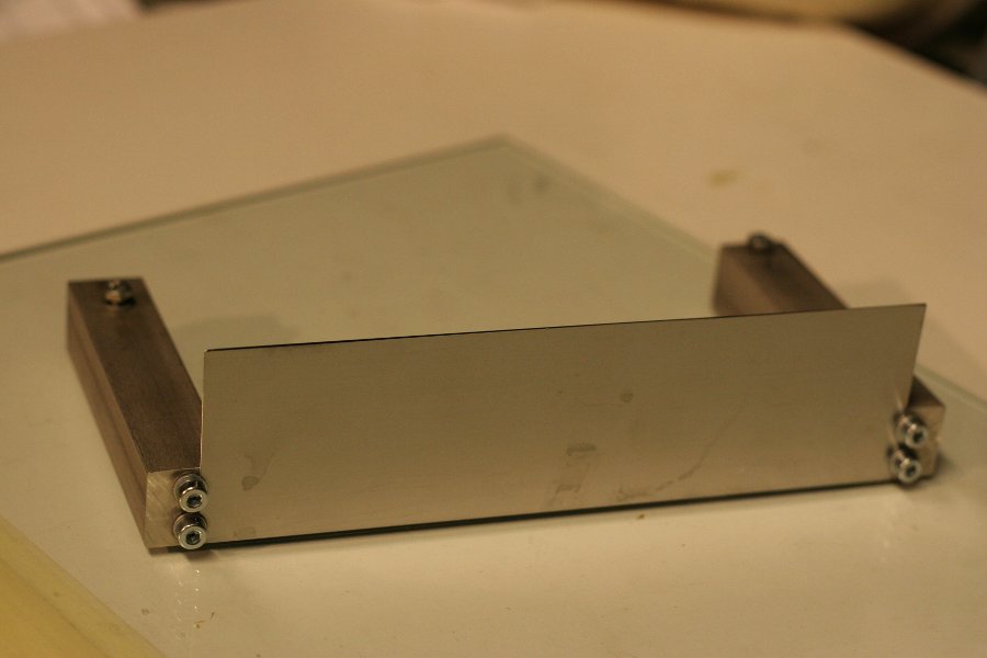

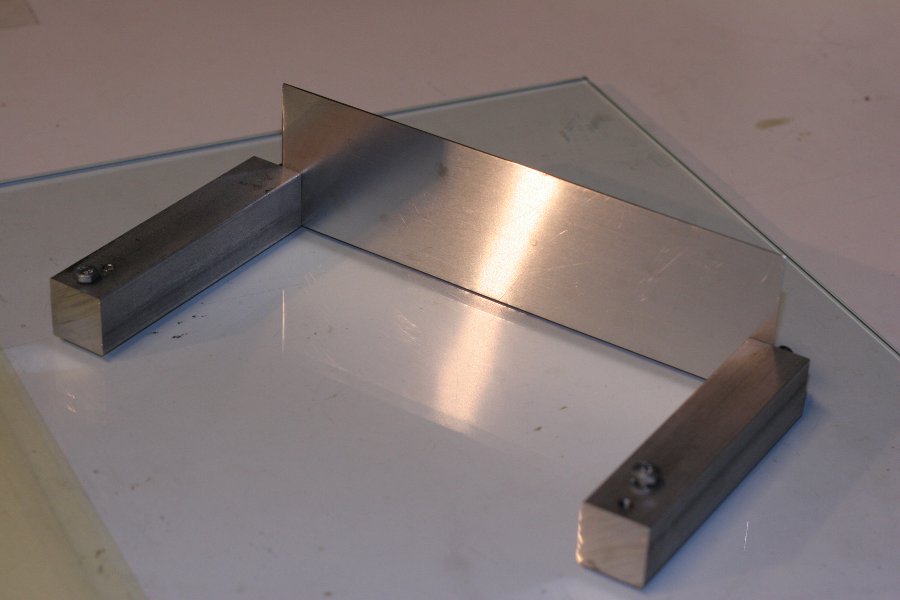

Our coating blade
Version 0.01
:cool:

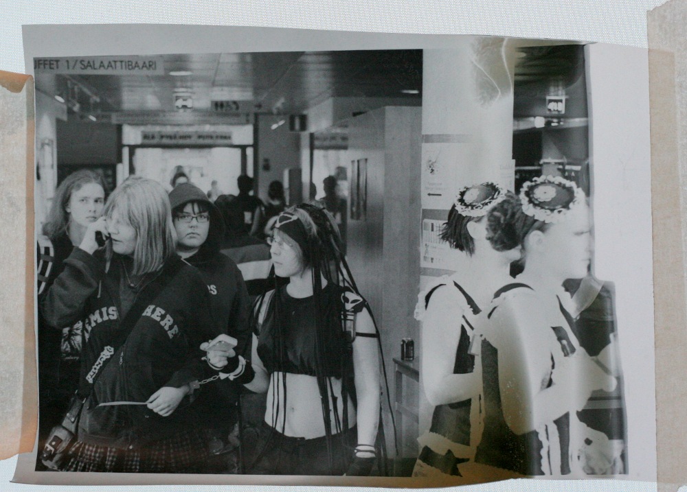

We tried coating this emulsion to a matte plastic sheet we have here (I don't know what it is. Probably some PET with processed, matte surface.) to make a kind of enlarger paper. It worked kinda well! First of all, the emulsion doesn't loosen off in processing at all (this is unharneded!), contrast is almost ok for enlarger use. This is maybe a stop or two slower than most enlarging papers. It looks quite cool when you have some light source behind the "paper".
Here's a digital photo of this print taped to PC monitor to give some light thru the print. Original negative is Fuji Neopan 1600, processed normally. On the right side emulsion was so thick that it took too long to fix, so I stopped fixing after 3-4 mins. It seems that very thick emulsion results in a bit slower speed and more contrast, and more glossy surface.

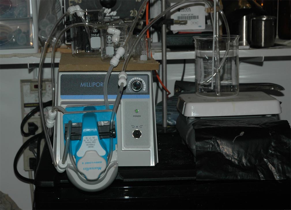

Pumped make with 1 silver and 2 salts + dopants
Here is a setup I am constructing for a high speed make.
It is taking a lot of white light rehearsal before I commit!
The blue objects in the lower left center are the two pump heads. Above them are the beakers that will contain silver, 2 salts and dopants. On the right is the temperature controlled hotplate with mixer.
Note the creative use of clothspins to hold tubing. :D
Out of frame in the center is a burette holder for my burettes so that I can add additional solutons at a given rate.
I am at present working on the electrodes needed to insure that I am at the right vAg for this high speed make. I am going to attempt ISO 400 but who knows.... :sad: The phase of the moon might be wrong.
In any event, your results at the start are better than mine. I came out of a million dollar lab and tried to do it on a shoestring. When I finally came to my senses, I did a major revision of my operating procedures and now am moving ahead one step at a time from basics.
Congratulations guys.
PE
I hardly noticed the clothes pins :D but I did see some plastic connectors!
At least 2 types, (180 and 90 degrees)
Seems you use the 90 degree connectors for the supply vessels but not for the kettle.
Is that by design or just coincidence?
(Do you like them, any pro's or con's? Are they top-heavy?)
What are the 180 degree connectos for?
Ray
Photo Engineer
Apr 19, 2005
29,018
Rochester, NY
Ray;
Looking again, I see that the clothes pins were cropped out of the photo when I resized it.
I use the connnectors to join segments of tubing and nothing else. The tygon tubing used for peristaltic pumps is extremely expensive running in the range of $100 / small package of 25 ft or so. The other tubing may cost under $10 for the same length but will not work with peristaltic pumps.
As for the 90 degree connectors, just a whimsical way of turning a corner? After all, the setup is not completed yet. But, I found that the 90 degree connectors allow rapid positioning and movement between beakers on the input side, but on the output side the clothes pins allow accurate and rather permanent positioning to be made. So....
PE
