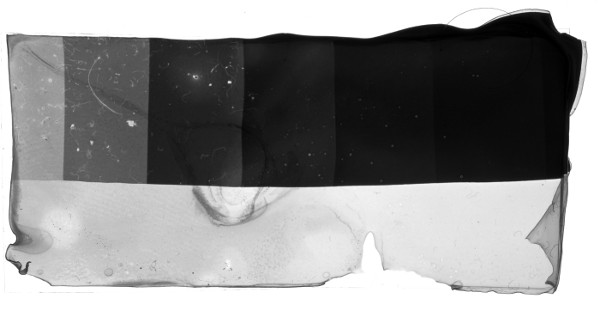

Oh yeah, made a new coating with sulfur-sensitized stuff and adjusted the blade gap to make a thicker coating. The problem really was too thin emulsion, I think:
We were afraid of too thick emulsion because of too low gelatin at first (which made coating thick difficult) and because of huge weight of the wet emulsion. But of course it loses water when it dries and starts to resemble normal film! The first coatings indeed were almost transparent even before processing.
Not tested the ISO yet (we let it dry first) but now the Dmax seems something like 2.0 rather than 0.1! Maybe the sulfur sensization helped too but with this coating I really see the difference between thin (very low Dmax) and thick emulsion. Now the fully fogged test strips also develop faster to Dmax, 20 seconds in Dektol 1+2 rather than 2-3 minutes. Sulphur?
Oh la la!
I'll post the results...

Yeah. I actually bought these OHP films to use them as animation cels (that's an another interest of mine :D) -- tracing the line art and them painting them in acrylic, and then film them in 16mm. I built an animation stand for that. That launched my interest in motion picture film, MP film processing, film processing in general and that way I was suddenly interested in making some film. Now I've almost forgotten the animation :rolleyes:...
Overhead projector films you can get from most sellers are for laser printers (less expensive) or for inkjet printers (much more expensive). Both of them have a special surface that helps the toner or ink to adhere, and, in addition, they discolor in no time. The mat surface lowered the contrast too much for animation camera work so I had to find a cheap alternative with no surface treatment.
It took some effort to find these traditional, cheap "hand-writing" films with unprocessed surface. But it's probably not acetate, it's harder (like polyester). If they are really polyester, I'm lucky.
One source for cellulose triacetate sheets could be Chroma Colour. They sell animation cels that are triacetate:

It works
Yeah, now it works. Problem was way too thin coating. Now we get the same speed, about ISO 10, with all three emulsions with different hypo content, probably because we forgot the heat treatment after adding the hypo (it was just 2-3 min at ~40C). Fog is low and Dmax is high, contrast seems very good. I'm very happy about this emulsion!
But, the emulsion doesn't adhere to film base. It loosens in processing or even before. We have no hardening yet because we couldn't find a quick source for formalin, glyoxal or chrome alum but I think that's not the only problem. Maybe we need a better base or a subbing layer.
I attached an example. I dropped this one on floor (emulsion down, of course!) before exposure, that explains the white dust :D. Emulsion was loosened as you can see. But, the contrast and speed are OK! This one is in fact the not hypo sensitized one.
Big thanks PE and Ray for tips!

How I "measured" the "about ISO 10":
I adjusted the enlarger light to approximate sunlight (added some cyan+magenta) so the comparison would be "fair".
Then I exposed my step wedge film (I have made it before on BW film) to Agfapan APX100 at a specific exposure and processed in XTOL 1+2 for 3 mins.
Then I opened lens three stops and exposed my film and processed it in the same way.
After processing, I noticed that the lowest density wedges on my film and APX100 match quite closely. And, because I opened lens three stops, it's ISO 12,5. Very precise :D.
Emulsion
Jan 25, 2007
138
Australia
Med. Format RF
Hrst,
Great results! Thanks for posting your process and results, keep up the experiments. Inspiring!
