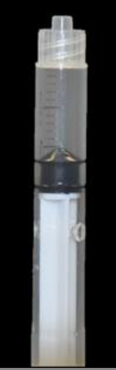

Making and Using a Kodak Photo-flo Stock Solution - A convenient way to ensure the right concentration of Photo-flo
I always find it challenging to mix up small quantities of the 1:200 dilution prescribed for Kodak Photo-flo (the standard stuff - not the extra concentrated 1:600 stuff that labs use). If I'm trying to mix up 300 ml of working solution, I don't have a good way of accurately and repeatably and cheaply and easily measuring the necessary 1.5 ml of the concentrate. And I'm reluctant to solve the measurement challenge by mixing up larger quantities of working solution and keeping the unused...

Photoflo does not harm plastic or rubber, seems to preserve it in fact. So a ten-cent syringe like this can last years. Mine is about ten years old and the rubber is still pliable.
...cheaply and easily measuring the necessary 1.5 ml ...
1.5ml is a common measure in some settings, so special syringes with a stop at 1.5ml are also available for pennies.
