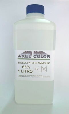

Ammonium Thiosulphate is available in most countries, usually as a 60% solution, it's used outside the photographic field in agriculture, also gold and silver extraction. But you need to buy it in large IBC containers, or even tanker loads. There's no-one I know of in Europe repackaging in smaller volumes, The Photographers Formulary do, I think, in the US.
The crystals are slightly deliquescent (absorbs water) so it doesn't store well particularly once opened, For this reason it's expensive in crystal form these days. I can buy 500g for £58 ($67) here in the UK. That's uneconomic, it would be a bit less if I still had an account with Sigma Aldrich.

The place I ordered it last from currently lists it for € 10 per kg in small quantities and significantly less than that in larger quantities. The more expensive source of the two I use from time to time currently gives a price of a little less than €30 for a 500g tub.
I've done a little rooting around and several firms here offer liquid ATS (essentially just 60% ammonium thiosulfate solution) to farmers. Officially they don't retail to consumers, but I'm sure that if I tried hard enough and placed a few phone calls, I could get some of the stuff for personal use one way or another. It would only make sense to aim for 100l or so this way; otherwise it's not worth the hassle.

If you want a fast fixer and Ammonium Thiosulfate as raw chemical is too expensive, I can think of three ways:
  1. The by far cheapest and easiest way to get a really good, stable and cheap rapid fixer is ordering color fixer for minilabs, such as this one here. Get a stash of Ammonium Thiocyanate, if you want to pep this fixer up even further. This fixer is far cheaper than any batch of Ammonium Thiosulfate offered to us mere mortals.
  2. The second cheapest method would be mixing a quick fixer, i.e. one from Sodium Thiosulfate and some ammonium salt. I have a formula for a quick fixer based on Sodium Thiosulfate and Ammonium Chloride in the articles section. You can get even better speed, if you mix Sodium Thiosulfate with Sodium Metabisulfite, Ammonia and Acetic Acid. These fixers can get as fast as commercial rapid fixer, but their cxapacity will be weak due to large presence of sodium ions.
  3. The most complex way to obtain Ammonium Thiosulfate would be from Sodium Thiosulfate and Ammonium Tetraborate, the latter of which you can create with Ammonia and Boric Acid. Since Sodium Tetraborate is much less soluble than Ammonium Tetraborate, you should be able to precipitate significant amounts of Sodium Tetraborate, giving you a mix with much more ammonium than sodium ions in solution.The resulting ratio between Sodium And Ammonium will probably depend on temperature. It may work even better, if you can create solid Ammonium Tetraborate first.

I understand you want to minimize costs. I think several realistic options have been offered. I personally couldn't do better than what's already been suggested:
1: Search until you find a cheap source of ammonium thiosulfate locally, possibly only if you buy a somewhat serious quantity at once (more than 25kg)
2: Order ammonium thiosulfate elsewhere in Europe and have it shipped. Again, you might have to accept a large MOQ (minimal order quantity) to make it economically feasible.
3: Use the cheapest source of ready-made fixer available to you, which is nearly certainly C41 fixer.
4: Accept that sodium thiosulfate is very slow and/or has limited capacity and keep using that, whether in combination with an ammonium salt to speed things up, or not.
I guess that about sums it up.
What is NOT feasible is synthesizing the stuff yourself in an economically viable and safe way.
