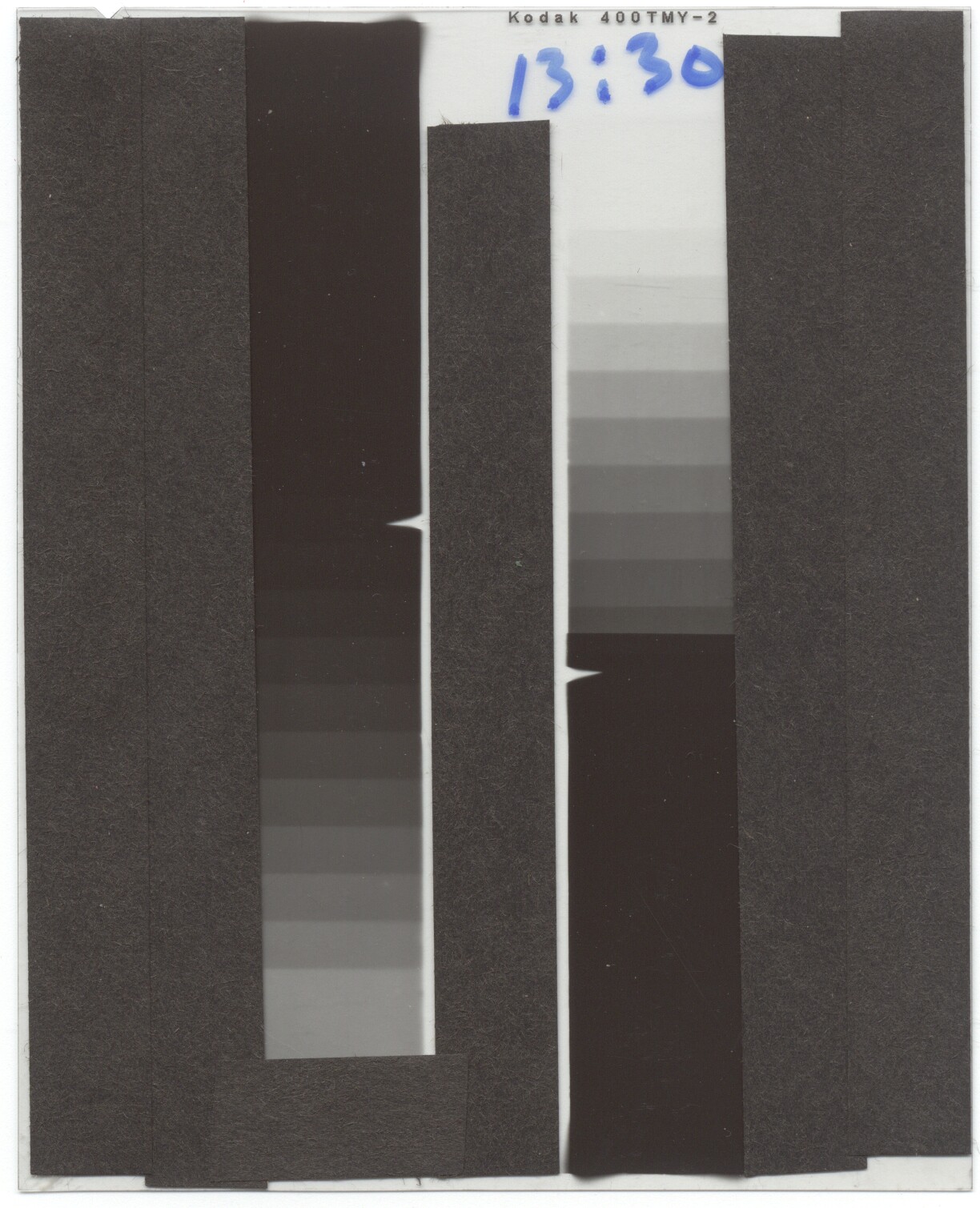

I start with a step wedge, and I use it to expose a test strip on film. Then I develop that film normally. In my case I had plenty of test negatives to work with so I chose a step wedge negative that was developed to 0.58 Contrast Index (CI).
I "masked" the the negative with black paper tape to cover up much of the clear areas, so that I don't overwhelm the print with flare.
Then I put the negative in my enlarger, at the usual height for making prints, and exposed a print.
This print is a step wedge, but it's not a first-generation step wedge. Instead it's a print that includes the film characteristics and the paper characteristics. It almost reflects the whole Tone Reproduction Cycle (except it leaves out flare).

Here is what the test negative looks like (the negative I put in the enlarger to make the Zone Ruler).
The strip on the left-hand side is the one we focused our attention on. The one on the right-hand side that looks like it was divided in two was done with an ND filter so that I could reach deeper into the toe for the film graph. But I will be using the complete strip on the left-hand side for the Zone Ruler.
0.57 CI Test Negative

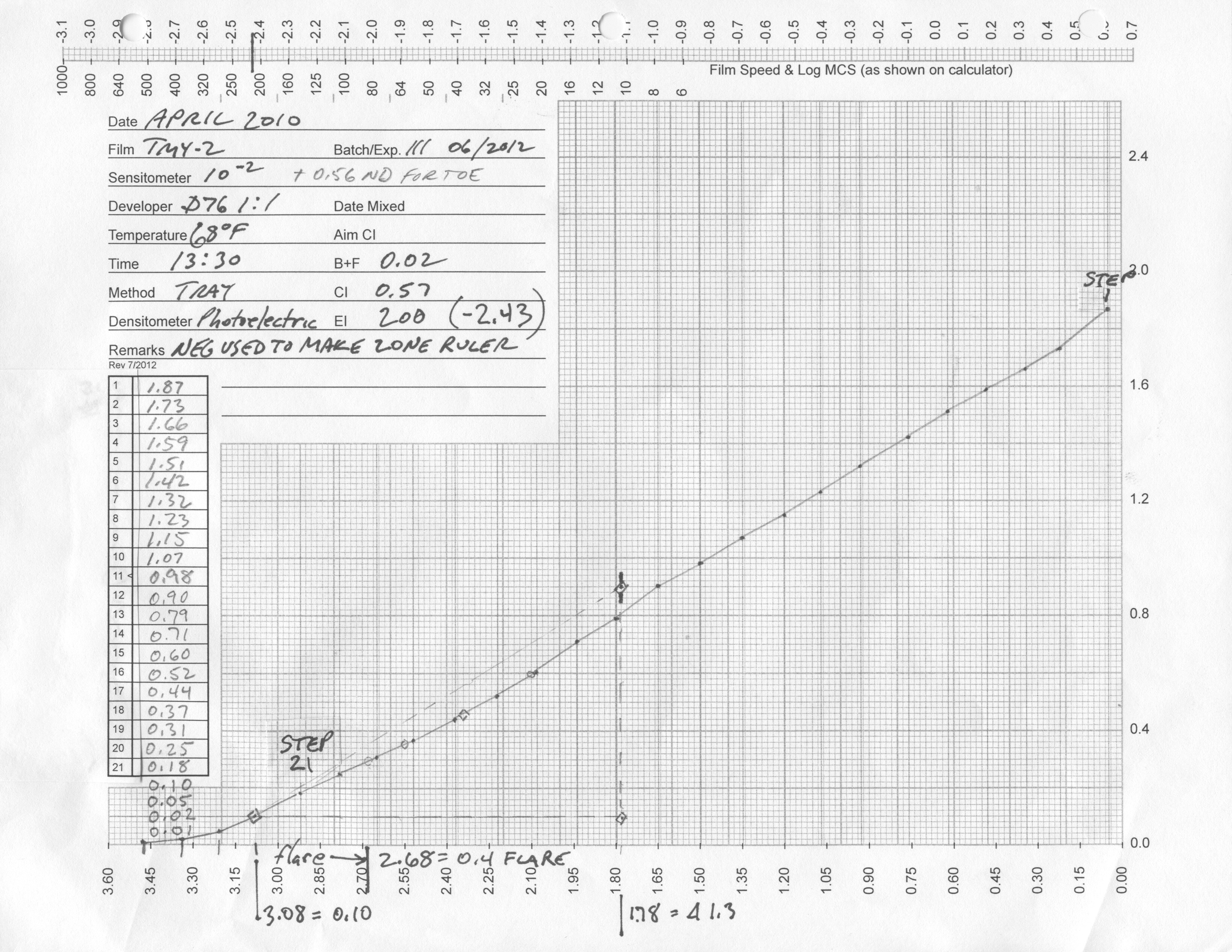

Here is the graph of the test negative with Steps identified and the planned corresponding Print Zones.
0.57 CI Test Negative Film Characteristic Curve

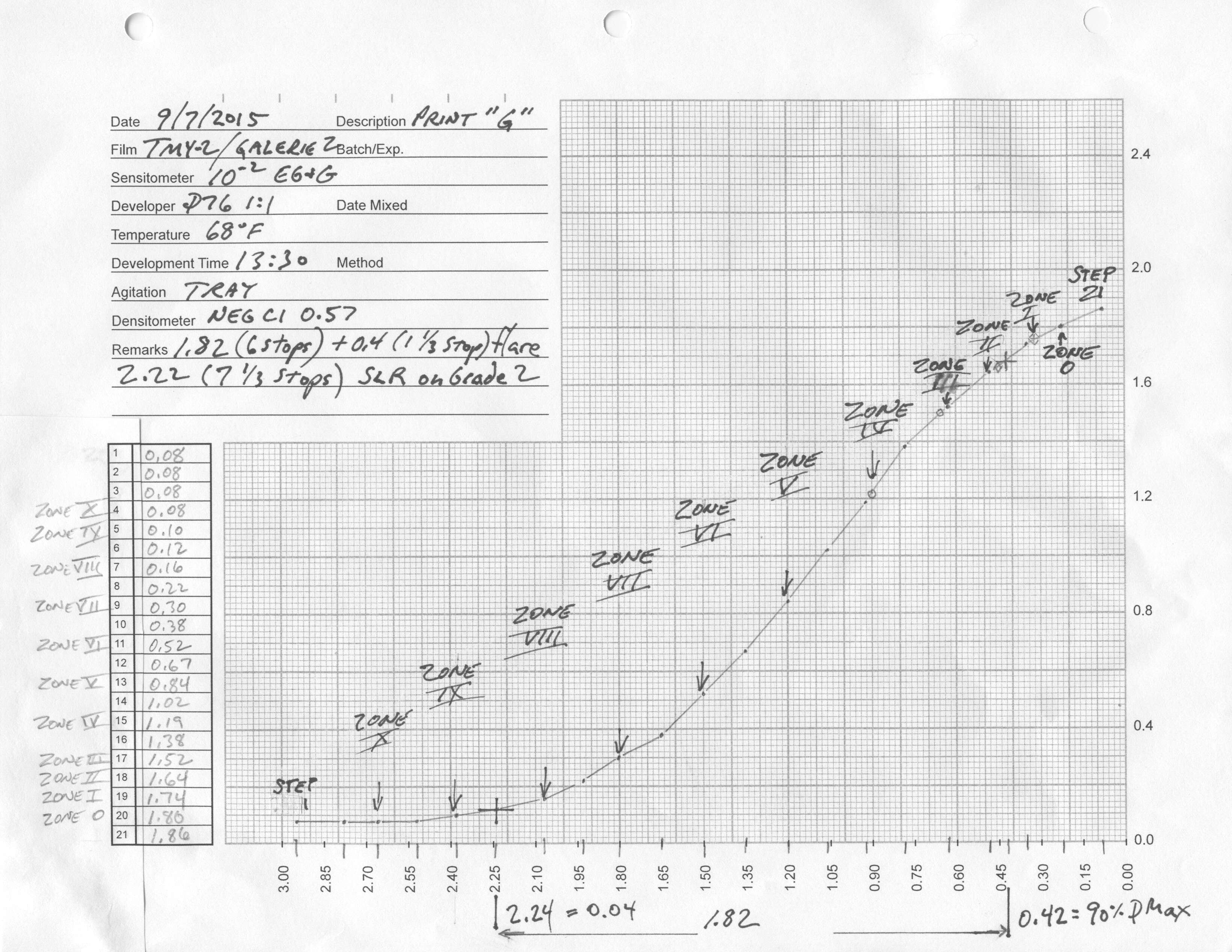

Here's the graph of the Zone Ruler print
Zone Ruler Print Graph

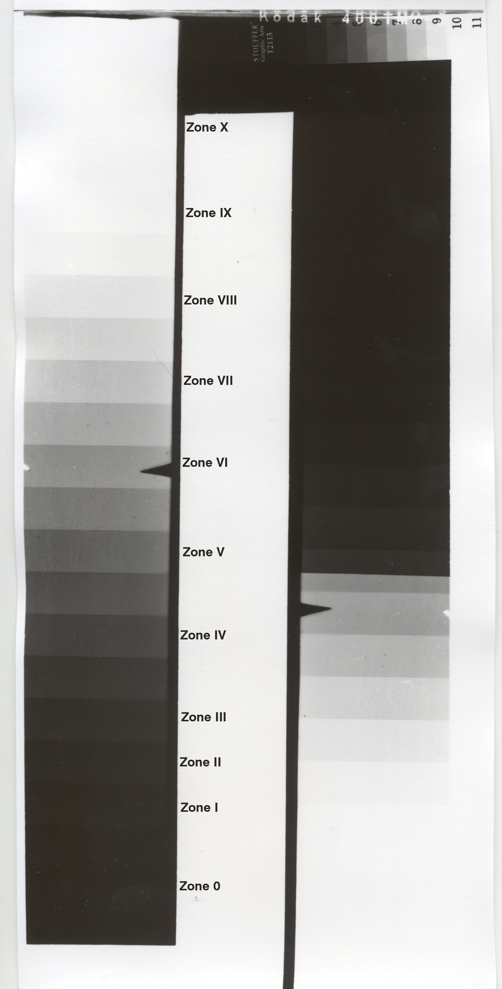

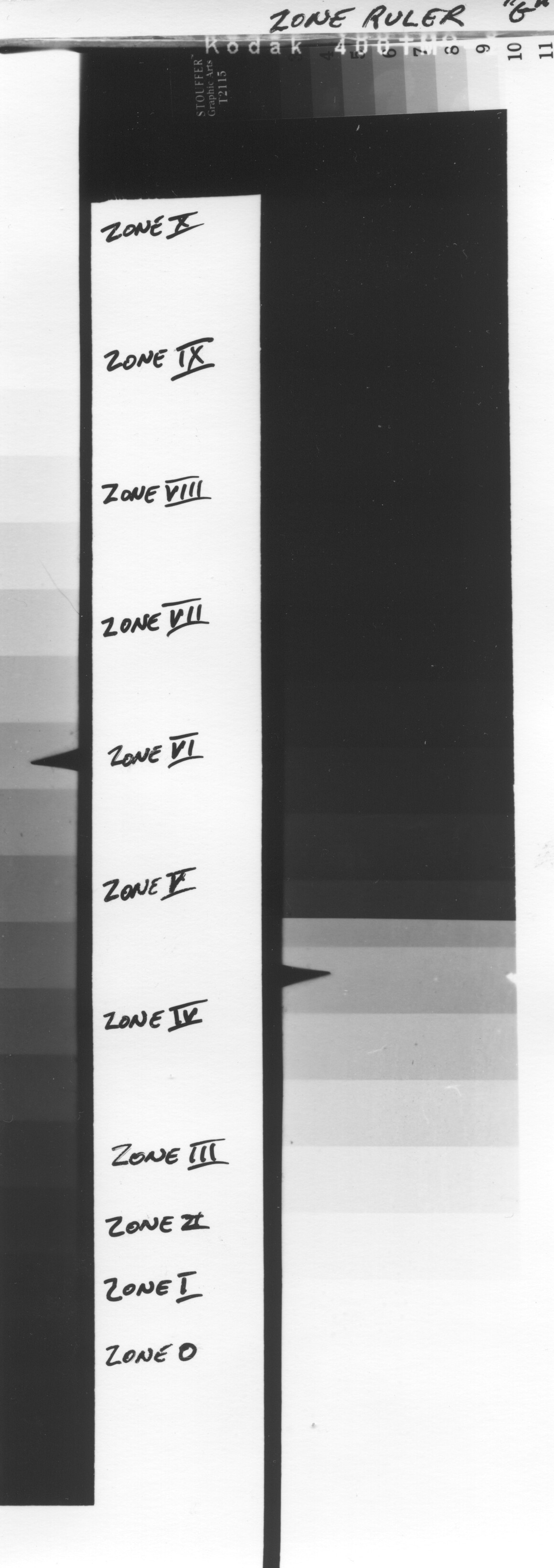

Here's the Zone Ruler raw print.
Here's the Zones marked out on the Print.
Labeled Zone Ruler Print

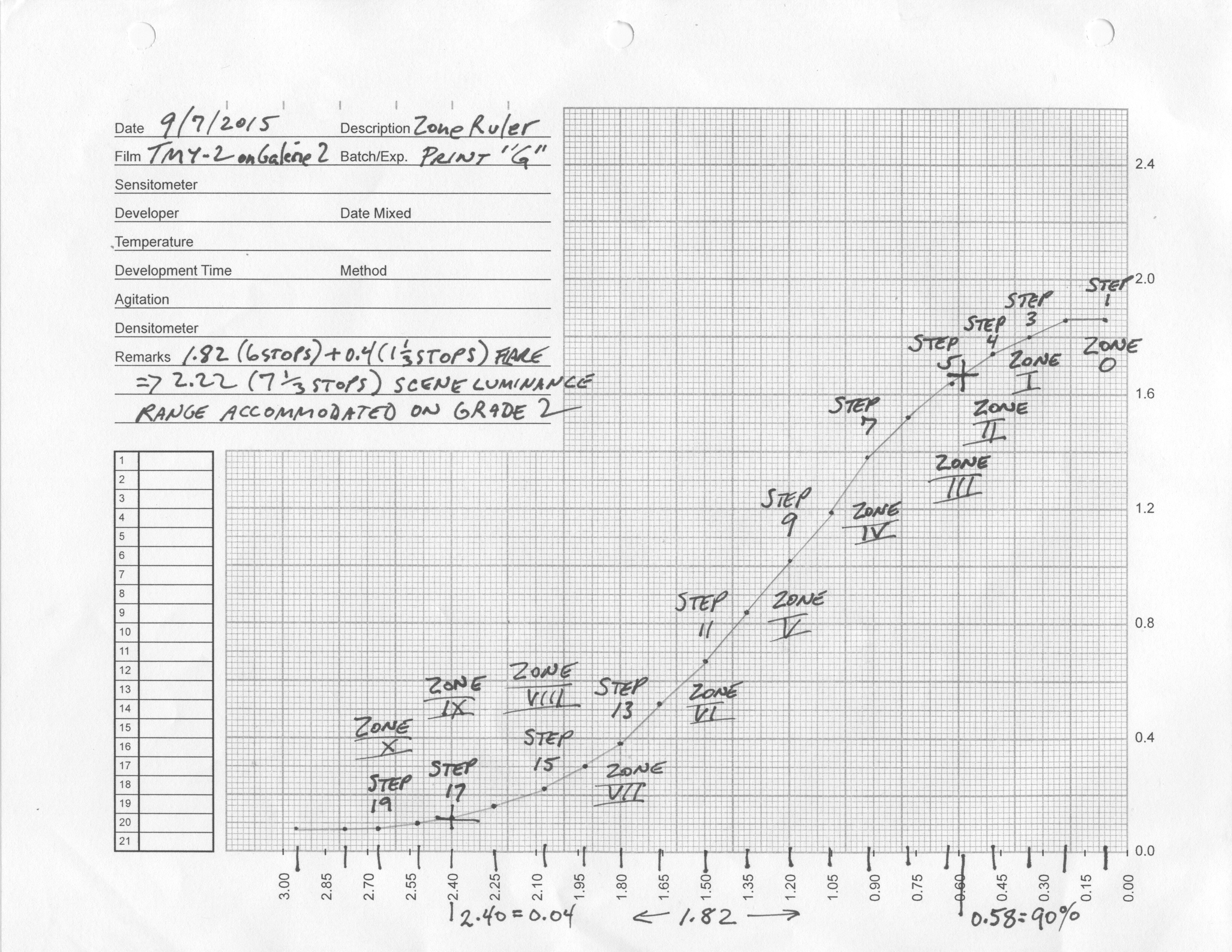

Actually it looks like I should take Step 8 here instead of 9. It's not "between" it's something that's better rounded to 8. And it's better to use the even series from 8 instead of the odd series from 9
But I've already drawn all the graphs with the odd series. So we have messy graphs that show my thoughts that I believed was correct an hour ago.
Also 0.003 flare for Zone 0 isn't exactly right either. Zone 0 would start with .001 mcs + .003 mcs = -2.4 log mcs so it's closer to Step 2.

Here's the latest correction, Zones marked out on the Print.
Labeled Zone Ruler Print v2
I've reworked everything today and will show the new results shortly.
Flare and the strong shoulder of the paper curve compresses everything in the shadows so that Zones 0, I, II and III are sequential from Steps 20, 19, 18 and 17. In my opinion, while the camera plan had seen 1 stop between each shadow zone, flare compressed the tones in the shadow so much that they are effectively a half-stop apart for the bottom four zones. The shadows are very compressed, there is little detail in the shadows. Note that film toe also contributes to the compression in the shadows but not nearly as much as the paper shoulder, (note, this is for TMY-2 which has a short toe).
I think that kind of behavior in the shadows is commonly understood. This exercise drove that point home for me.
Then for Zone IV, Zone V, Zone VI, Zone VI and Zone VII every other Step represents a Zone. That's as you would expect.
For Zone IX and Zone X the toe of the paper compresses tones again, there is so little separation that you really do need to be careful holding tones around Zone IX. They are fragile.
Though I computed a skip step for Zone X as Step 3, I didn't need to skip the step because the step right next to Zone IX, Step 4, is already paper white. This gives me a ruler made out of 7 print chips: Zones 0, I, II, III in one piece, Zone IV, V, VI, VII and VIII in individual pieces and the last piece has Zones IX and X.

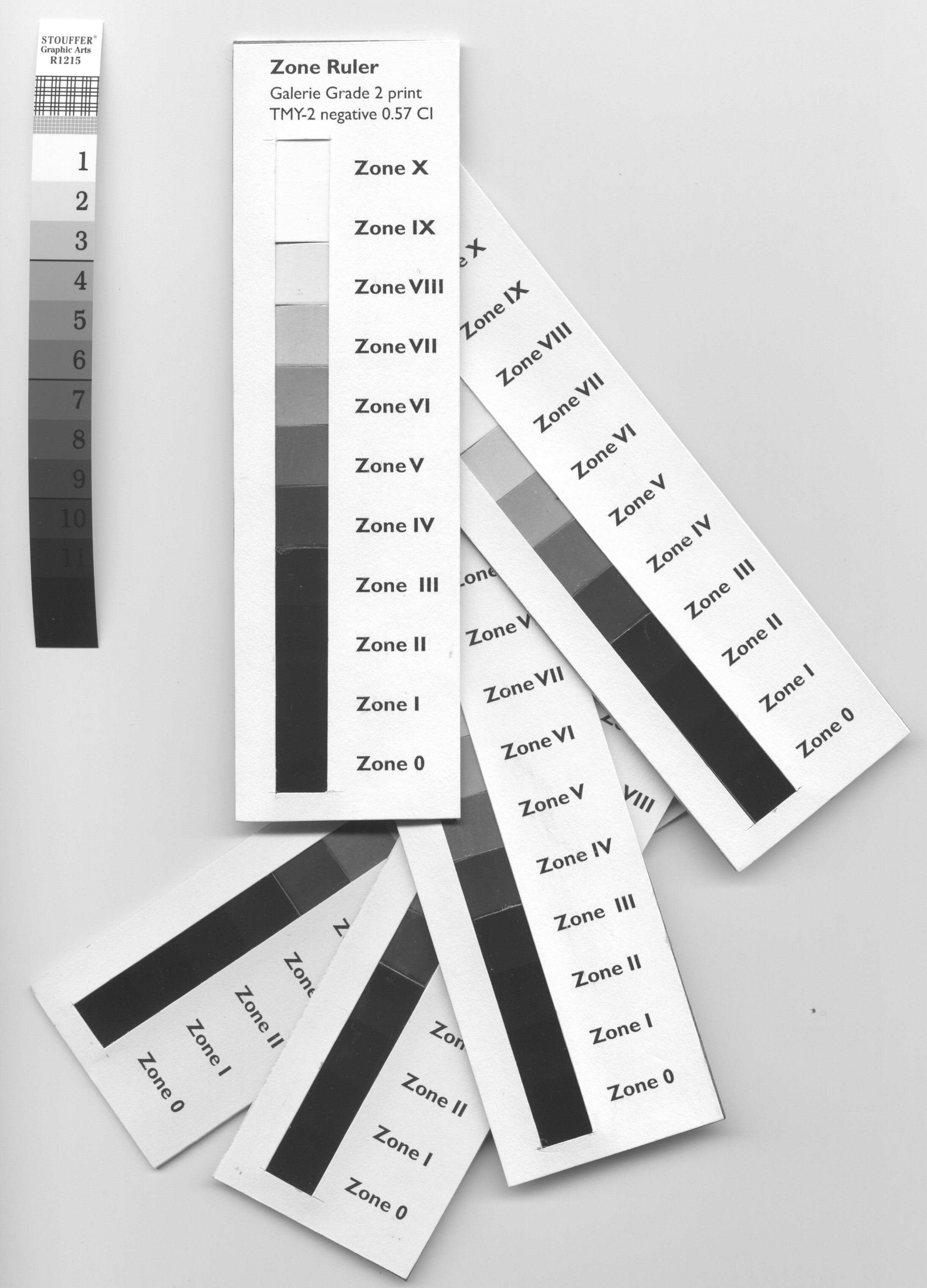

I've made 5 Zone Rulers according to this plan, since I'm pretty sure I got it right this time.
Here are 5 finished Zone Rulers.
They are shown next to a standard Stouffer Cameraman's Grayscale because they differ significantly.
While the Stouffer scale shows half stop steps in terms of reflectance...
The Zone Ruler shows how a metered Zone will appear on a finished print.
Mostly because of the S-Curve of paper, the prints that you get from any negative will not be stepped in the same way as a grayscale. There is compression in the shadows, and compression in the highlights. The Zone Ruler shows the compression that happens, so it helps you see...
When you place something on a Zone, what it might look like on a print.
Finished Zone Rulers

My previous negative graph was on old graph paper, and on that old paper I had a different estimate of how many meter candle seconds the EG&G sensitometer puts at the film plane. So I got out the current graph paper and all the "actual" exposure numbers had to be changed. But this didn't change the overall story. It just changed some facts.
(This is why it is important to know the amount of light that a sensitometer puts out: If I knew exactly how much light my sensitometer put out, I would have a graph paper that doesn't change every time I go to interpret a test result. But... I know what I've got. Sometimes I have to change things after my first drafts as I get a clearer picture of what's going on. Sure would be better with a better sensitometer. You go Michael R 1974. I am rooting for you to invent a good simple reference sensitometer.)
I have some explaining to do how I got from the graphs to the rulers...
Zone Ruler plan:
Zone I is at film 0.10 speed point at -2.43 log meter candle seconds (mcs) is 0.0037 mcs
This corresponds to a little above the speed of 200 for TMY-2. Although the film has a rated speed of 400, this negative was developed to 0.57 CI and is below the ASA requirements. So it makes sense that the Exposure Index for this negative is 200.
Speed point exposure, plus the assumed 0.4 flare assumed to be there at that point.
Zone I = -2.43 log mcs + 0.4 flare = -2.03 log mcs = 0.0093 mcs
0.0093 mcs (exposure with flare at speed point) - 0.0037 (planned exposure at speed point) = 0.0056 mcs flare at camera film plane.
Flare 0.0056 meter candle seconds... Gets used a lot in these examples because that's the overall flare light, so every Zone gets that much additional exposure above what you planned to give... In the higher Zones it doesn't matter that much so after a few Zones we can stop calculating it.
Zone I on the bottom scale shows planned 3.08 moved -.4 to 2.68 with flare (The bottom scale is a step wedge on the film plane, so on the bottom scale numbers go down as less gets in the way of the light making it brighter. The top scale is Log MCS and they are negative log numbers because they are small numbers that become less negative as you get brighter.)
Zone I with flare, Print Reflection Density is 1.76
Step 19 Print Reflection Density is 1.74. Good enough.
Zone I = Step 19
