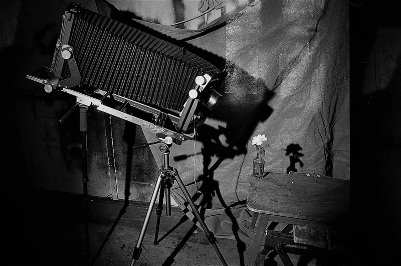

It is. Equal to the mass of a small asteroid. Actually I have the Orbit C-1 in black, needs two tripods to use.
Aw, maybe that's exaggerating a little? Unless you have a very large lens hanging off the front standard. But then again a two tripod set up would be extremely steady I suppose. I have the Calumet Green Monster in aluminum- someone here mentioned 14 lbs, sounds about right. With a lens and holder it's probably up to 20 lbs. I usually use a Gitzo 1570 head which seems adequate.
I have some more heavy duty tripods now, but this is an earlier set up.
