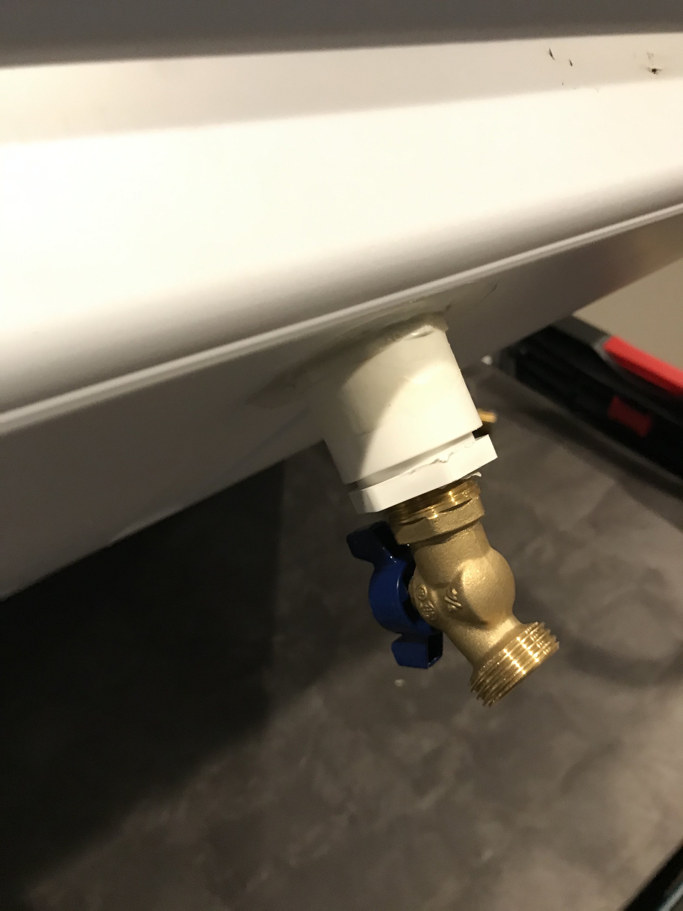

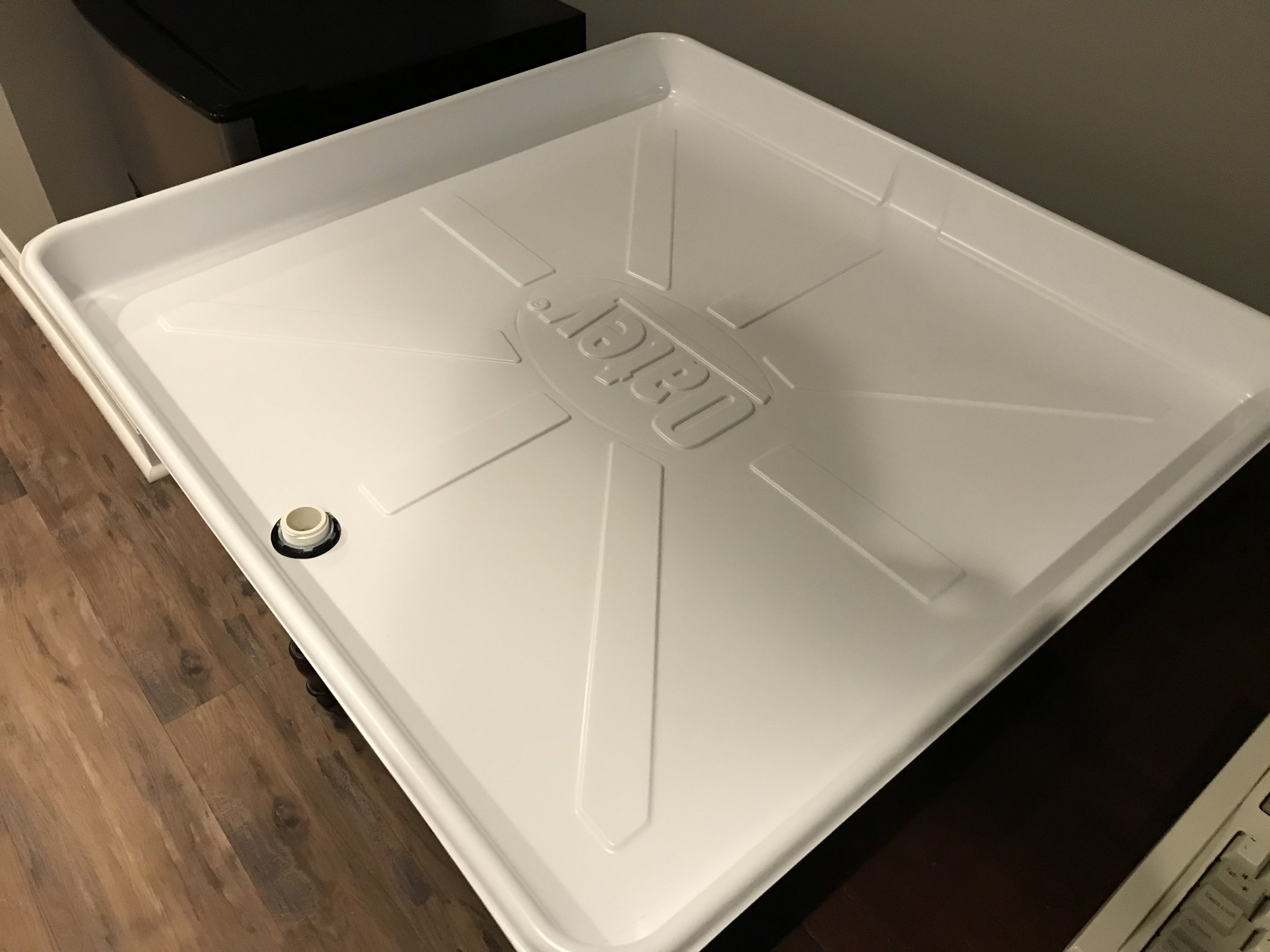

Much more affordable - made 3 of them for up to 30" prints using spill pans and a few PVC pipe parts:

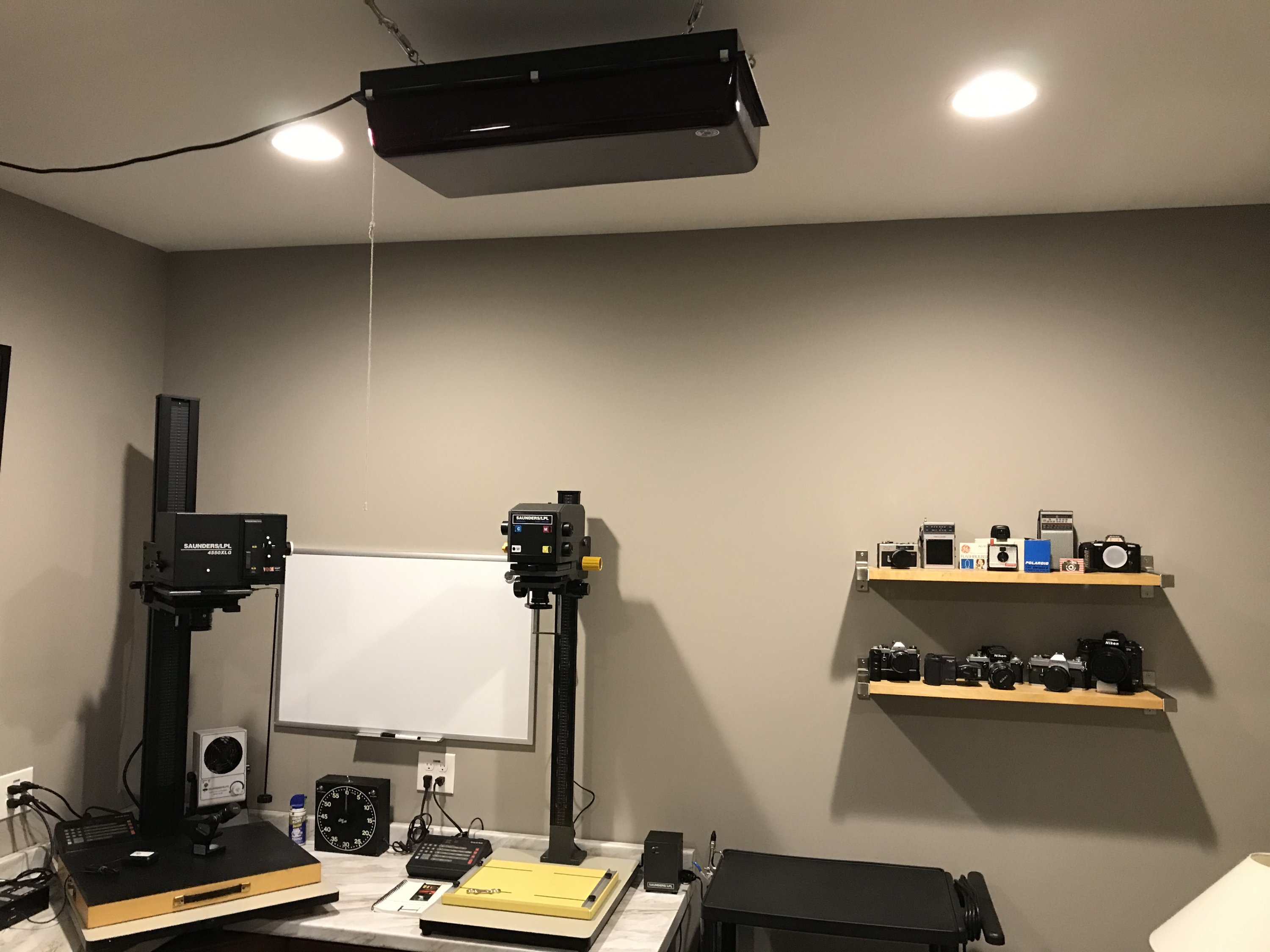

Also finally hung the nuArc DBL1325 17x24 safelight - it was a challenge mounting it to the ceiling (difficult joist spacing) but it's now up and operational.
Never even saw such kind of pans over here, but it might be something to consider.
I would have put the outlet as far into a corner as possible. And I would have tried to find a threaded stud that can be cemented to the pan, so that the outlet would be flush with the bottom.
The rather classic alternative is laying PVC foil on the ground and place 4 slats in square under it. But emptying would mean using a bellows or so pump added by a sponge.
Yah, I have a batter powered siphon stick as well - I need to trip the excess threaded stem for sure.
