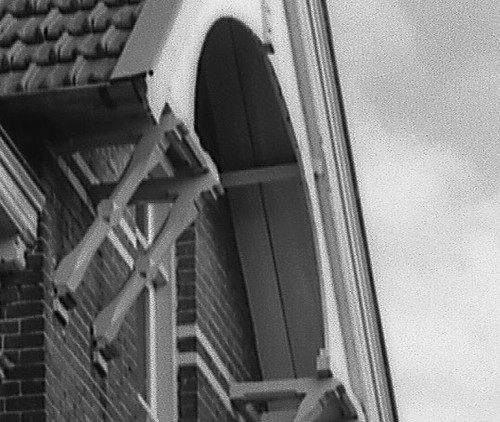

Well I just managed to post some results in this threat directly:
Ravenstein, the Netherlands
Rollei ATP-V1 Technical Pan
SPUR Imagespeed 1+14 5:30 min
Stop S-10 1+19 0:30 min
Fix X55 (Acid) 1+7 4:00 min
Wetting agent Rollei 1+3000 1:00 min
A very small part of the 35mm negative:
Rollei ATP-V1 Technical Pan in Rollei Low Contrast (R.L.C.) 1+5 6:00 min. Small part of the 35mm negative.
Results made by Epson 3170 (3200 dpi) scanner only.
ATP-V1 - SPUR Imagespeed: E.I. 32 (+)
ATP-V1 - R.L.C. : E.I. 25
What would be the result of this Rollei TP film in Technidol ?????? :cool:
