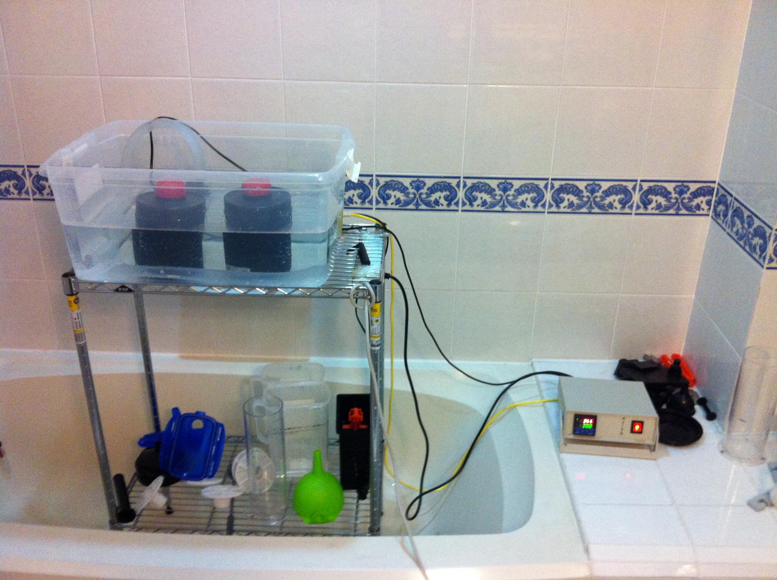

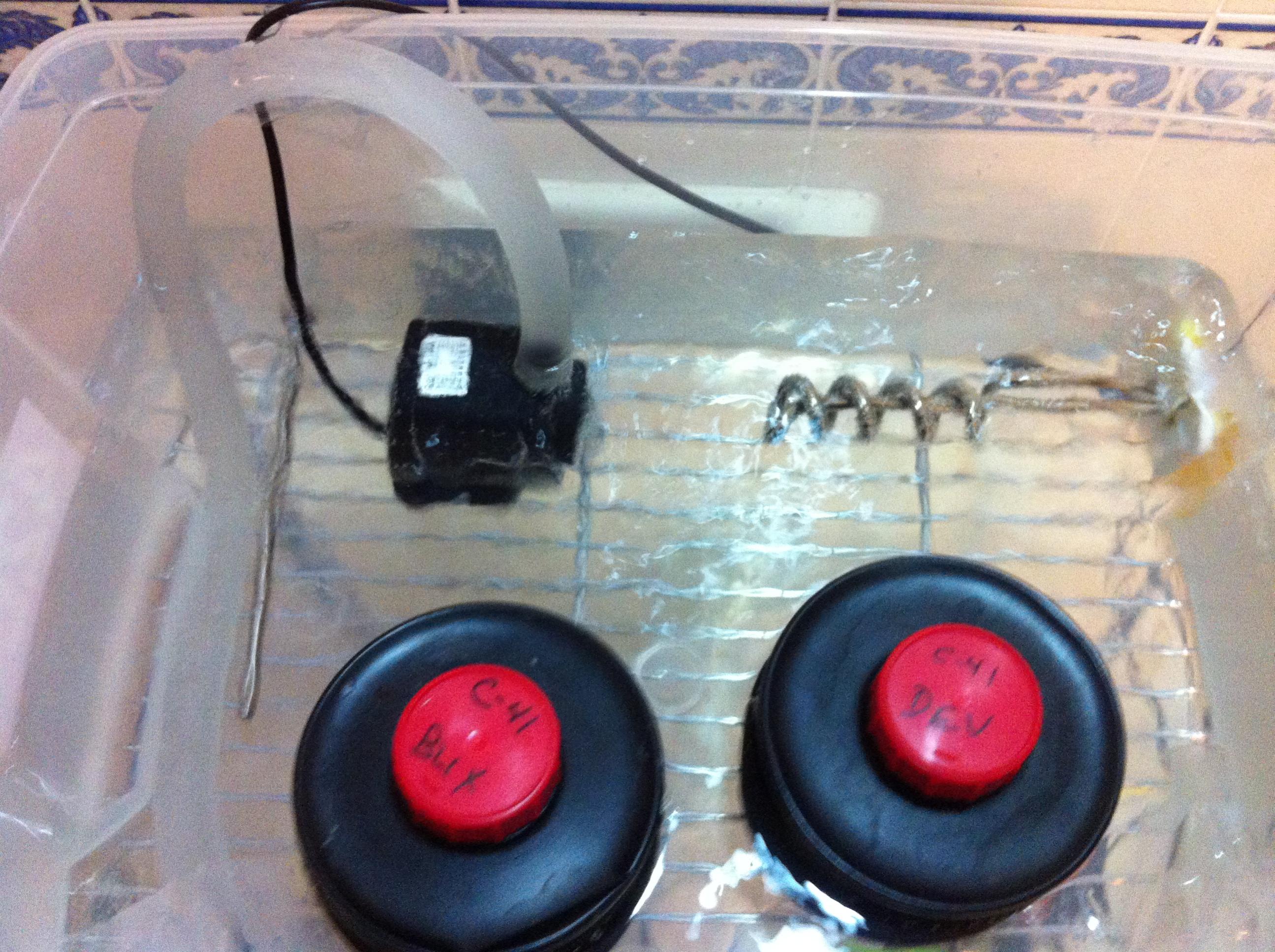

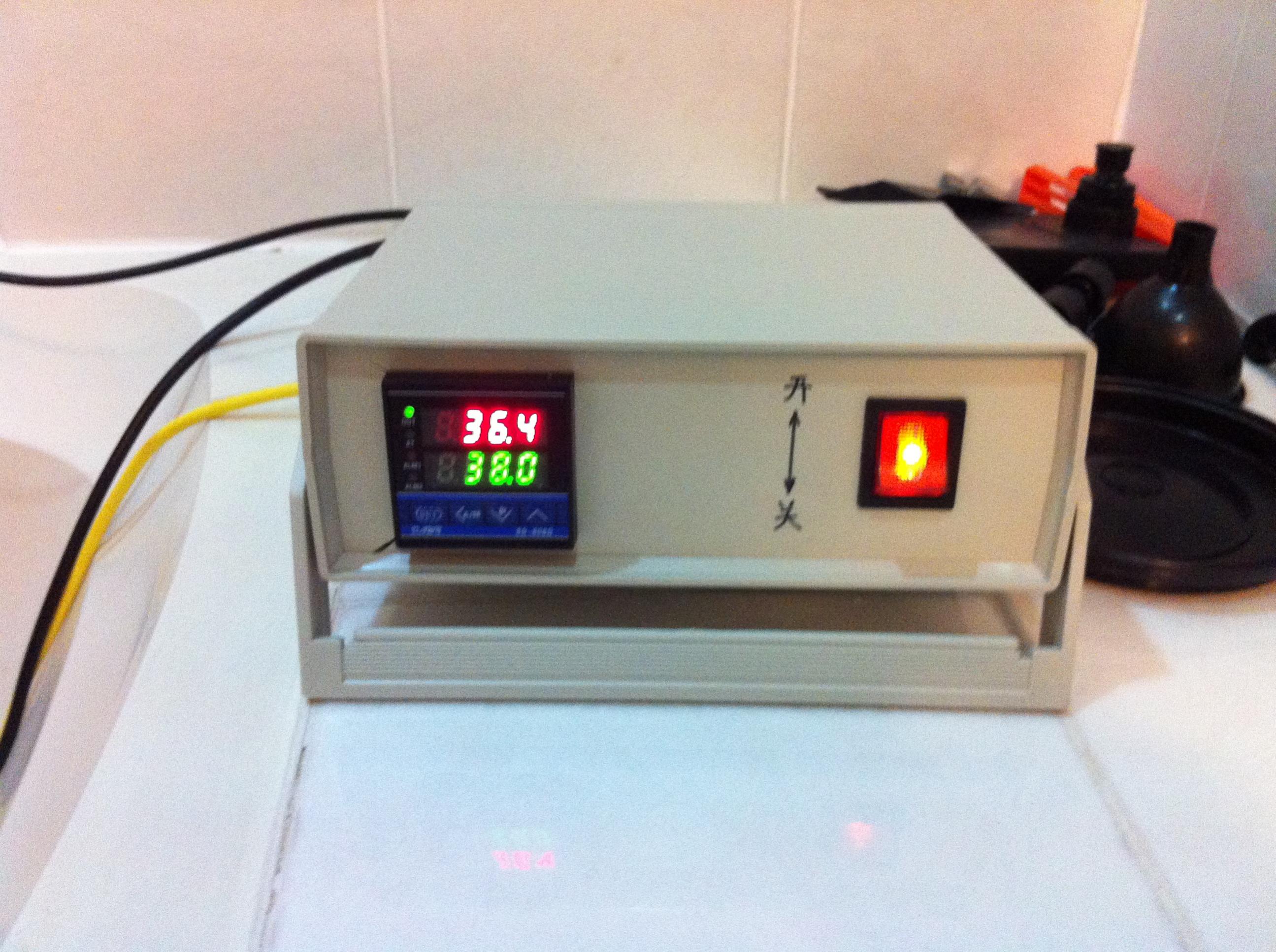

I have always wanted to build one of these systems, and just finished my first one. I have a plastic storage bin bought from the local home supply place. I found PID controller on the Chinese online shopping site (www.taobao.com) with temperature probe, already assembled into a little box with power switch, power cord, and switched power socket (controlled by the PID). The whole setup, including an immersable water heater, cost me less than $50 US Dollars (I bought it in China, where I'm living. That's the converted cost). With a system like this, you have to keep the water moving. I used a medium sized submersible aquarium pump, which cost about $10 USD, including a good length of tubing so that I could route the flow properly.
Here are photos of the finished device:
It works like a champ, temperatures stay within .1 C very consistently in the bath. All for well less than $100 US. It took an evening to assemble.

The probe has "Cu50" on it, the rest is Chinese. The SG-808 calls for a "PT100 Cu50 Jpt100" at the appropriate connection point. So, I'm guessing it is a PT100 or compatible sensor.
The instrument box it is in is obviously some off the shelf generic thing, as you'll note the labels (see the on off switch) are hand written, and the PID is somewhat loosely installed. But it works perfectly. I did have to calibrate the probe (a setting on the PID). The factory setting is no adjustment, but mine was reading about 2.5 C too high. A simple adjustment got it to the exact same reading as my regular .1 C thermometer, across a variety of temperatures.
The PID controller is amazing. There is no hunting for the temperature, you set what you want, the temperature climbs up and just stops on the temperature you set. It does take a while to pull the chemistry up to temp in the bath, as one would expect. I could preheat the chems in a microwave, if I was in a hurry I guess. Or, I could start the bath at a high temp to pull up the chems. But it is simple enough to plan ahead, start the bath, put the chems in, and come back later when everything is at the right temperature, same as I used to do with the Jobo.

For the tank, it is a simple plastic storage bin from a home supply place. To get the heating element in, and supported horizontally, I made a large hole, cut a chunk of plastic (out of a plastic cutting board, about 1/4" thick) to reinforce the mount, glued it all in place, and then sealed it with silicone sealant. The result is that I don't need the water to be very deep to fully cover the heating element. Do note that these simple heaters will burn out almost instantly if powered up in the open air, so they must be under water. The downside to my system is that if I do burn it out, I have a goopy mess to cut through to extract and replace it.
The design on which I based mine had the heating element going in vertically from the top, attached to a separate unit that would clamp onto the bin. I didn't like that one, because it required the bin to be filled with water nearly to the top. If I'm using the Jobo 2509 (?) tank to develop sheet film, the water would be too high. I did consider it, and considered putting in a little submerged platform just for that tank, but decided it wasn't worth it. Better to mount the element low to begin with.
The size and depth of your tank depends on your need. If I was doing tray based processing, I'd construct a much larger container for the tempering bath, and build some sort of submerged shelf or platform for the trays, so that while the water would be deep enough for the heating element, it wouldn't be too deep for the trays.
(A larger volume might require multiple heating elements too.)
