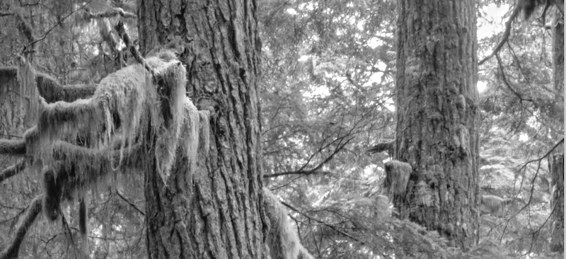

I'm confused.

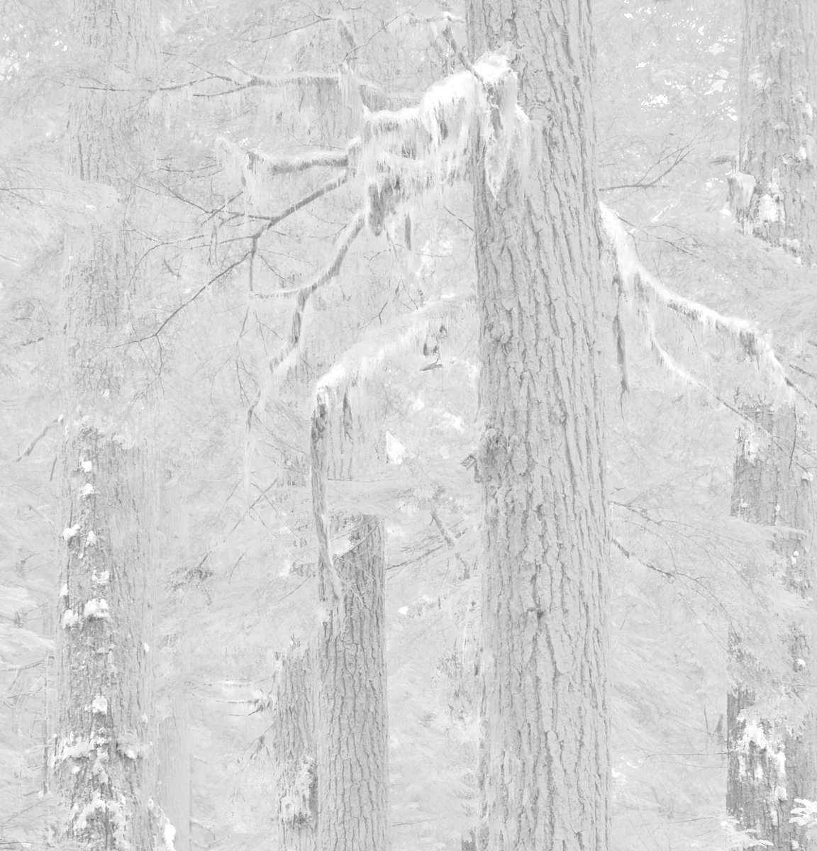

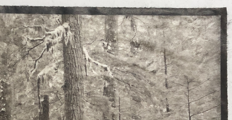

The images below are a Capture One screen shot of the top portion of a photo and an Argyrotype.
In Capture One, I've brought down the larger sky areas between the trees to about a Zone IX 1/2 print value (RGB 240) and the moss on the larger branches is RGB 181 so should print as a Zone VII+ print value. These RGB to print values have been confirmed by printing step tablets.
For some unknown reason the mossy branches are blown out and the sky is where it should be when the Argyrotype is printed. Weird.
I export the edited B&W files from Capture One as 16 bit TIFF's to a folder on my MacBook, then send them to QTR's Print Tool to be printed as negatives on an Epson P600.
Epson ABW mode is checked.
Black point compensation is checked.
Generic Gray Gamma 2.2
Relative Intent
Print Tool Managed. (This might be where the issue is?)
In Capture One, I used the green & yellow sliders to lighten foliage lower in the photograph...somewhere in the background, are these being added again so that they become textureless and blown out?
Using perpetual license Capture One 22 and Luma Curve for the Argyrotype adjustment curve.
Colour editing done in RGB 1998.
I'm not sure if I see what you mean. What I see in the snippet of the argyrotype included in your post is a severe compression of the highlights and upper midtones and possibly fogging, so it basically all bunches together into unseparated tonality. The background of the branches against the sky shows very distinct separation in your digital version, but on the actual print, it's all very closely spaced tones.
I would expect the main issue is either in the printing process, which may not yield good highlight separation due to fogging (e.g. parts of the sensitizer not washing out well), and/or problems with the adjustment curve (i.e. not linearized well for this paper/process combination).
PS: I've taken the liberty to include something about the lack of separation of highlight tones in the title of your thread.
Perhaps this is some kind of proximity effect - i.e. bleeding of the surrounding darker areas into the highlights. I have seen it happening in cyanotypes. Not sure if that is a thing in kallitype or not, but presumably during development, some of the Fe(2)'s flow over to the neighboring bright areas where there is much less or none and create greater density than expected. When the densities are relatively similar, the effect is not as pronounced such as in the case of mossy branches, Step tablet wouldn't show this if the blocks are large enough and you are measuring the middle portion.

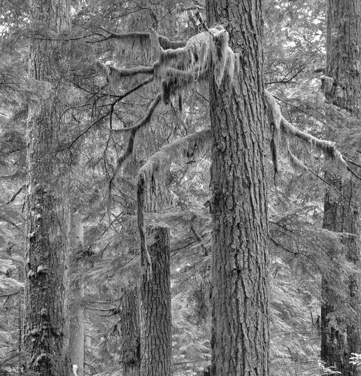

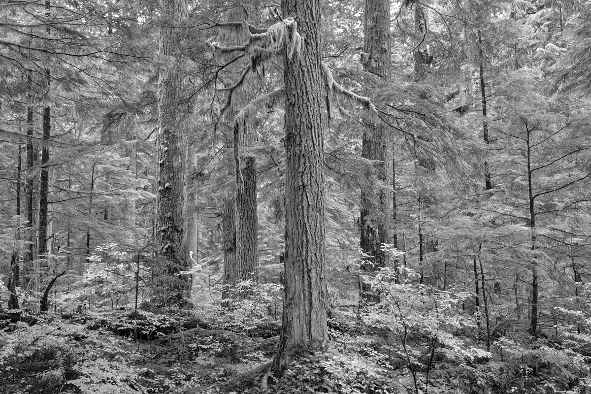

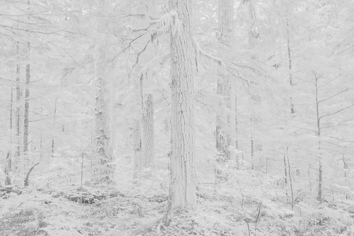

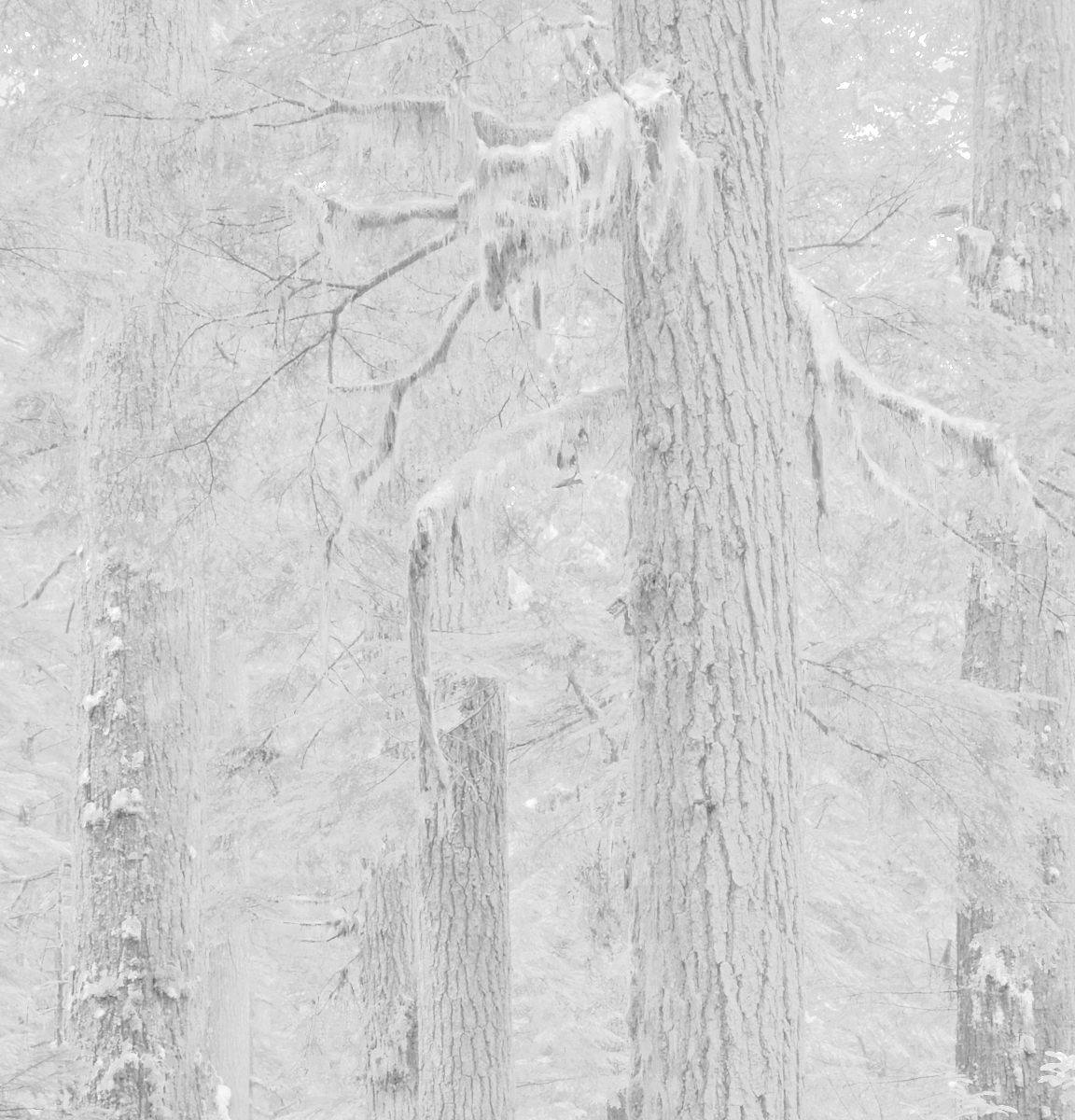

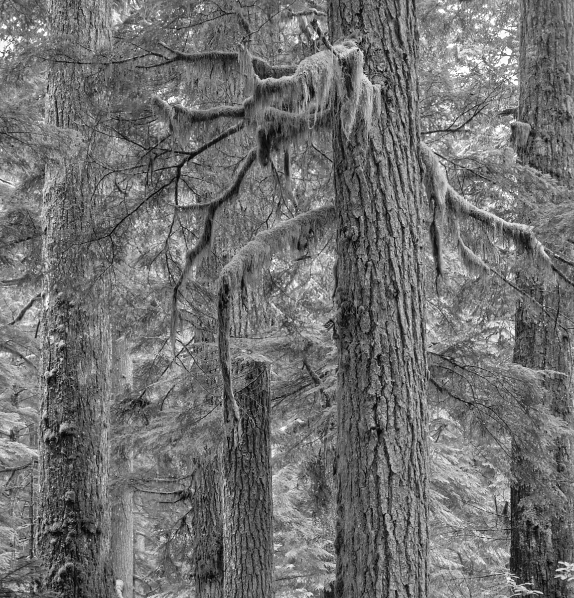

These should better show my issue (the problem is occurring before negative are made)
1) No yellow adjustment, moss RGB 176, Zone VII
2) Same with curve applied...moss has density
3) +50 yellow, moss RGB 198, almost Zone VIII, moss has texture
4) Same with curve applied...moss RGB 255 and blown out but sky 'blobs' stay the same.
I understand and appreciate how using digital colour sliders in B&W mode helps change images. My conundrum is why the yellow is having such a dramatic effect...I thought the whole reason for Luma Curves in Capture One was to change just the luminance, not saturation of colours.
One good thing...making these examples for this thread has taught me to inspect the curve images on screen before making negatives!

Respectfully (and I really mean that!) I beg to differ. The problem is occurring before the negative is even made.
1) The sky 'blobs' (RGB 240 in the positive) stay the same in both examples, coming in at about Zone IX 1/2 when printed. This tells me the top end of things are okay.
2) In the first pair of screenshots above, the moss has texture & density in both the positive and curve applied images.
3) In the second pair of screenshots, the positive one has texture and density in the moss having been raised less than one Zone. When the curve is applied, it gets blown out and reads RGB 255. The moss was raised by less than one Zone in the positive, but resulted in over a two Zone jump in the curve applied image. The sky blobs do not change.
This tells me there is some additive weirdness going on when using colour sliders in B&W mode with Capture One 22, even though I'm using a Luma Curve which (in theory) only affects luminance and not colour.

Yes, I know #4 is gonzo whacky bad, but the Zone IX 1/2 'sky blobs' stayed steady through all examples, and they print as a very light print value in the Argyrotype. The 'sky blobs' have to print as less than pure white because there are a few leaves lower in the photograph I want pure white, and I don't want the sky blobs to be a distraction from them.
I can lower the yellow slider in Capture One's Luma Curve and watch (in the correction curve applied image) in real time as density comes back to the mossy branches. What I'm shooting for here is as close to WYSIWYG as I can get. I don't want to be modifying images after the correction curve has been applied.

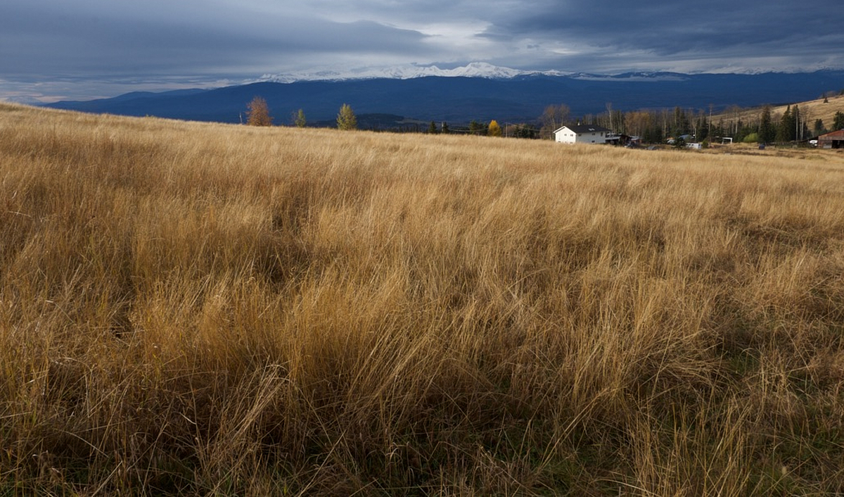

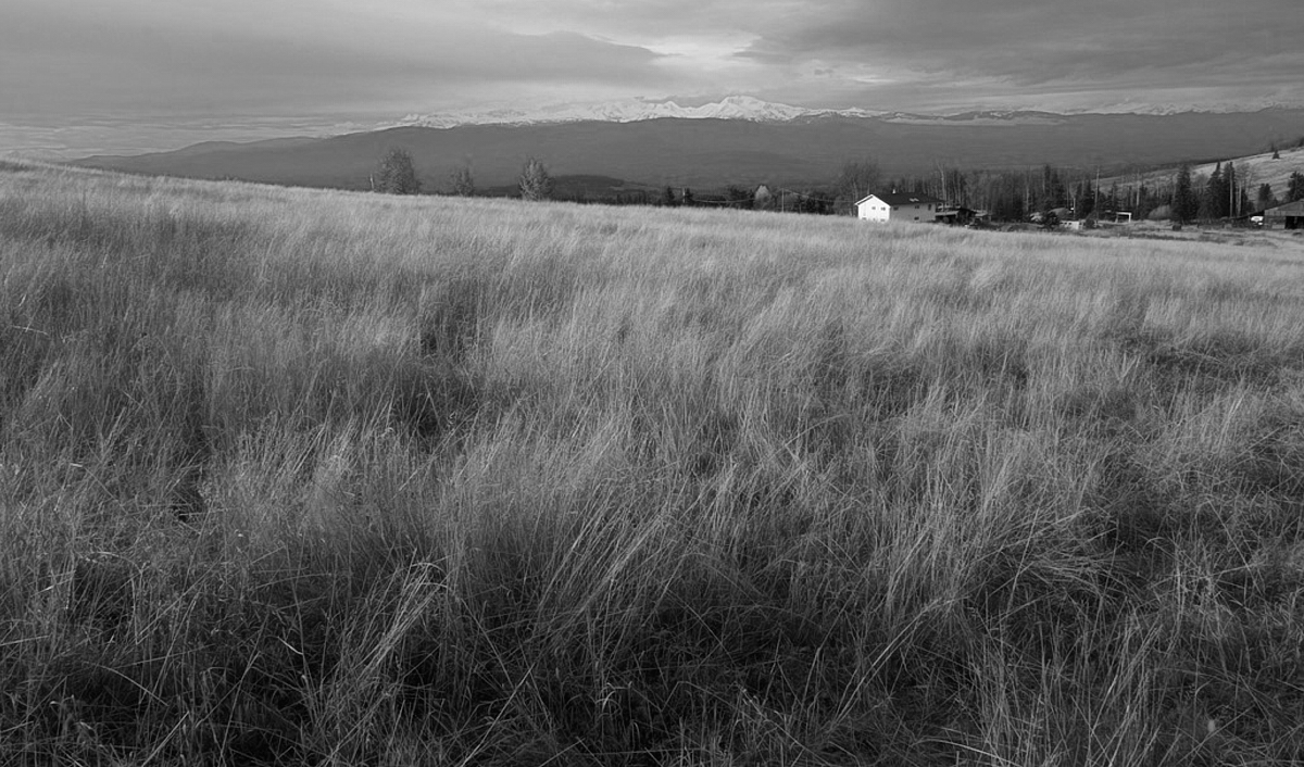

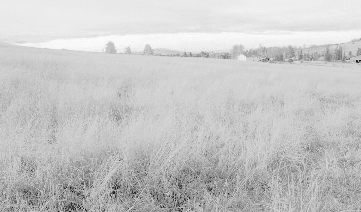

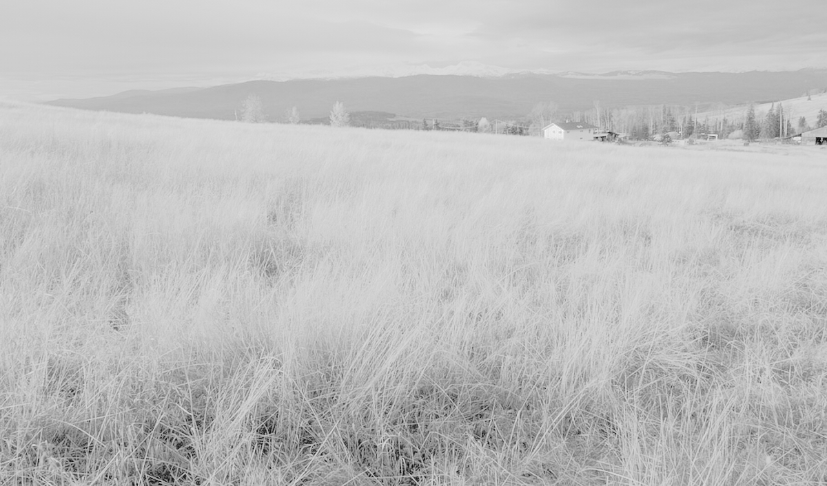

Bit of a test regarding colour sliders and correction curves.
Quick slap dash jpeg.
No editing of original and B&W:
F7913295-ABEC-4609-AB2D-6345232CD0E8_1_105_c.jpg F7913295-ABEC-4609-AB2D-6345232CD0E8_1_105_c 1.jpg
Unedited B&W and with curve applied:
F7913295-ABEC-4609-AB2D-6345232CD0E8_1_105_c 1.jpg F7913295-ABEC-4609-AB2D-6345232CD0E8_1_105_c 2.jpg
Blue slider used to lighten distant mountains and then with curve applied:
F7913295-ABEC-4609-AB2D-6345232CD0E8_1_105_c 3.jpg F7913295-ABEC-4609-AB2D-6345232CD0E8_1_105_c 4.jpg
In the forest photo, the moss RGB values were between Zones VII & VIII and were yellowish in the original photo. This example romps from about Zone III to Zone IX using the blue slider...egad! Worlds away from WYSIWYG.
There are lots of areas in the grass about the same RGB values as the distant mountains yet only the mountains change.
This tells me it's more about the colour slider issue than my curve.
Think I've found a temporary workaround.
Edit in Capture One (CO) using colour sliders to control B&W tones > export out of CO to folder as 16 bit TIFF file:
Export TIFF file back into CO with colour slider edits > apply Argyrotype correction curve:
Looks plausible, with no blown out slider adjusted tones.
Will make a negative and print it in the next couple days.
What you're essentially doing in your workaround is 'flattening' the image before applying the curve. IDK if CaptureOne has a feature that basically flattens or rasterizes the image based on edits that are currently done. I guess not because it's AFAIK aimed at RAW image editing and not DTP or pre-processing applications. I'd personally not use CO for this kind of job to begin with, but rather look towards Photoshop, GIMP or Affinity instead.
