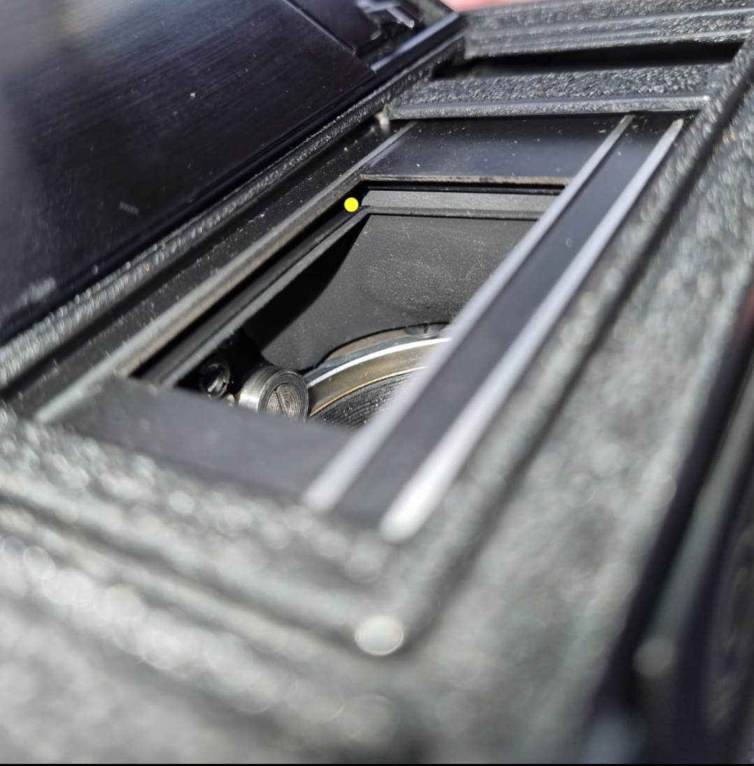

I've attached 2 photos here. The first one depicts the leak, which I was able to identify coming right through the yellow dot I pointed out.

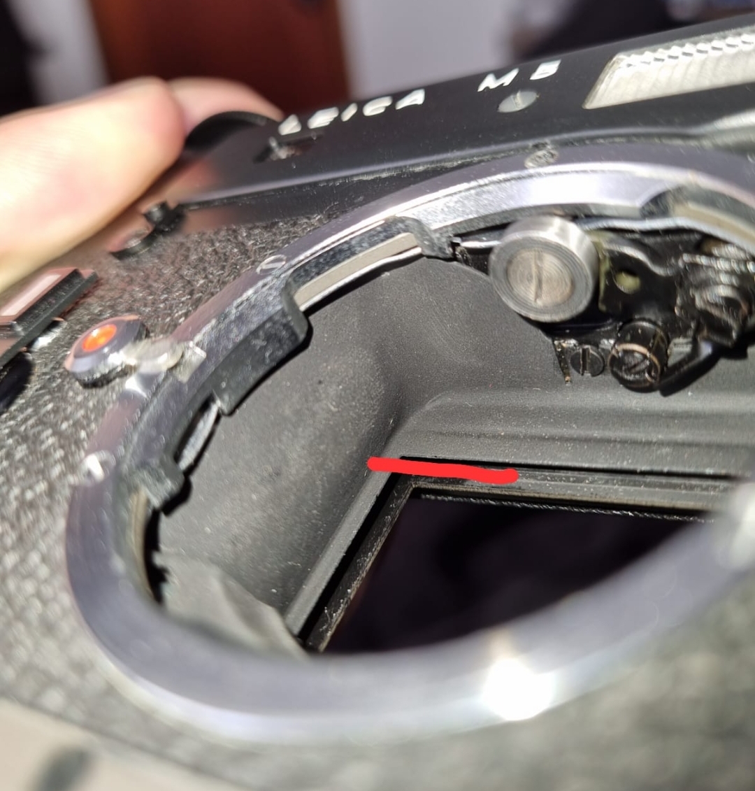

The second photo shows where I'm starting to think where the felt should go, right on the red line I drew. Considering the source of the leak and the felt dimension depicted on the sketch, that's the only place I can think of as of now.
Let me know what you think and thanks for you help!
