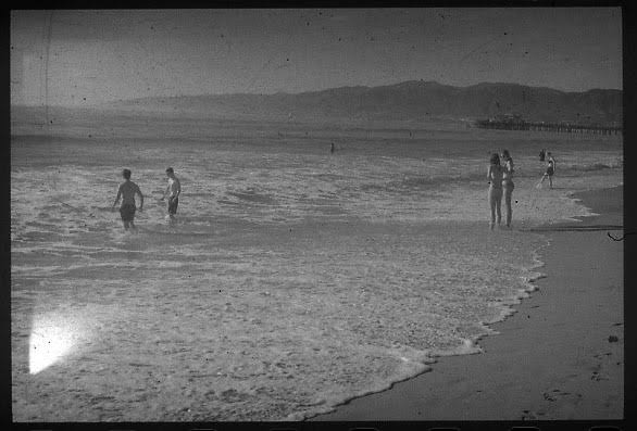

Hello everyone. Guess I'm a little late on the thread but was hoping someone could help me out. I've just noticed this same leak on a few shots of the last roll I shot. I kept staring at that technical note for quite some time and I just can't figure it out! Apparently, some felt (or even gaffer tape) would do the trick, but I wasn't able to figure out where the tape should go. I genuinely tried to understand the "sketch" but really couldn't.
Was someone around here successful on the task? A photo of the job or a better explanation would be great. This issue is really annoying me so any is welcome. Thanks!

I don't have any of my examples here as of now, so I'm uploading one I found on the web (mine looks the exact same). I'm also attaching the "technical note" that I'm trying to decipher! Thx.
