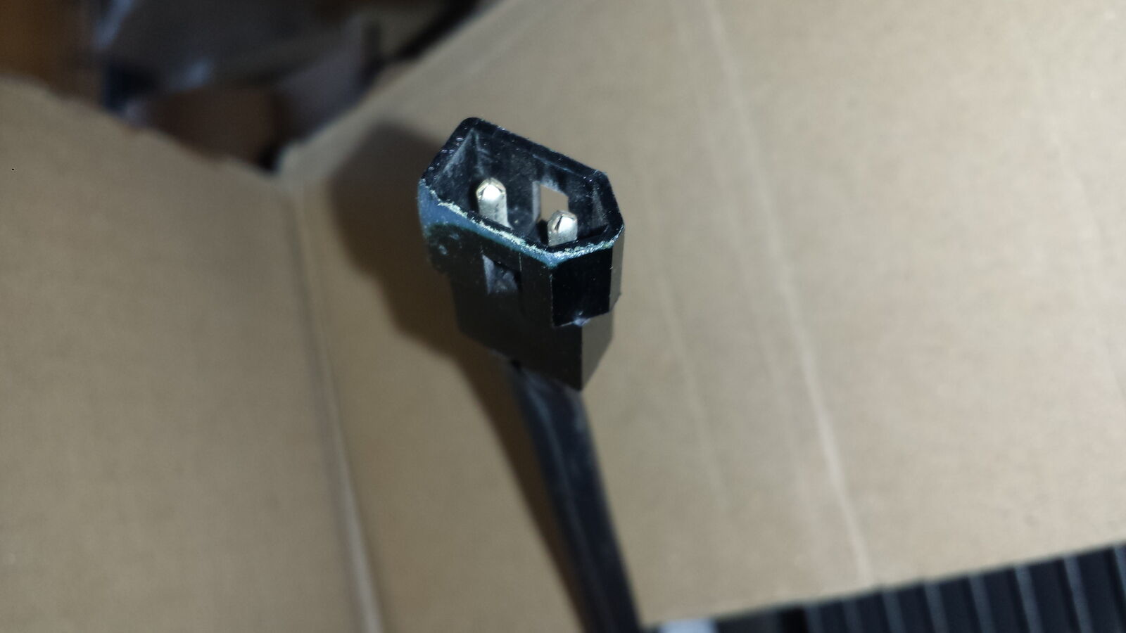

By the way, does anyone know if the original connector from the head looks like this (see photo)?

The 6x7 power supplies made by LPL and sold in the USA by Saunders and Omega used that type of connector.

I can't say for the Kaiser enlargers, but I never came across this model of connector before.
The way the poles are made does not look west-german.
But I found this thread with a Kaiser connector:
https://www.techniker-forum.de/thema/suche-nach-stecker.111667/
A connector I neither have come across....
The connector shown above in my earlier post is not the one from my enlarger head - it was just another one I found that seemed to be original. Of the small sample of machines I have seen, quite a few seems to have been altered in some way with other sorts of connectors, but I am not sure why. The ones on my enlarger looks like an IEC connector type that is used on the RH Designs Stopclock Pro timers, but I have no idea anymore what the technical designation is - possibly IEC C13, male/female connectors.
Thanks, good to know that it might be an official type of connector.

I have never seen a C13 connector applied to low voltage. I assume it is even against the rules as it basically allows to feed mains voltage into a low voltage circuit.
Maybe you mix it up with the one I linked to.

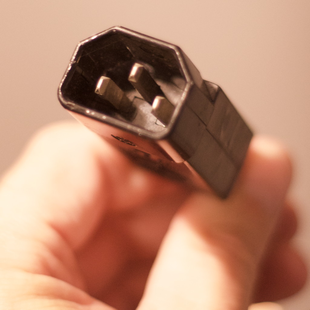

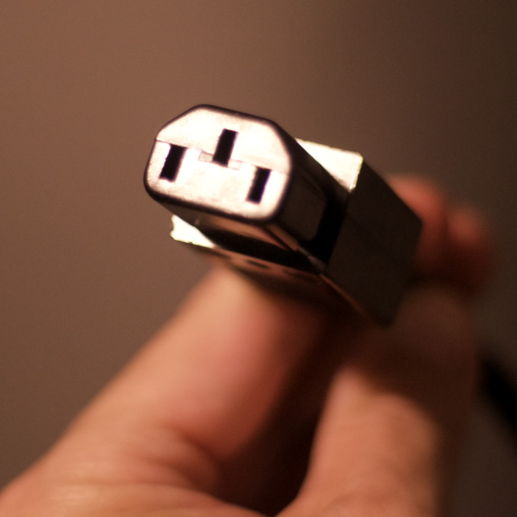

@AgX , I am not going to dispute your comment about the useability of a C13 plug combination, but this is what I have on the other end of the transformer, going into the LPL ... (see photos) - I do think this is C13? But as said before I am not even close to being an electrician. :D
