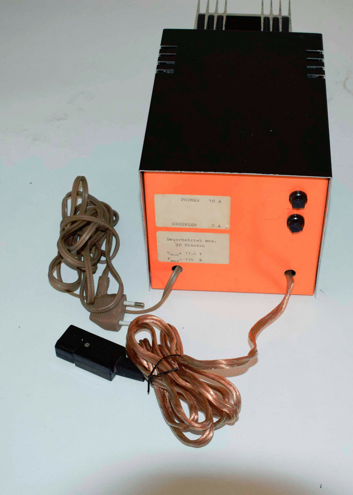

The reason I am wondering is that I may have to source another transformer for the LPL 7700 colour enlarger. If they still are in business, does anyone know of a european supplier?
I just got it, tried it out with the transformer and nothing happens - it struck me, that even if the bulb is burnt, shouldn't the small lights for the Dichroic filtration work?
EDIT: I was a bit sloppy in the wording above - the enlarger does not come with an original transformer. The transformer supplied has no on/off switch and it is likely custom built. It has two fuses, one 10 A (primary) and one 2 A (secondary). As far as I can ascertain checking it today, the 10 A fuse seems blown (I am approaching the limits of my electronic knowledge here), while the secondary seems fine. The 10 A is a ceramic fuse while the 2 A has a glass encasing if that matters.
On it (see photo) there is a sticker that says (I guess) that the output ("Uaus") is 11.4 V, while max ("Pmax") is 114 W.

The LPL power supply sold in the USA contains a transformer (line voltage to 12 VAC), a switch, and the connector to the enlarger cord. The only two things likely to fail are the switch and the connector. If you have a voltmeter, you can check for output voltage at the connector--if there is none, you could try to short the switch (do so with the mains disconnected) to see if the switch has failed.
If the switch has failed, and you short it out, you can turn the enlarger on and off with a darkroom timer.
If the connector has failed, you could replace it with a suitable connection method. I plan to change my connector on the power supply for mine with a barrier terminal strip, as I do not care for the connector that LPL used for an 8 Amp load.

As for the fuse, I think it is named "Feinsicherung" locally, but where to find these? I assume they should be for 12 V, 10 A? Or is it 220 V, 10 A since it goes into the box?

The KHB Fototografix web site has an image of the 7700 power supply--the one for US/Canada voltage (120 Mains) shows no fuse, consistent with the supply I have; the one for 220 V mains (Europe) has a fuse, and it is listed at 1A (as shown on the front image of the power supply). This is consistent with having the fuse on the mains supply voltage side of the transformer rather than on the secondary (12V) side. Usually this type of fuse is a 5 x 20 mm glass cartridge fuse. It should be readily available at any electronics store or even, perhaps, an automobile parts store. It might be a "slow-blow" type.
These are likely of the type "glasstube fuse"
https://www.google.de/search?q=glas...2r_jAhWRy6QKHU_EBVYQ_AUIESgB&biw=1024&bih=546
Typical dimensions are 5x20mm, max. current and sensitivity vary though.
12V or 220V, it doesn't matter, as they stand both...
Get exactly the type indicated on the casing (otherwise, as you find installed).
You find them at any electronics dealer, some versions even at a DIY store.

I should mention that fuses are generally rated for a maximum voltage, and any lower voltage is OK--the maximum voltage is based on dielectric strength (breakdown because of voltage) and insulation resistance. Most glass cartridge fuses are rated for 250 V max, so it really is the current rating that is important to match.

Thanks! I'll see what I can source locally at first. The 10 A fuse had the metal cap fall off on one side, underneath it is brown (possibly from corrosion) - the 2 A looks fine, but I'll change out both.
