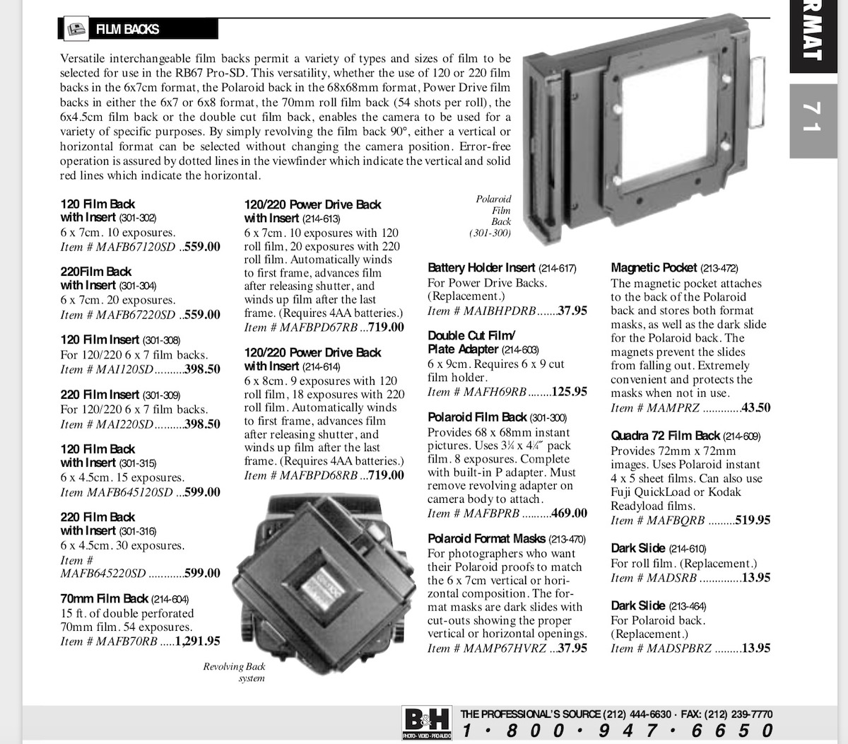

Aha, an answerable question! I have a pdf of the B&H Pro Photo Sourcebook from 1998 - actually, if you search for this, you may still be able to download it from their site. A replacement RB67 darkslide cost just $14 in 1998 USD - less than I was expecting. But to put it in perspective, a complete 120 or 220 back cost $559 new, and the 70mm back was an astounding $1292. Inflation is about a factor of 1.9 since then, so if a 120 back feels a bit pricey at $100-150 now, it's still 10-15% of the original cost.
