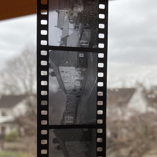

Foma films in 35mm don't have a clear base but *do* reverse very well. Foma 120 films have a clear base. This is Fomapan 400 reversed in 35mm:
