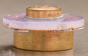

Jon Goodman sells the adapters that allow you yo use 675 zinc air hearing aid batteries for a very reasonable price. Those batteries don't last particularly long, but they are readily available locally, and can be obtained very cheaply.
I have a link where I purchased an adapter to use a lithium CR1632 in place of a PX640, and received one from the same person for 2xPX625. I don't think he's offered one for a single PX625, but you could email him and ask.
The really useful bit (for those with some tools and the need) of the above linked thread is this file: https://www.photrio.com/forum/attachments/batt-adapt-us-pdf.213739/ which includes information on making your own Schottky regulated adapter to use a 675 silver oxide (preferred, for lifetime and voltage curve) or alkaline cell in place of a PX625 mercury cell. Looks like an hour or two of work, plus a couple days waiting for the original 625 size alkaline cell to discharge, but the adapter created ought to outlast the worker who builds it, with a little care in handling.

I use same ones, purchased in last 2 months, well made and work great. This is probably cheapest option on the market for a finished product. They use SR43 batteries, so not as large as SR44, but do what they need to do.
So Russians still have them, but adapters from Thailand are about same price, slightly higher, and then you go with widely available silver oxide batteries.

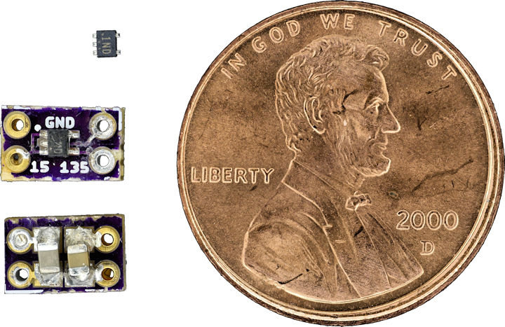

With the advent of micro electronics there would never be a need for mercury cells for photography equipment. Maybe people are not understanding but the device Donald linked to in post #3 uses a mini voltage regulator (not a diode or zinc cell) to give a perfect 1.35 volts from a 3V lithium cell. So the solid state voltage regulator and the lithium battery fit in the same package size as the original mercury cell.
The maker of the cell above does not tell what voltage regulator device he uses but one possibility is the tiny Toshiba TCR2EE which is shown here attached to a PC project board that one can get on-line.
