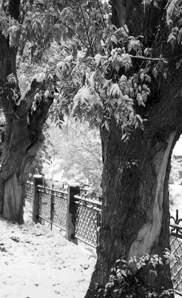

I used 2 mentioned here in answers cameras: Voigtlander Bessa II & Moscow-5.
The price difference is 4X, but the quality is slightly differed.
I sold Bessa, just to reduce my collection.
Bessa shot example:
Bigger negavtive = better IQ (if all other factors = equal).
