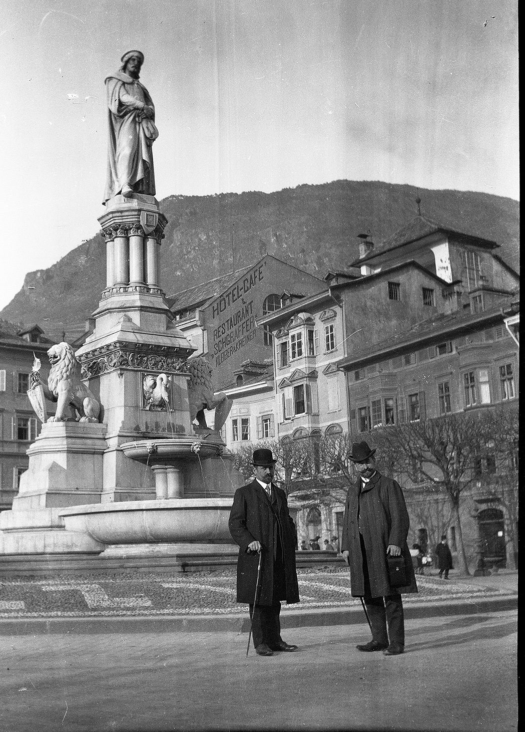

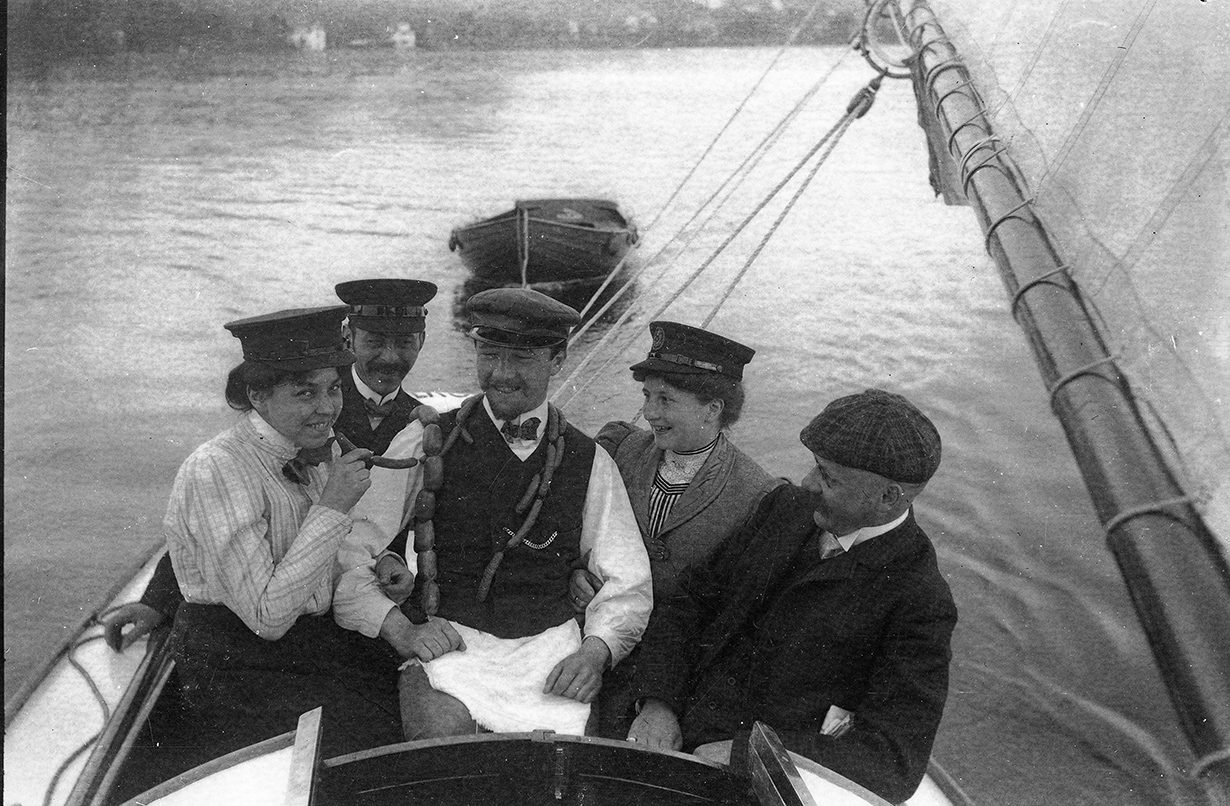

I have done many glass plate scans here, I don't do preservation work myself at all. The Historical Society has me scan and print all this old stuff PRIOR to preservation just so they have a record in case something does go wrong in that preservation process. I have seen slight "yellowing" caused by colloidal oxidation many times, but these totally yellow negatives are a mystery to them as well as to me.
Those look wonderful. Is there any chance we could see the positive images please? If they are too big you could either resize them or host them on Flickr (for instance) and link to them.
I will try to post some reduced size versions here for you.
Great quality I would like to state - let me ask : It looks like 13cm x18cm from format of the plates (somewhere in this size? )
with regards
They actually measure 8cm x 10.4cm. I have no idea what camera made them at this time either. One clue can be found in the picture of the two men by the statue in Bolzen, Austria. The man on the right is carrying a camera case that looks like it may hold an Agfa Folding camera, or maybe a Kodak Folder from the period.
Those are fantastic. Thank you. Bözen/Bolzano is in the Süd-Tyrol. Now part of Italy but was Austrian until 1919. I’ve been there quite a few times.
